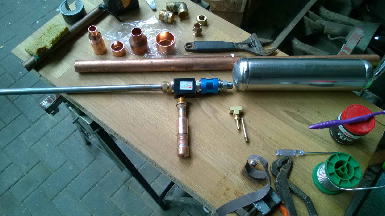

I currently have made an airgun, just a basic air tank - slide valve - QEV - barrel, with a small cylinder the approx volume of barrel and space in QEV.
It is not fully assembled but gives an idea of what I am using. Being such a beginner at all this I have a question for all the knowlegable amongst you, I plan on a Mk2 using a better QEV and was planing on using a button valve/blow gun to actuate the QEV,, my question is, do I still NEED a second cylinder coming from the QEV and is there any bemnefit /disadvantage? or do I just blank this port.

If a were to build a gun and have the full sized compressed air tank connected up to where I currently have the single shot tank, and then use a blow gun type trigger in place of the slide valve, will once the QEV starts to equalize and dump out the air will it empty the tank or will it stop once I remove my finger from the blow valve?
When filling from pilot side of ANY piston valve as soon as you release the trigger (close the vent) the in-coming air should close the piston re-sealing the storage / supply chamber.
