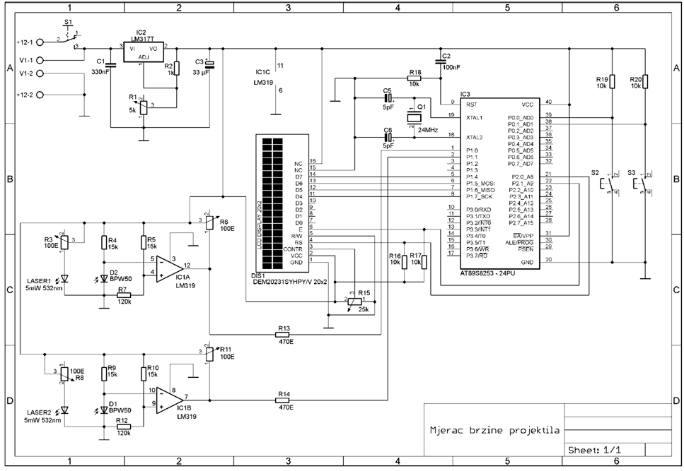

For the project I chose AT89S8253 microcontroller since thats what we mostly used at school. Its running at 24MHz which gives me a time measurement resolution of 500ns. When the laser is directed onto the sensor, the photodiode output voltage is only about .4V which is not enough to set the microcontroller input to "1" so I had to use a LM319N high speed voltage comparator in a basic photo detector circuit. On its output I can get 3.5V when the laser is on the photodiode, and 0.8V when the laser beam is broken. This is just within specs for the AT89S8253 logic "0" and "1" voltage levels. It enabled me to program the microcontroller to check only two ports for the time measurement. Once the first laser beam is brkoen, the microcontroller starts a timer. When the second laser beam is broken, it stops the timer. Then it automatically calculates the speed v=0.3/t (sensors are .3m apart). After that it freezes the result for 1 sec so anything flying behind the projectile won't break the first laser beam and restart the measuring sequence, erasing the previous result. After that 1 sec the measurement can be repeated or the result can be displayed in fps or km/h. Power source is a Leoch hermetically sealed 12V lead acid battery regulated down to 5V with a LM317 voltage regulator.

The electrical schematic is in the attachment. Good luck ;)
