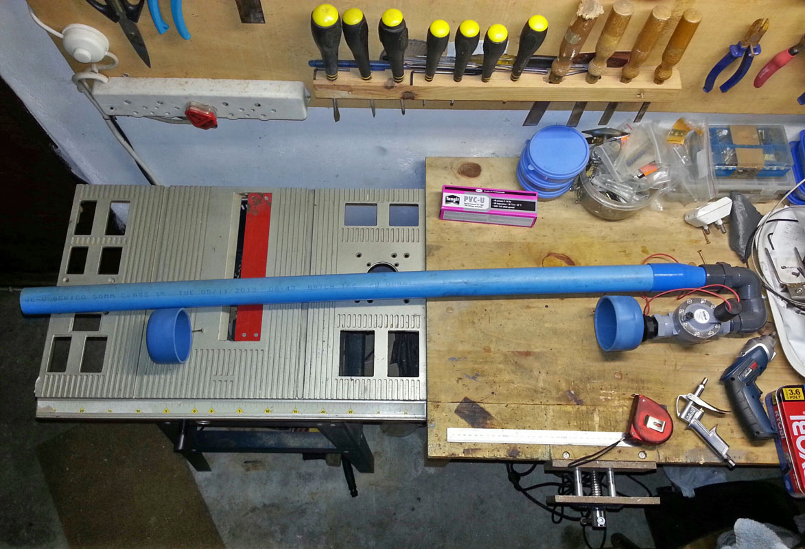

This project is long overdue, but better late than never. This is my first potato gun so I'm going to need lots of input from you guys.
I need to play with barrel length, chamber size, various pressures, etc to get as much range out of this thing since I want to develop a cannon to launch a shark bait around 250 - 300 yards into the ocean...

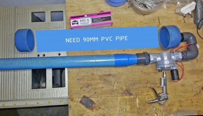

I went shopping this morning and I nearly have everything I need (I just need a section of 90mm pipe to complete the chamber).
The plan is to start with a 40" chamber which will fit perfectly with a 47" off-cut piece I already have for the barrel. All components are rated higher than 150psi so from a safety point it seems alright to operate at aound 100psi, right? From there I will start changing it up and spreadsheet everything as I go...
2" Pnuematic Cannon Build
ok so I managed to get some pipe for the tank, but they were out of stock on 90mm pipe so I upgraded to a 110mm tank.

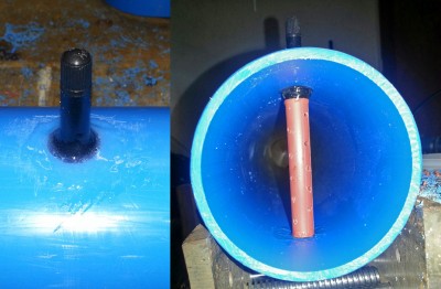

I looked around for good quality tire valves, but couldn't find bolt in ones anywhere. I guess I'm just going to make a cheapy work...
This is what I came up with, don't know if it's gonna hold :/

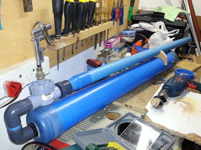

Looking good, with a chamber that size it's going to have one heck of a "whoomph" but it will take a bit of time to fill.

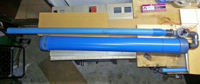

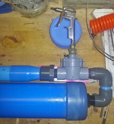

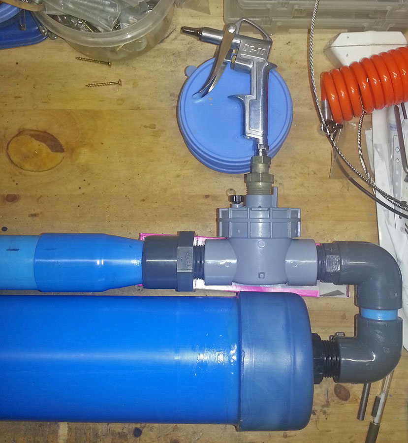

Assembly complete. Pressure testing tomorrow night. Hopefully fire my first slug out of my first gun this weekend...

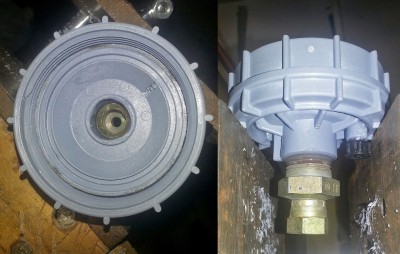

Here's a closeup of the valve and some of the hardware. I forgot to unscrew the constrictive tip from the blower nozzle before taking the photo, but you get the idea. I just hope that valve still works, I gave it quite a bit of hard loving!
B.T.W. Will those screw threads seal tight enough or do I have to glue them as well...?

Assuming you have Sch40 or Sch80 PVC then I believe that your max pressure should be about 150 PSI (with the sprinkler valve), you can safely take it to about 100-120PSI.
Whatever the mind can conceive and believe, it can achieve
Here in South Africa we use Bar for pressure (1Bar ~ 15psi)~NooooooB~ wrote:Very nice looking! Quite solid too
My chamber uses Class 12 PVC which means it's rated for 12 Bar (~180psi). My Sprinkler Valve is rated for 8 Bar continuous use (~120psi) and I'm not really planning on using it over 7 Bar (100psi), just to be on the safe side...
