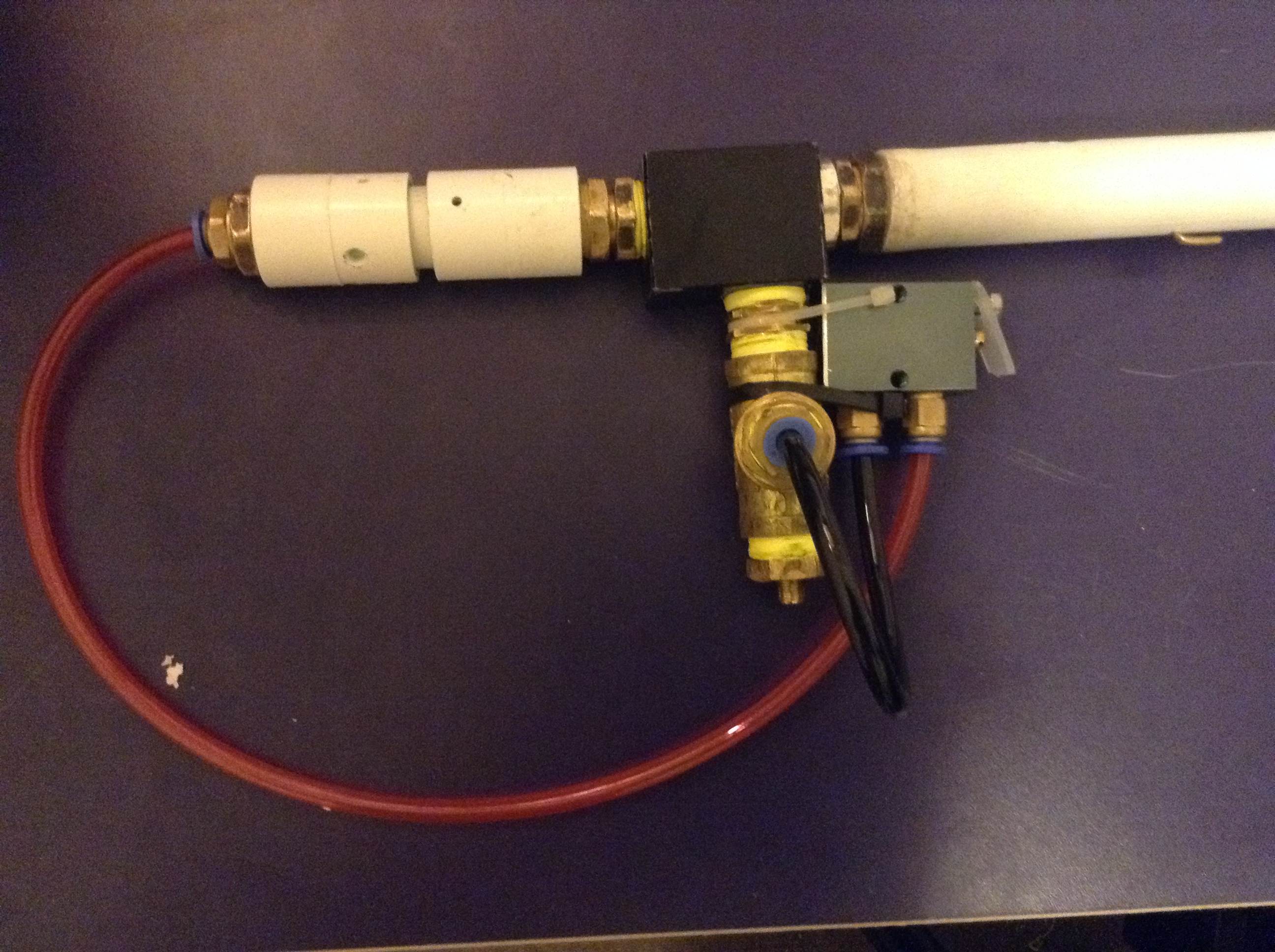

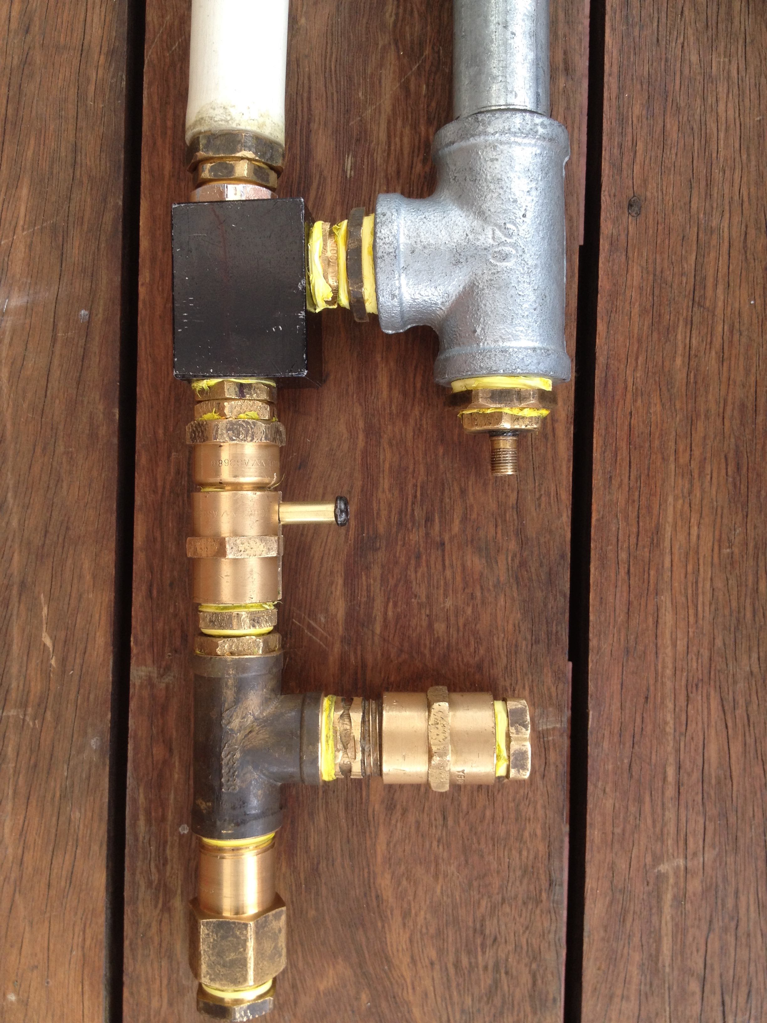

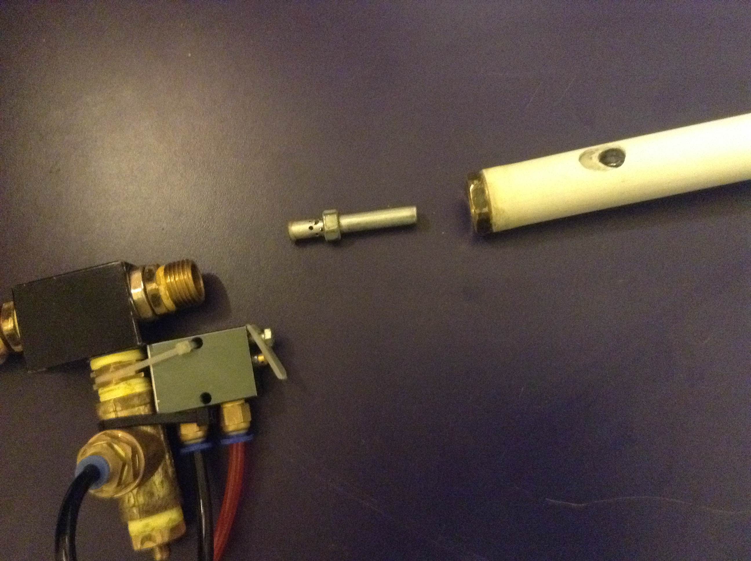

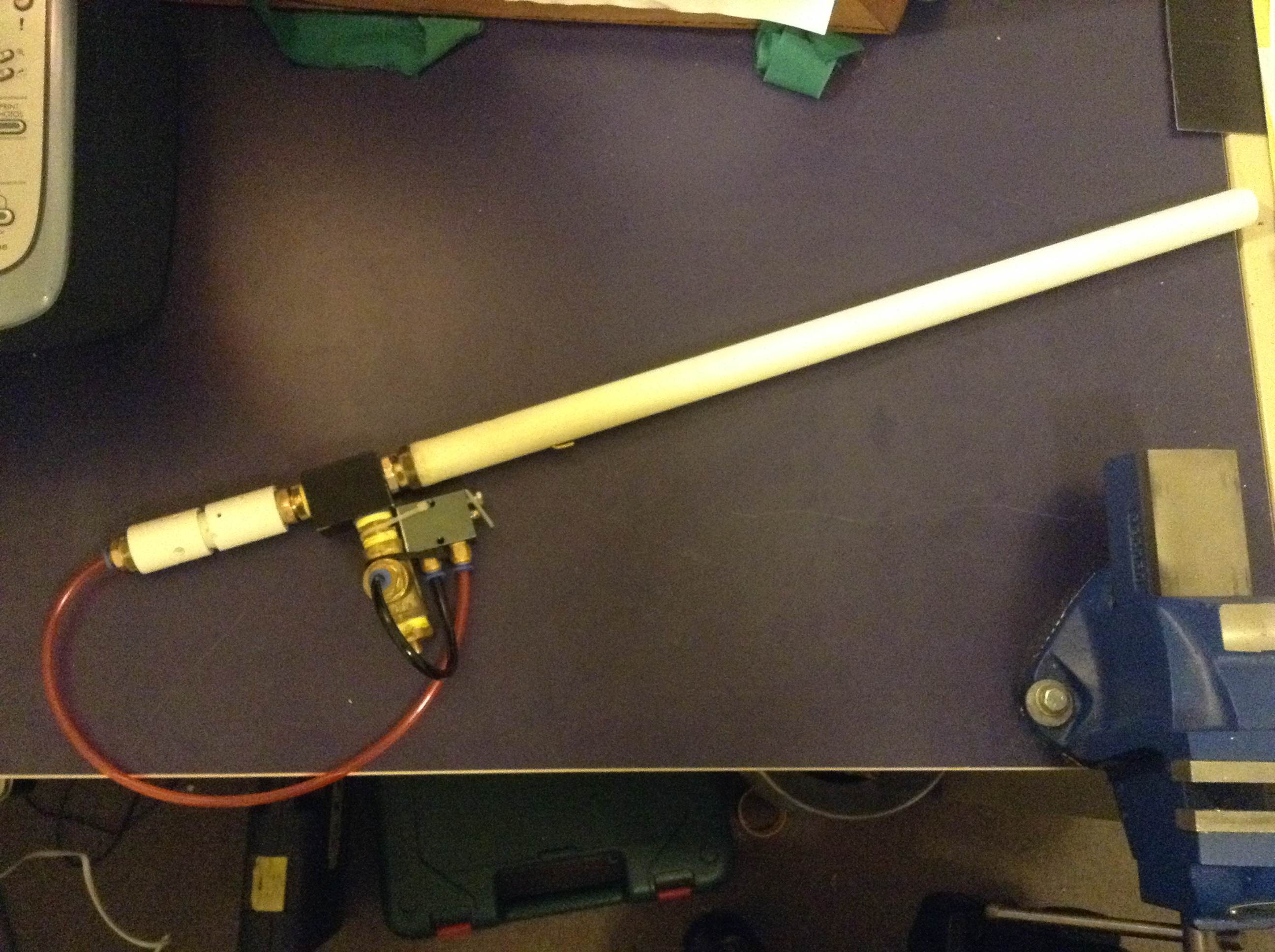

My goal was to make a workable cannon that could be made almost entirely from stock off the shelf parts. Also minimum tools and quick to assemble. (I have a decent amount of tools - no lathe / mill sadly, but working on it - but wanted something simple to start). My other prerequisites were an easy break trigger that didn't overly affect firing and shock pump filling / pressures.
The end result is a multi pump (20 strokes of shock pump :/ ) single that fires 8mm steel balls fairly straight and hard.

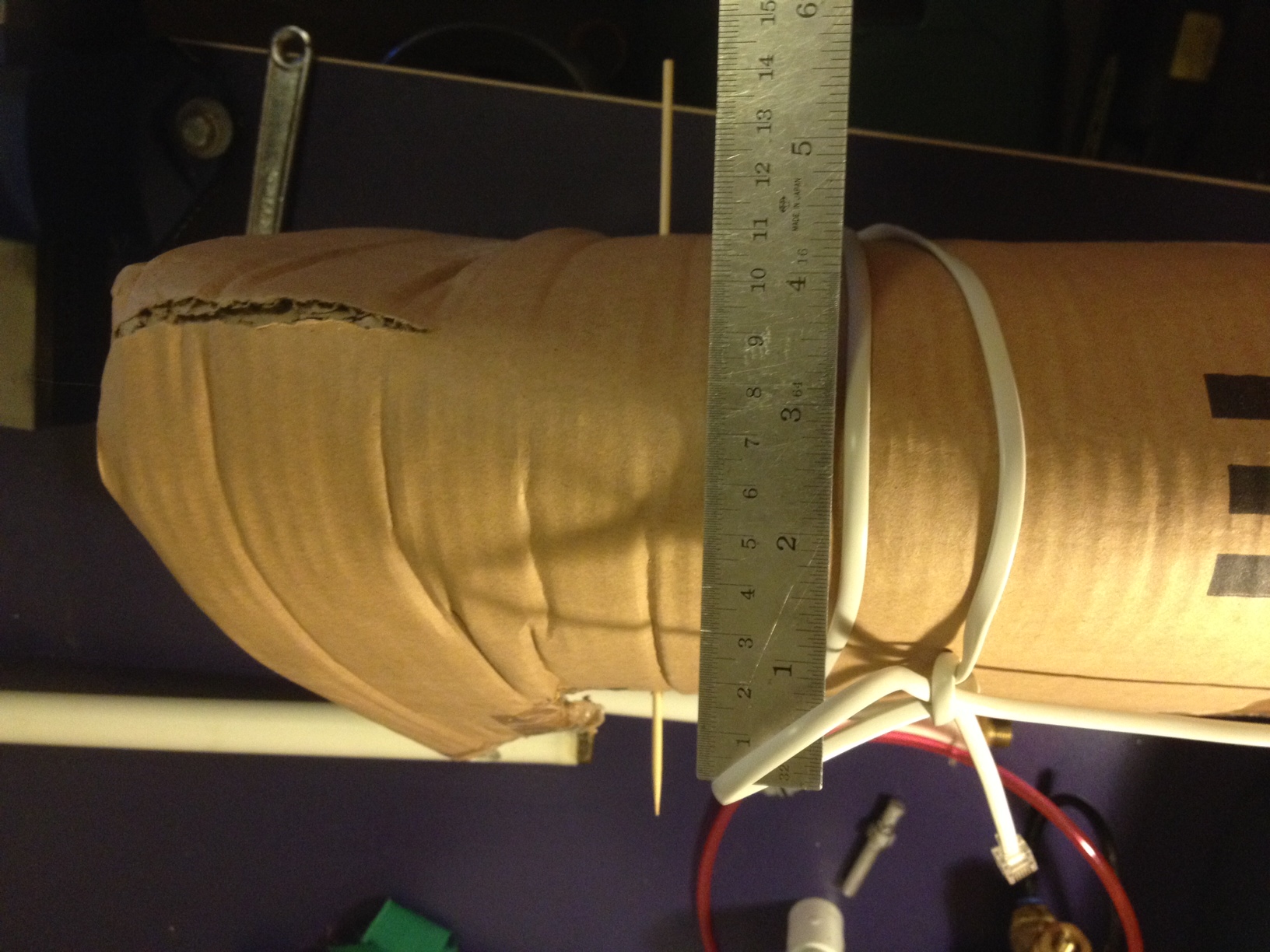

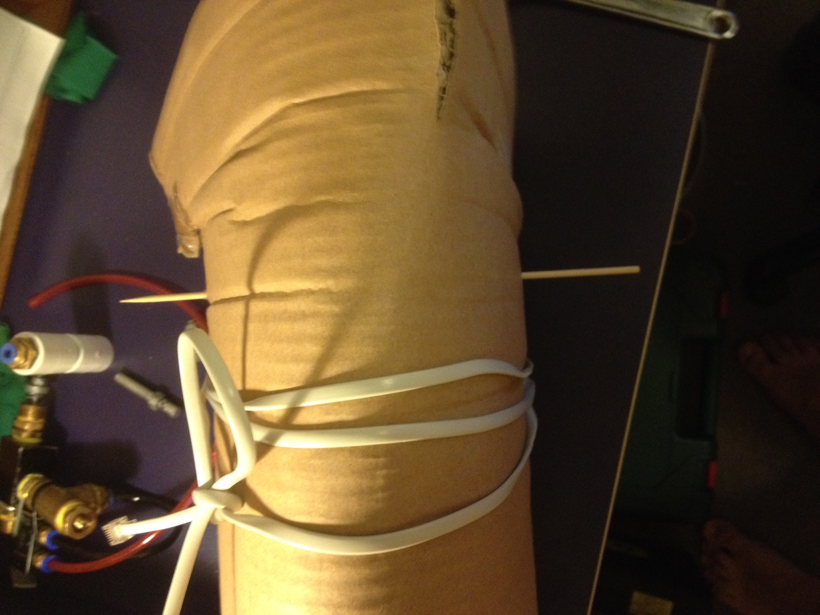

No damage pics At the moment, but it will put a ball through about +15 layers of standard 5mm cardboard from 5m. (At 250psi).

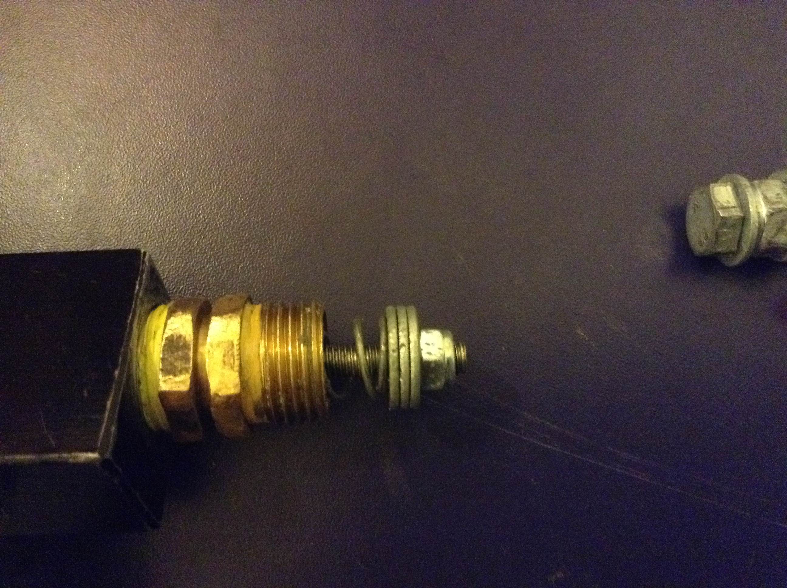

The DCV is held on with zip ties until I figure out a better method.
I don't think anything on the gun is especially innovative, it's a commercial qev piloted by a large hammer valve, the hammer is driven by the chamber so pressures rise equally. The valve surface area is smaller than the hammer surface area therefore it always opens regardless of pressure change. At the moment they are two separate things ( hammer and valve ) I couldn't find a long enough bolt to make them one piece but that's the plan once I get to the shops. Either way it works pretty well right now.

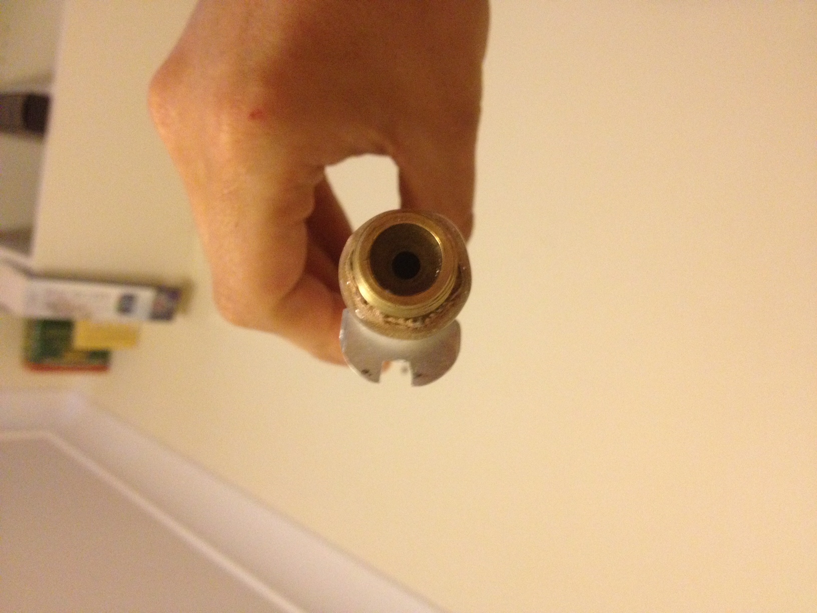

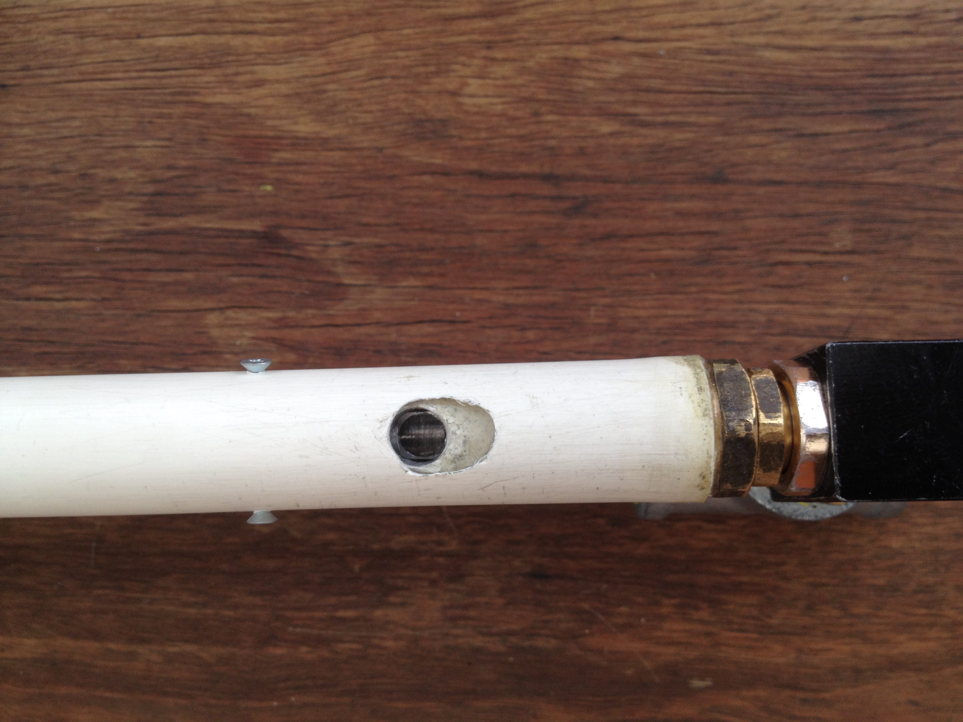

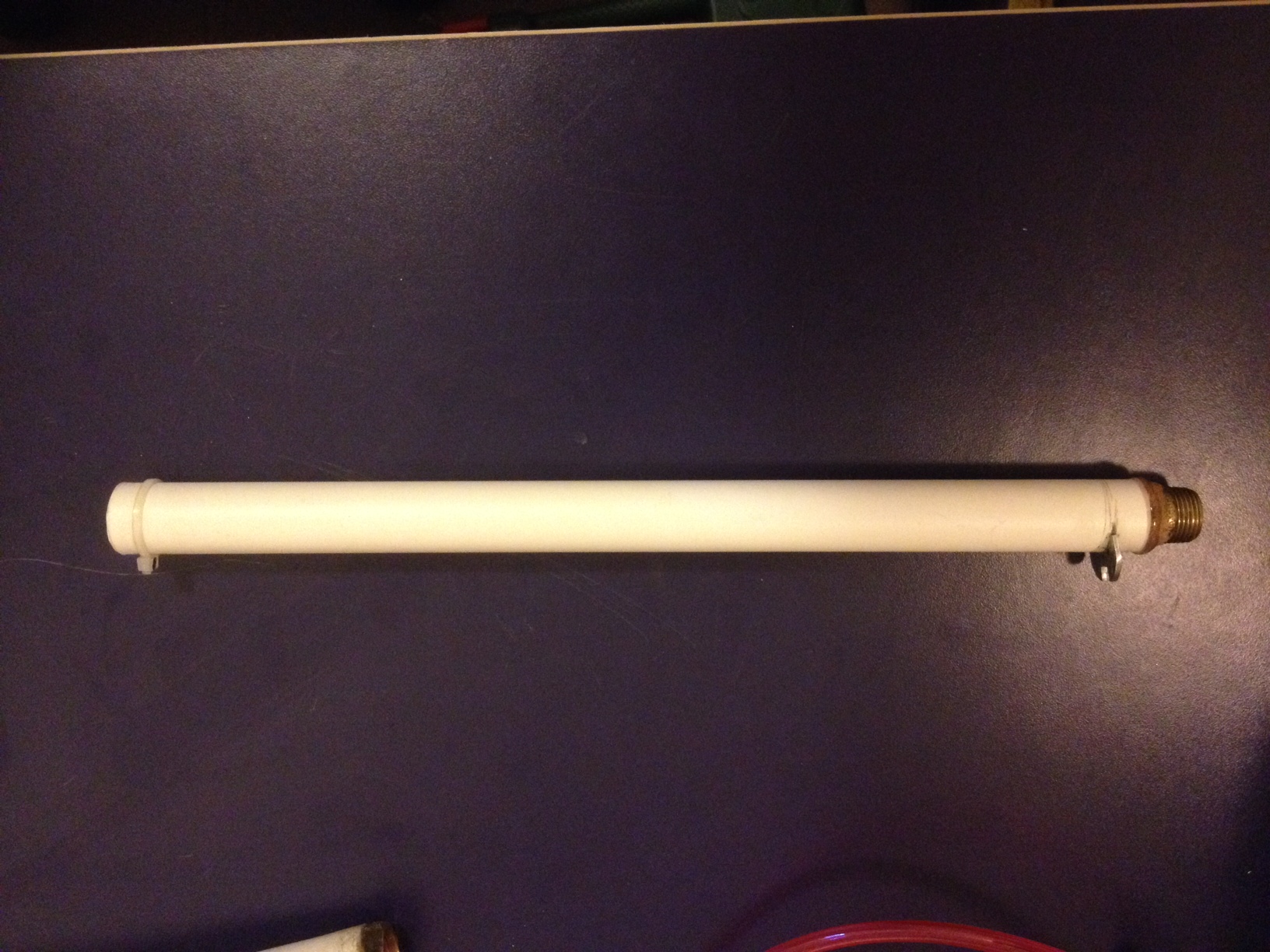

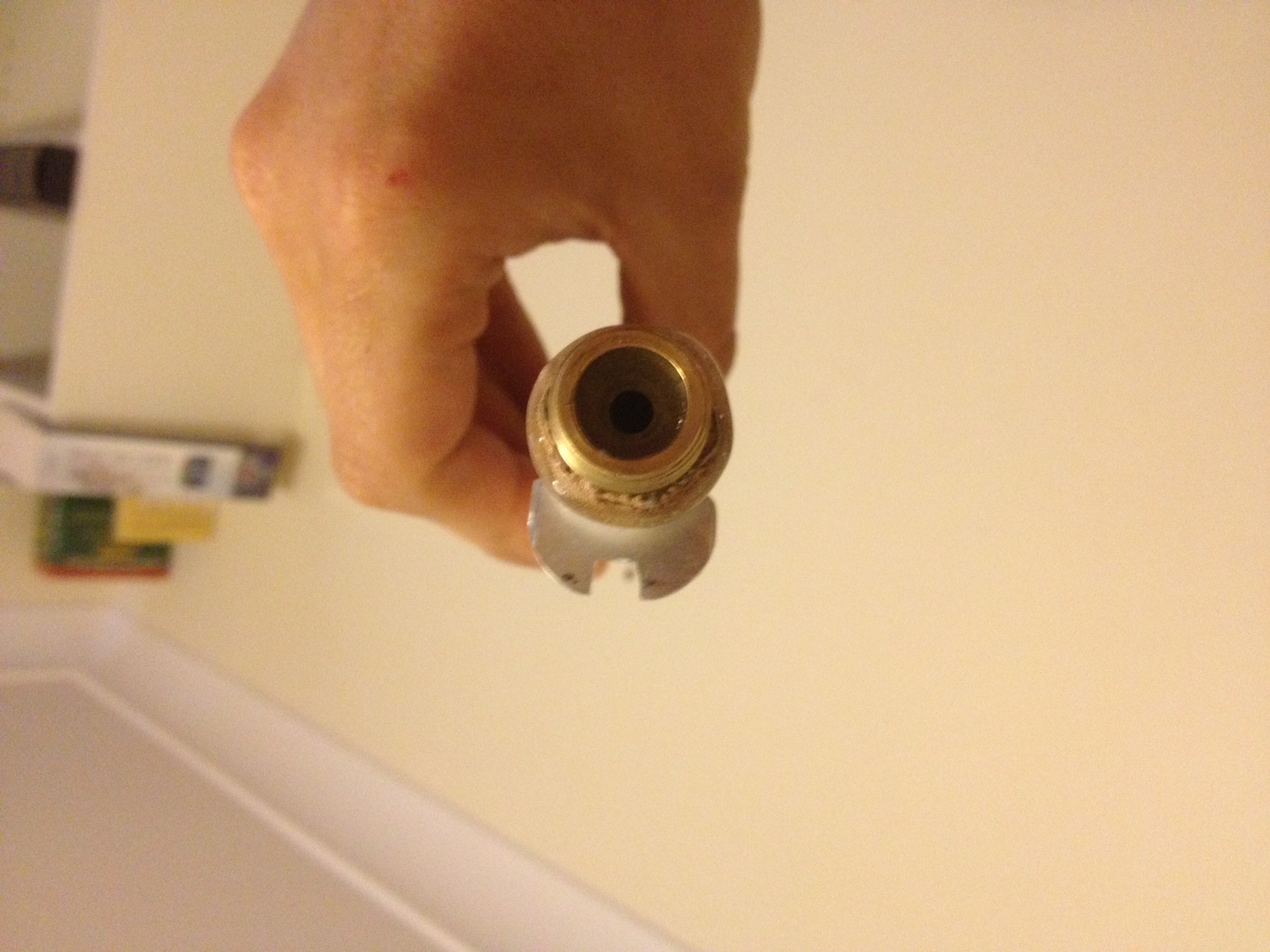

The shroud acts as a very effective silencer but has a fairly random design, there is no porting in the end of the barrel there is just a gap between the end of the barrel ant the most distal baffle.
The bolt is non spring loaded blow forward.
There is no detente but a small magnet embedded in the epoxy near the breach holds balls in place.

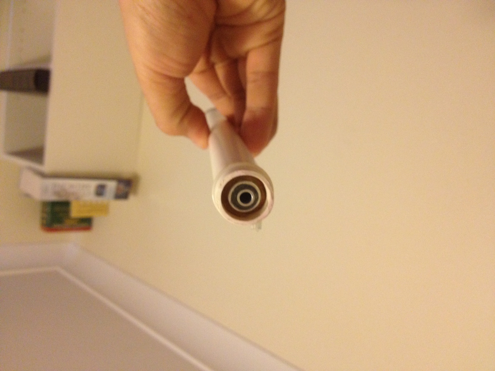

I finished a .177 barrel last night I think the chamber is too big for it but it has poke!
Put a standard air rifle pellet through my cardboard target into the side of my desk (skewer was shoved through make the hole more obvious).
It's a stainless steel tube that I found in the hobby shop sleeved in a few layers of larger pipe and set in epoxy. (I was originally making the shroud the size of the inner tube you can see in the photo but it was flimsy still so I chucked on the PVC. I load it through the back, have to unscrew each time, but it works for now.
Don't know why some of these are upside down... they are right on my computer

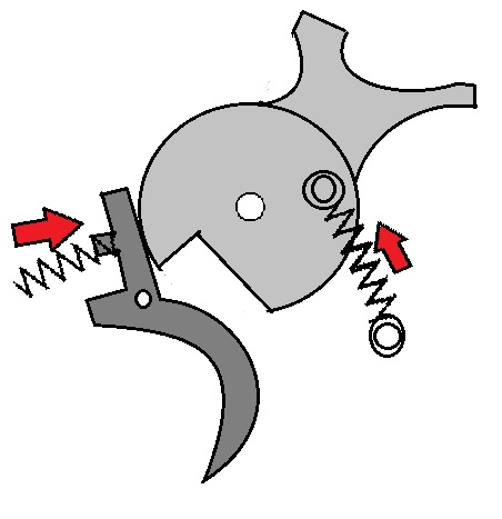

A basic single action hammer mechanism is pretty easy to make.
Think of a pizza with a quarter cut out rotating on a centre axle.
The cut-out is where it is blocked by a pin that cab rotate out of the way.
But then hammer weight and spring force come in..to decide on power, consistency and shot count...

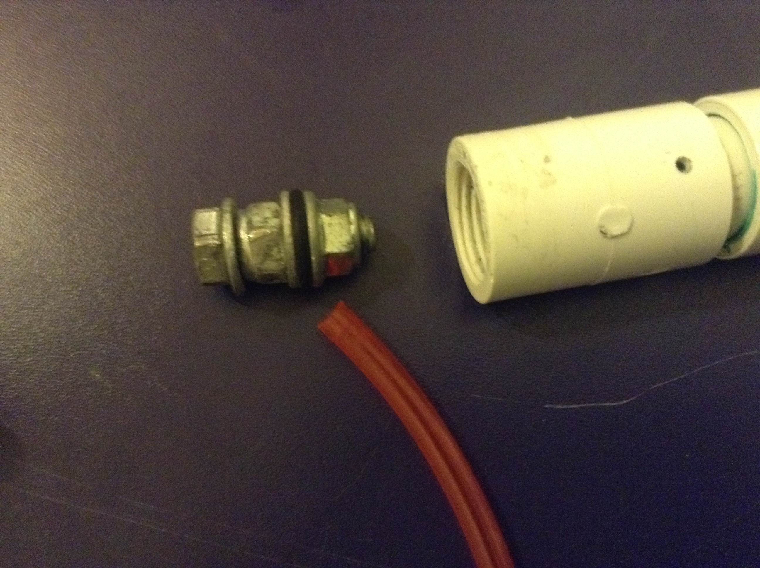

I've updated the hammer-valve pilot to be a modified Schrader valve that seals with almost no dead space against the piston space on the QEV - I'll post some pictures when I get a chance.
The Schrader actually works amazingly well and is super easy to actuate (I can make it cycle just by flicking it with my finger even at 600psi - fridge compressor is online!)

Something like this..?
- basicSAhammer.jpg (33.46 KiB) Viewed 5012 times

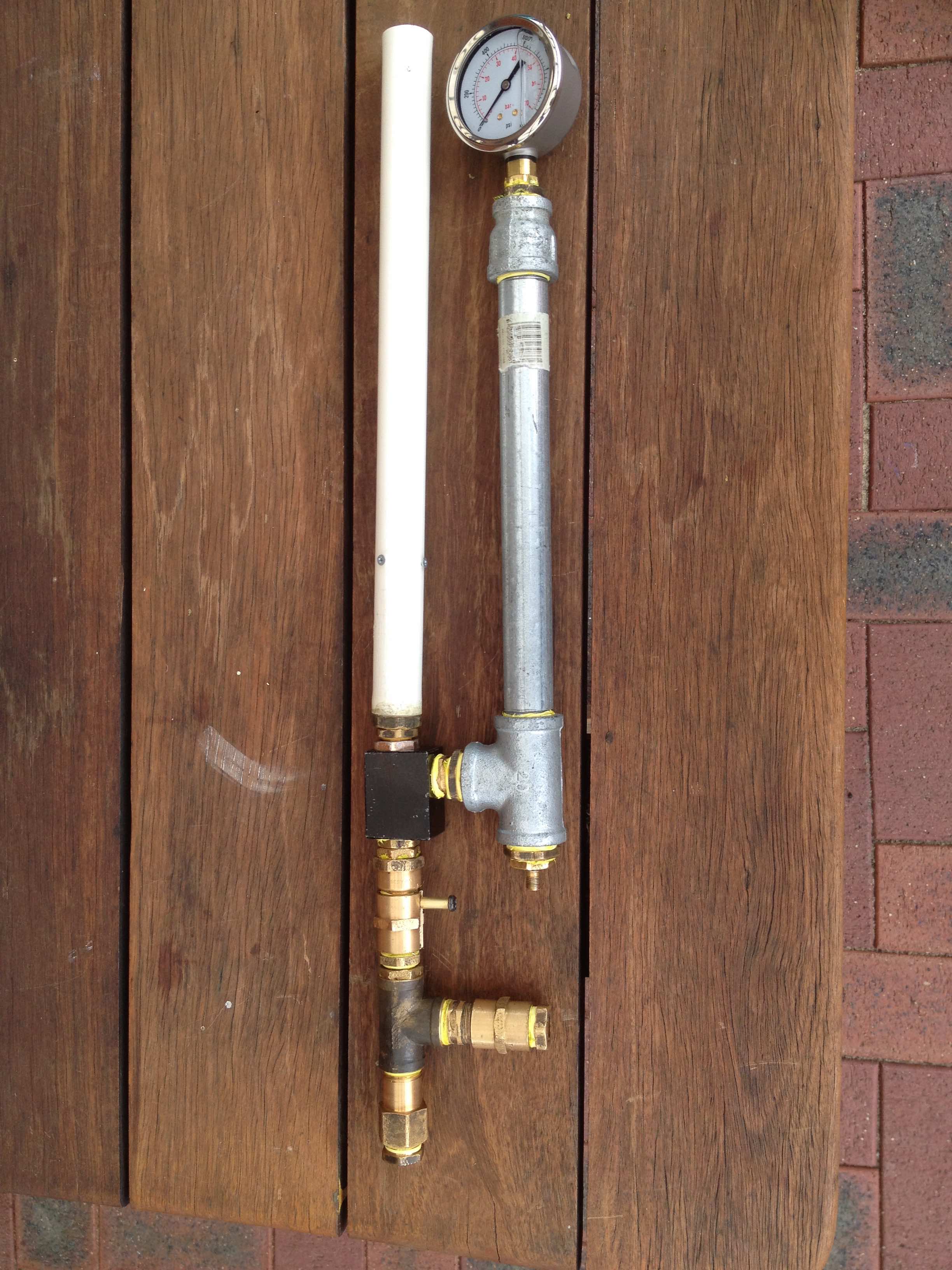

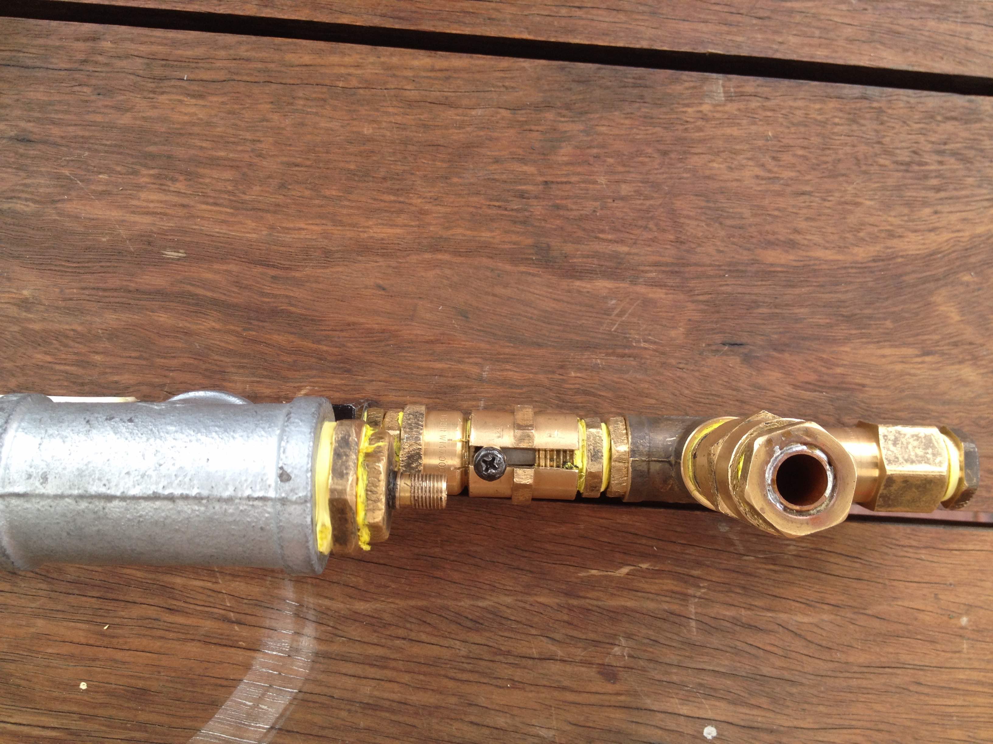

Finally after long long hours of fiddling around with hammers triggers and 50000 other things I gave up on the double action revolver style trigger and made an inline zip gun style trigger that is absolutely spot on!
The pilot valve is a Schrader valve with a bit of the collar cut off to expose the centre pin. The hammer is a ~10cm piece of steel rod with a spring behind it. The (sort of) trigger is just a bolt in the rod with a bit of brass tube around it that allows the "trigger" to be pulled back against the spring and "flip" off your finger giving a quick break / acceleration of the hammer.

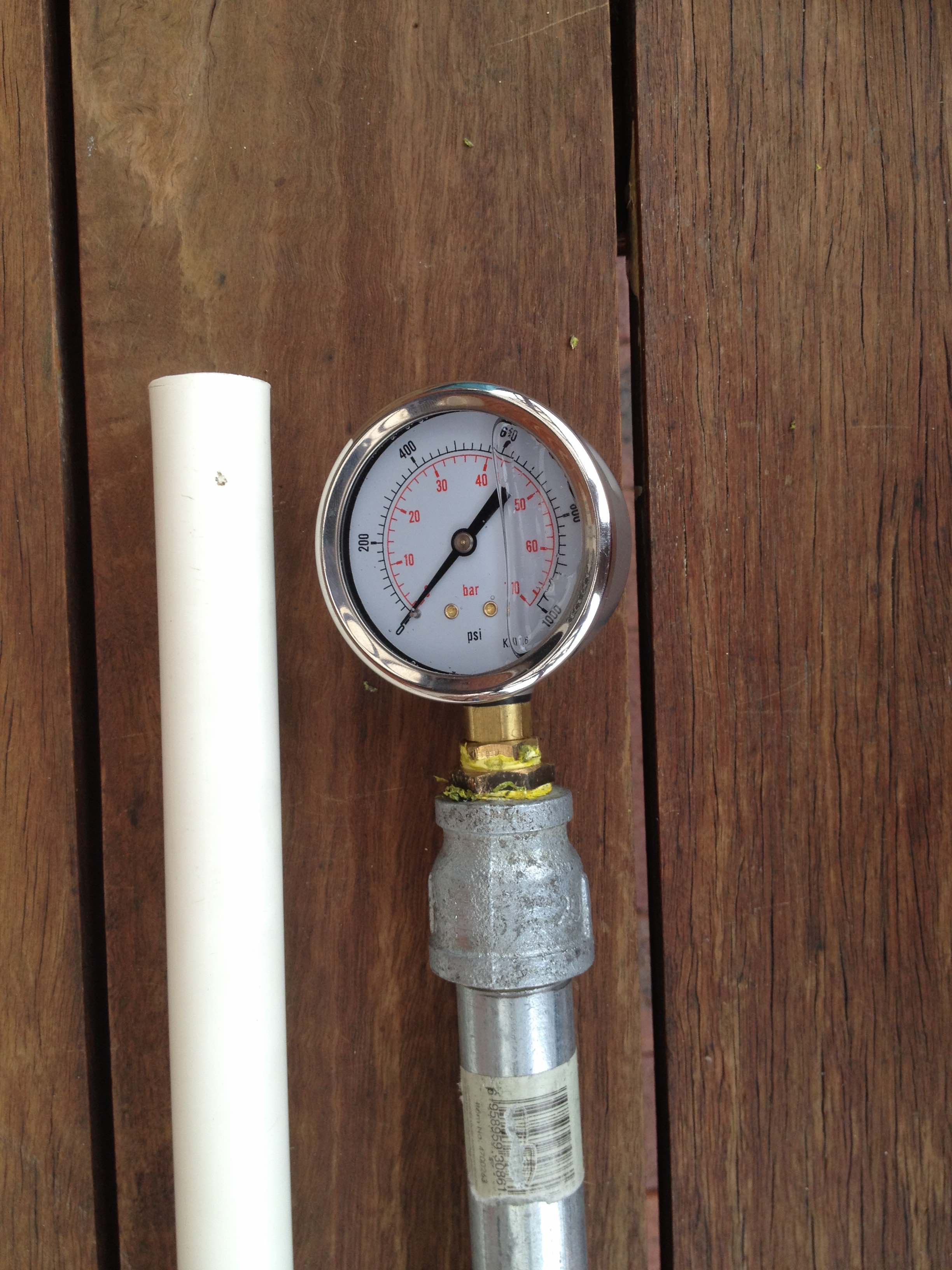

It gets about 10 shots per fill before it starts to noticeably lose power. I can charge it with a track pump to 200psi or fridge compressor to about 400 (more if I wasn't scared it would blow up - I tested it filled to 450psi under a bunch of sand bags 10 times before I trusted it to 400).
At 200psi it hits hard enough to punch through 18 layers of cardboard from close range with a 9mm ball bearing for at least 10 shots. I have some 9mm plastic beads that go really fast (no chronograph so wont even make a guess about velocity but I can't see them in flight).
I think I will swap out the galvanised tube to a sodastream bottle with a regulator so I can take it to higher pressures in the tank and take multi shots at about 150psi. I my fridge compressor will get up to about 750 so should get a good number of shots off with that setup.
I can do an exploded view of everything if people are interested... but it's all pretty much self explanatory.
Tep
p.s. For some reason the QEV performance deteriorates significantly after about 500psi anyway, I can't work out why if anyone has any insights then please share. (I know that is fairly scary to put 600 psi through one of these Chinese QEV - what can I say...)
