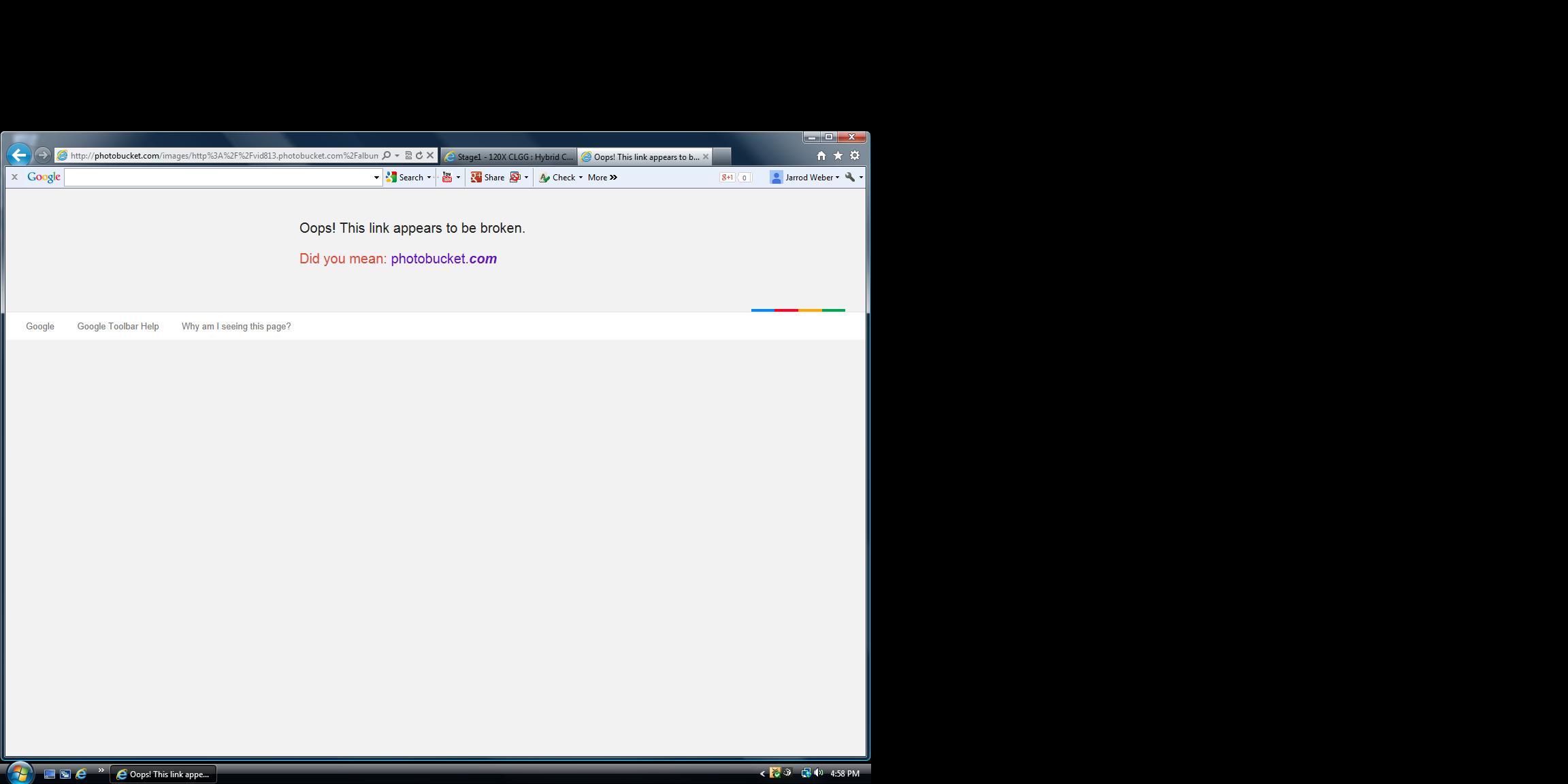

This is what I get when I open the video link.

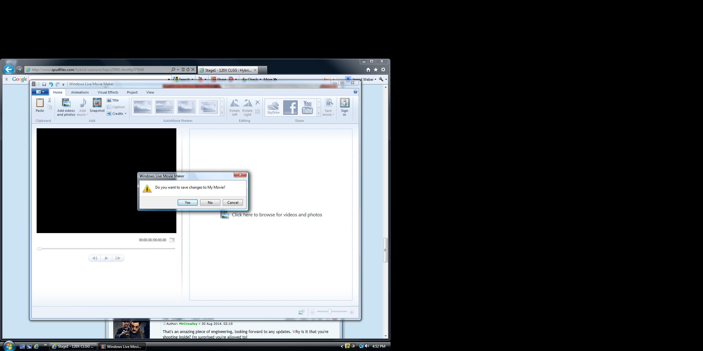

When I close the player I get this.
When I paste the link in the Photobucket search field I get this.
Is anyone else having issues watching the video7
