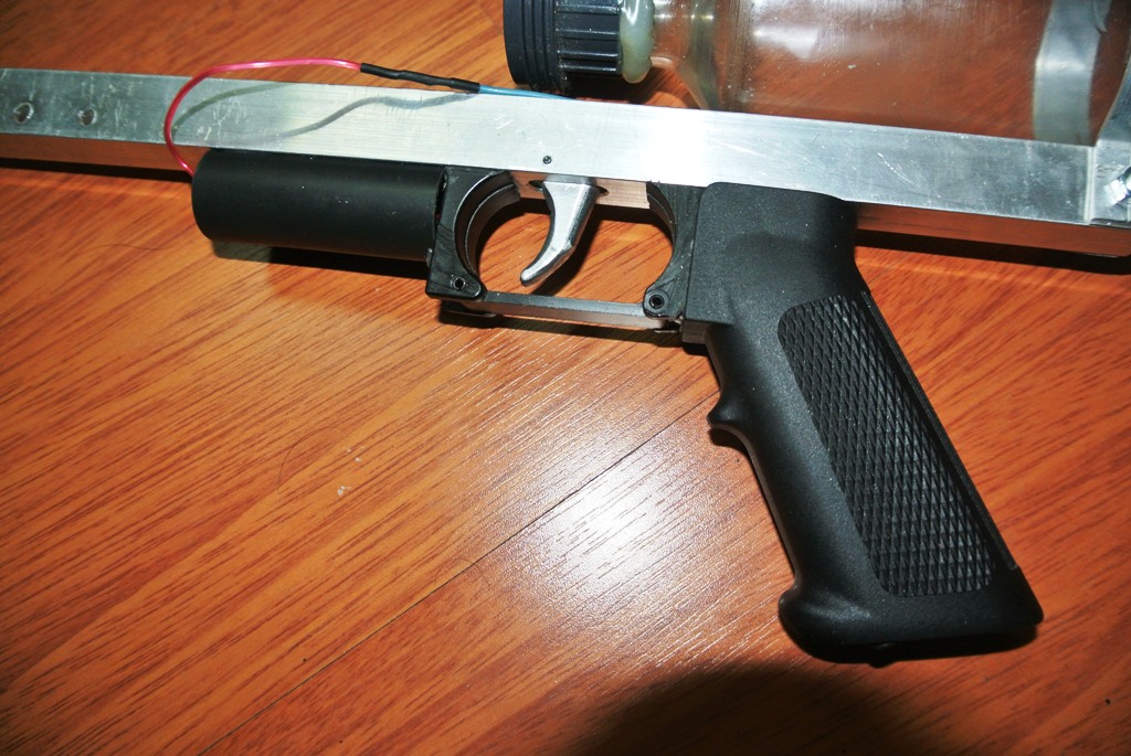

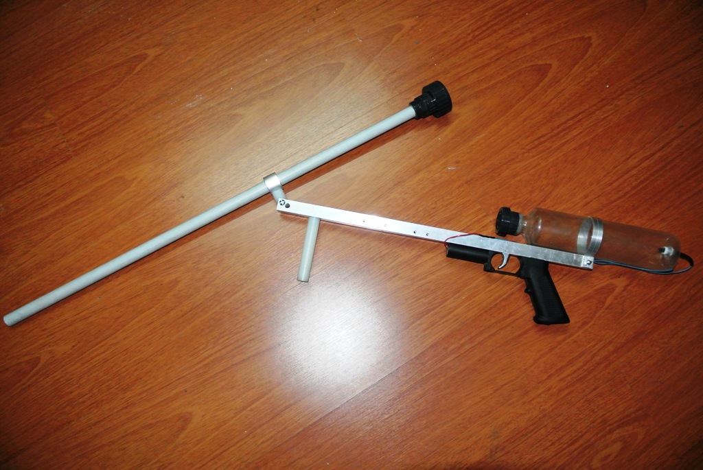

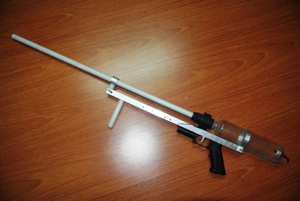

One of them arrived and wanted to test it out. Used few airsoft parts what was in my trash pile, a 4 AAA battery holder fits nicely inside the grip of an AEG.
Great ignition, recommended. Fueled with a mini torch and took one dry fire in my garage, ears still ringing.
Will make a more robust grip with the battery and ignition incorporated once I get my own 3D printer.

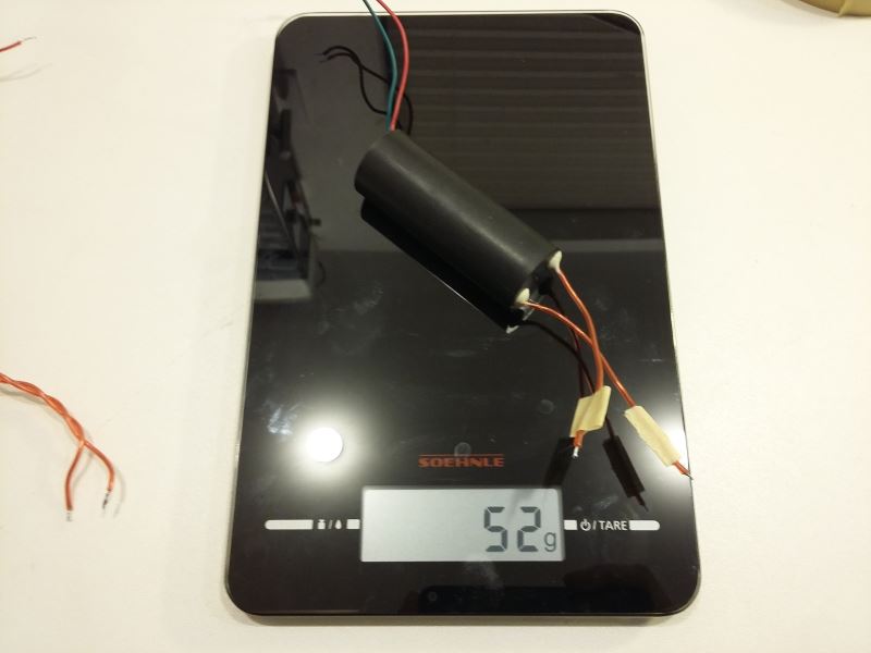

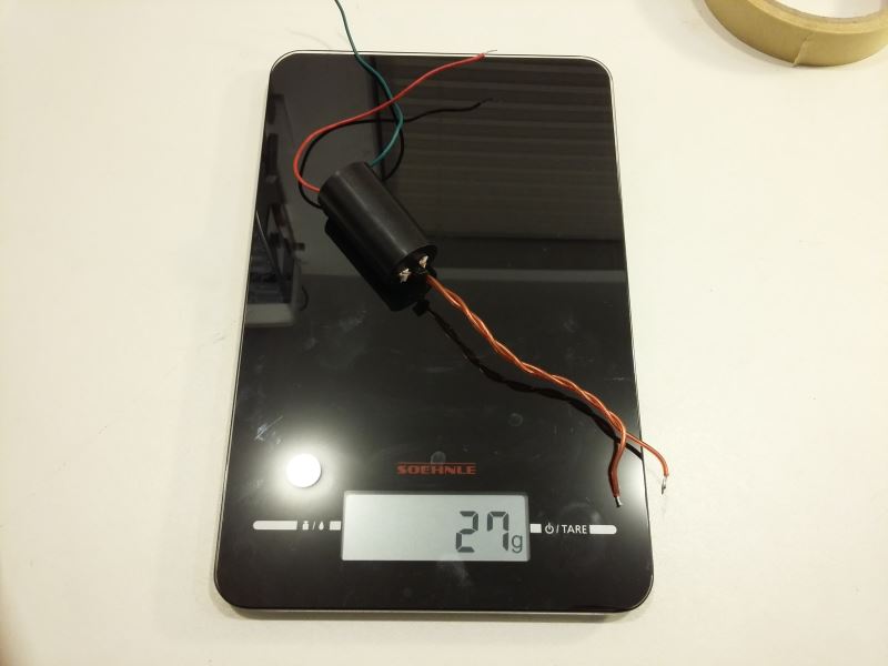

Hi, sorry for bringing up an old thread. I bought 3 of these back in October 2015 on ebay from different sellers. 2 of them are of the size 24 x 65mm and one was smaller and only half the weight. I'm trying to find the small one to get some more of those but the listing from back then is closed and all those I could find now either don't mention physical size or they are the bigger model.
Can anyone help me finding the smaller one? Maybe they run under a different name?
Big one 24x65mm, too big for my use.
Smaller one but still very good spark.
