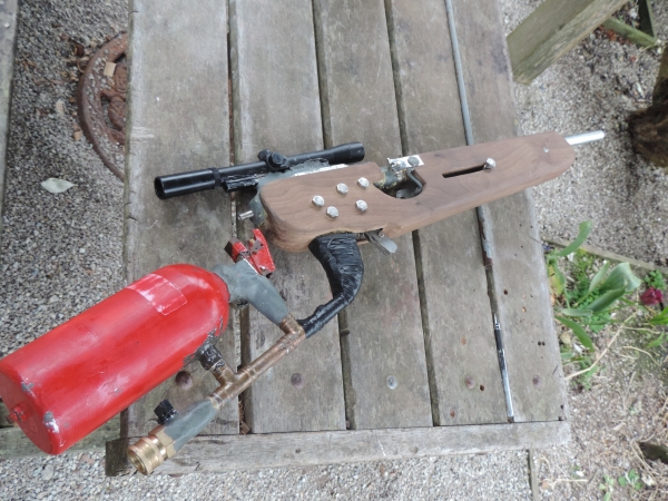

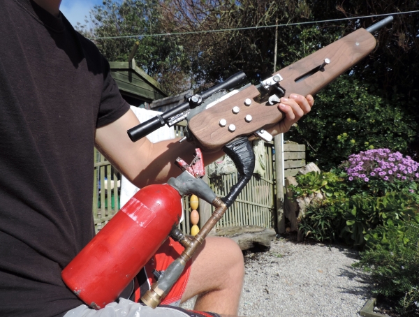

I have built a new air-gun, very similar to my old one, however this one is much stronger and durable. My old one can be found here - http://www.spudfiles.com/pneumatic-cann ... 25658.html
My gun looks quite different now, as I have recently fiber-glassed the pipe work at the back.

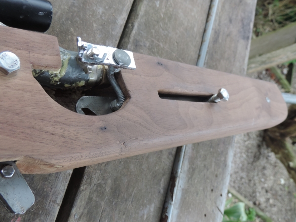

It consists of a powder fire extinguisher used as a stock, which I transfer the pressure into the second chamber (consisting of copper pipe). The pressure is held into the second chamber by the ball valve - this is connected to a hook (with a bolt attached) and a spring. As I pull back the bolt (located at the front, in the wood), this pulls back the hook which pulls back the ball valve. Once the ball valve is in a closed position the hook will have hooked onto the trigger. Releasing the trigger basically does this all backwards, opening the ball valve very quickly.

In this video I am using 240psi, as that was the maximum pressure my old pump could withstand. However, since making this video, I have brought myself a new pump capable of 350psi. I have 7 shots, (the 7th shot has a pressure of 200psi) So even that is immensely powerful. It takes perhaps 3-5 seconds to reload between each shot (which includes loading in the ball bearing) - This is with my new loading mechanism which I will upload in the near future, and is very cool to watch.
Trigger mechanism.
Trigger mechanism.

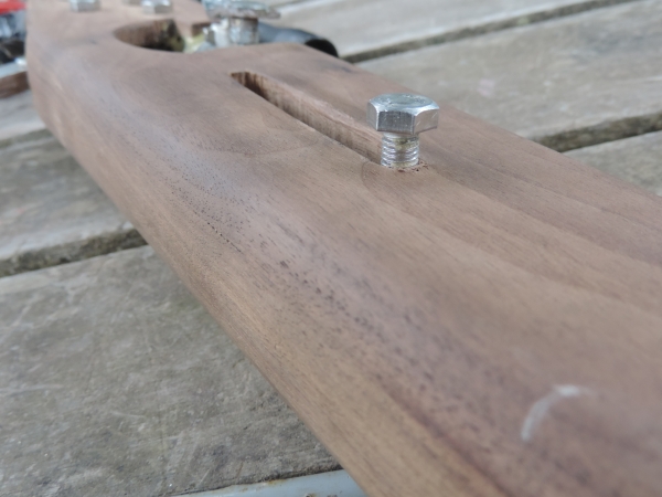

I have also fiber-glassed the entire back section of the copper pipe and fire extinguisher, this creates a seamless finish which I will eventually paint..(and hides my shoddy puttying and epoxy). The wood at the front is black walnut (wasn't cheap either..) I plan to make this look much much better, more durable and more professional looking.
Black walnut (not cheap stuff)! Notice the hairline gap where the wood was jointed. I sawed (by hand) 2 cuts along the length of the wood until I had 3 planks, removed material from the middle plank, then stuck them back together.

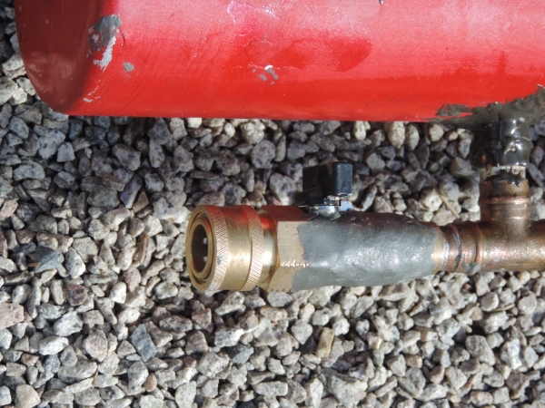

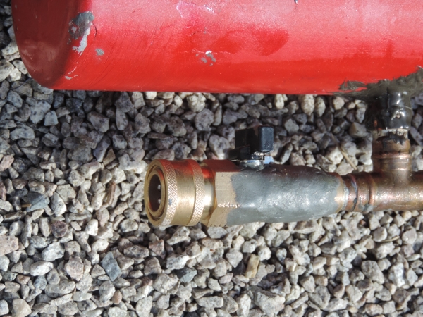

A Quick-Connect fitting, used as an alternative way of re-pressurizing.

can you explain the working of the trigger mechanism a bit more or maybe show picture/schematics? I don't really understand it yet.
