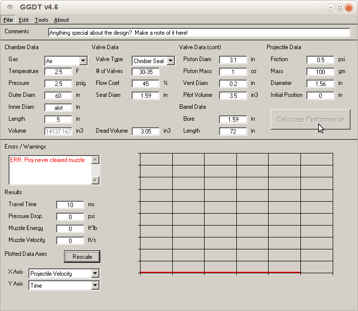

Posts: 3643
Been thanked: 62 times
Screenshot-GGDT v4.6.png (21.71 KiB) Viewed 4763 times
It doesn't work. :(
Seriously though, can you be a little more specific?

mark.f wrote:
It doesn't work. :(
Does the shape of the chamber make any difference? Im wondering ? Explain what you need more of,im using 3 inch pvc for the chamber defintly 5 feet , barrel i was told double my chamber which woulf be 10 im not using that long of a barrel thats insane in my eyes

I think best way for you is just to make it, put a little bit longer barrel then your chamber is and thats fine. If you want, you can simulate your cannon power using the mentioned GGDT but you have to learn to do it yourself, because we cant know what pressure your using or what you are shooting etc.
We will help you with the GGDT if you have questions and the program is free and very simple to use.
