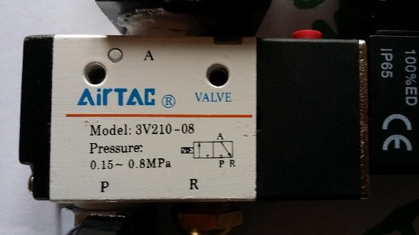

Here is a picture from closer by.

BramR wrote:Here is a picture from closer by.
The attachment solenoid.jpg is no longer available
Yeap, thats a pilot operated valve. So to use it you need a constant pressure at port P. Thats the same reason the valve says 0.15-0.8MPa pressure and not 0-0.8MPA :D
Because it's NC/normally closed valve it's dangerous to use it with qev since if you lose power from low battery or bad connection etc. it will shoot :!:
