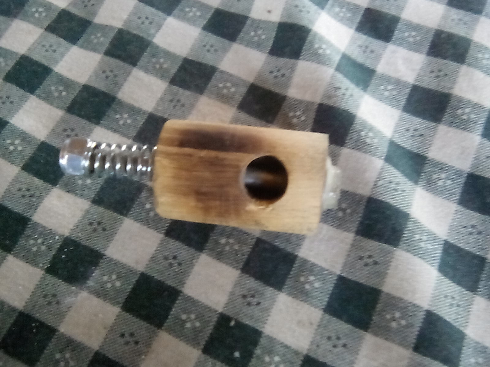

Thanks for your thoughts. Above is my first valve of any kind. The second was similar and installed in my first launcher. Surprisingly easy to open, and gave a second shot. Iirc (14 years ago) it recocked too.
Brian it may have been your set up that inspired me to look into this, but then I keep seeing high power hammer valves in factory pneumatics so I am trying to clarify why we build a hammer valve to pilot a qev, other than it seems elegant
I think jsr summed it up well. I am not sure how long my hammer valve would last either before breaking or losing too much pressure... But that seems to be problem with lots of homebuilt valves
