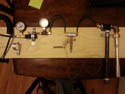

Hey Folks,
I've been working on a piloted QEV style paintball marker and am running into results that I do not understand:
- Paintball velocity is ~75% of predicted velocity
- Efficiency (shots per tank) of set-up is ~20% of predicted value
I'm hoping someone here might be able to help me understand my results.
Description of Set-up:
Before building an actual paintball marker, I've build a proof-of-concept test cannon. It uses all of the parts that the paintball marker will use, but mounts them in an easily accessible and exchangeable configuration.
- HPA tank to a low pressure regulator (Palmers). Then to a 3-way, 2-position pilot valve (McMaster). Then to a QEV (the chinese black box QE-04). The exhaust of a QEV leads to a 7 inch barrel.
- I've built a sear-based trigger mechanism to operate the pilot valve to remove the human element from triggering. A pull string releases a sear allowing a spring to quickly un-press the pin on the pilot valve.
Description of Operation:
- trigger mechanism is set, pressing the pin on the pilot valve which pressurizes an air chamber (0.56" ID x 12" long)
- paintball is muzzle-loaded into the barrel
- pull string is pulled, trigger mechanism releases pin on pilot valve, QEV opens and air chamber empties through barrel

Welcome to the forum!
Interesting project, though your image showing the setup is not showing, it would really help to assess your work.
I'm assuming that you took all the dead volume into account when it came to predicting efficiency? All the losses caused by the air expanding from the main bottle through the various regulators until it reaches the actual firing chamber are going to drop the amount of available energy
A leaky system is definitely not going to help, you should eliminate this variable post haste for a meaningful test, otherwise it's like trying to determine your mileage with a hole in your gas tank!
With regards to velocity, I would say a +/- 25% match is reasonable within the parameters involved, barrel friction for example is a very significant factor especially since you have a relatively short barrel, and paintballs aren't exactly the most uniform projectiles in the world. Also silly question, have you weighed the paintballs for consistency?

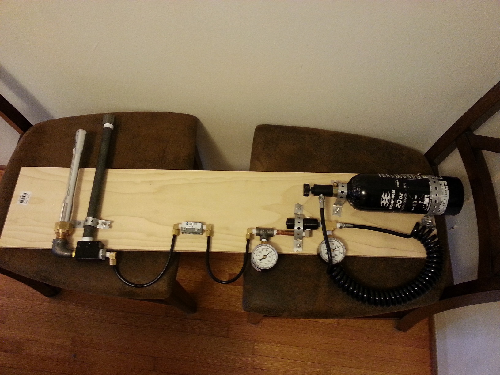

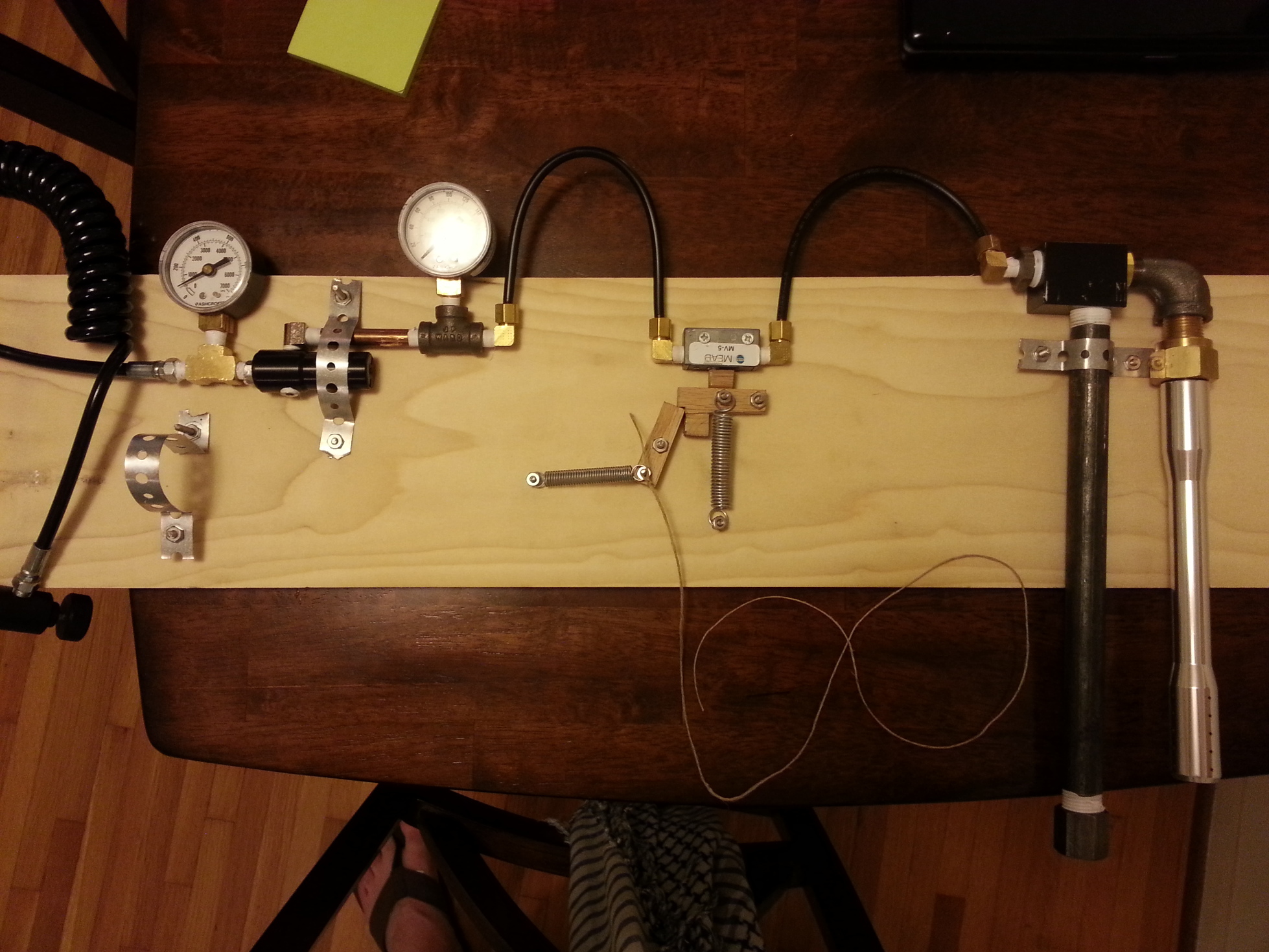

As promised, I have attached a higher resolution image of my test setup.
