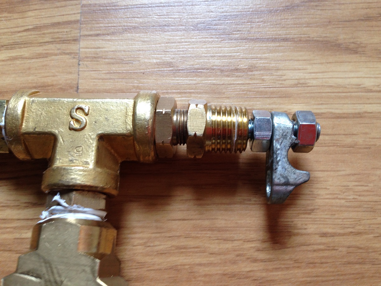

I sat down armed with every fitting and rubber washer I had in the house.
While sitting there I came up with a design similar to what you would find on the french "patator" forums.
I guess it's a direct actuated dump valve? please correct me if i'm wrong. I believe is the same principle as a QDV.

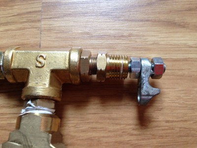

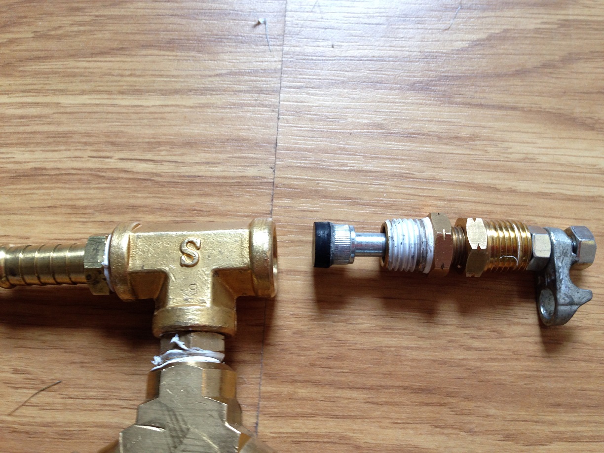

The piston is pushed forwards to sit against the barrel port, air is filled via the Schrader valve and flows into the valve, forcing the rubber face to seal against the barrel port.
When the piston is pulled backwards, the face unseals from the barrel port, allowing the air to exhaust.

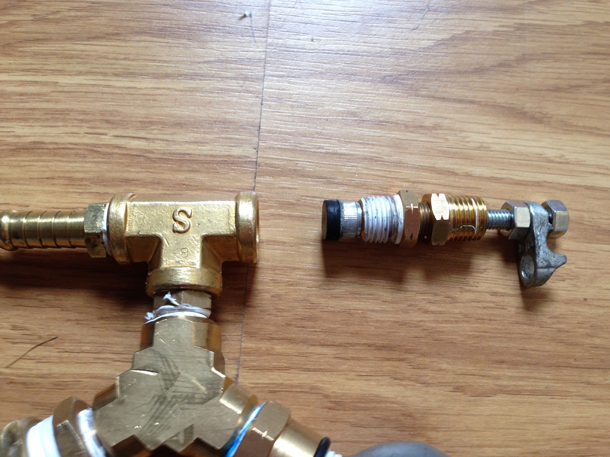

The valve housing is a 1/4" female tee, the barrel port is a 1/4" male x male hose tail with the barrel inserted into the hose barb.
The piston is a bolt with a thick rubber washer glued onto the top of it and has a groove cut for the rear o-ring to be seated snug and stay in place.
A 1/4" to 1/8" reducer houses a larger o-ring and slides over the back of the piston and screws into the valve housing to keep it all in place (and airtight lol).

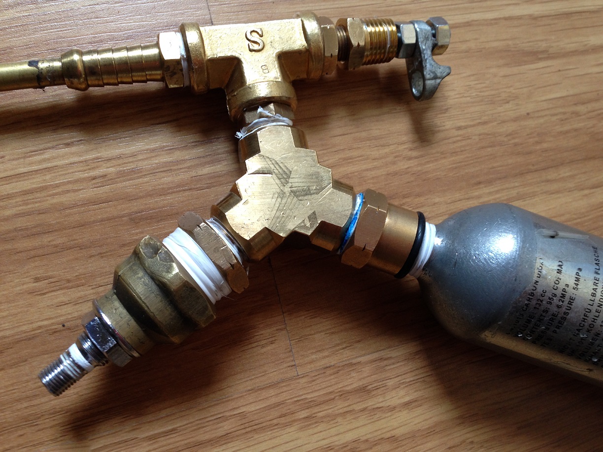

Under all the action is a 1/4" Y fitting which connects the QDV, Schrader and air tank together.
The air tank itself is an old aquarium CO2 canister with some of the thread removed to allow for full flow and a proper fit inside the screw fittings. A 3/8" to 1/4" reducer attaches the tank to the system.

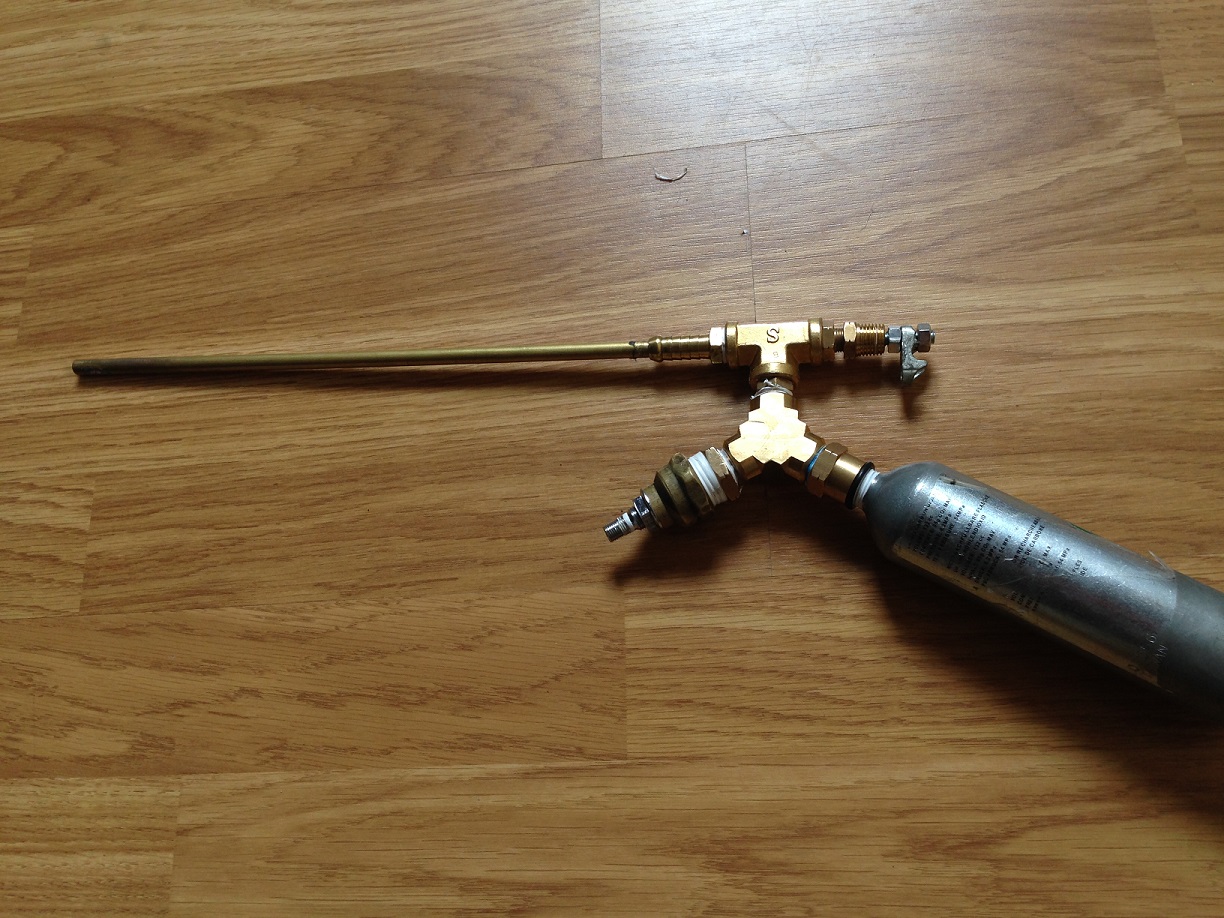

The barrel is a 9/32" OD (7.14mm) brass tube @ ~270mm length using 1/4" steel ball bearings as ammo, nice snug fit.

Overview - Skeletal
Overview - Skeletal
T & Y Config
T & Y Config
Valve Housing - Piston end is exposed with makeshift trigger added for smooth & consistent pull.
Piston - Closed position
Piston - Open position
Valve - Piston removed, just a good ol' fashioned tee.
Pretty well done with standard fittings, looks like the piston is more or less balanced by sealing the shaft which is quite clever. What pressure are you running at?

Exactly that, quite easy to actuate which I'm pretty impressed with for what it is.
Currently it's running at ~150psi, could easily push it to 250 - 300 I'd say. Unfortunately I'm restricted by the pump I'm using at the moment. The plan is to build a pressure/stirrup pump into the launcher itself. The Schrader fill port will be replaced with the homemade pump and fill the tank directly. Well, that's the plan anyway lol
