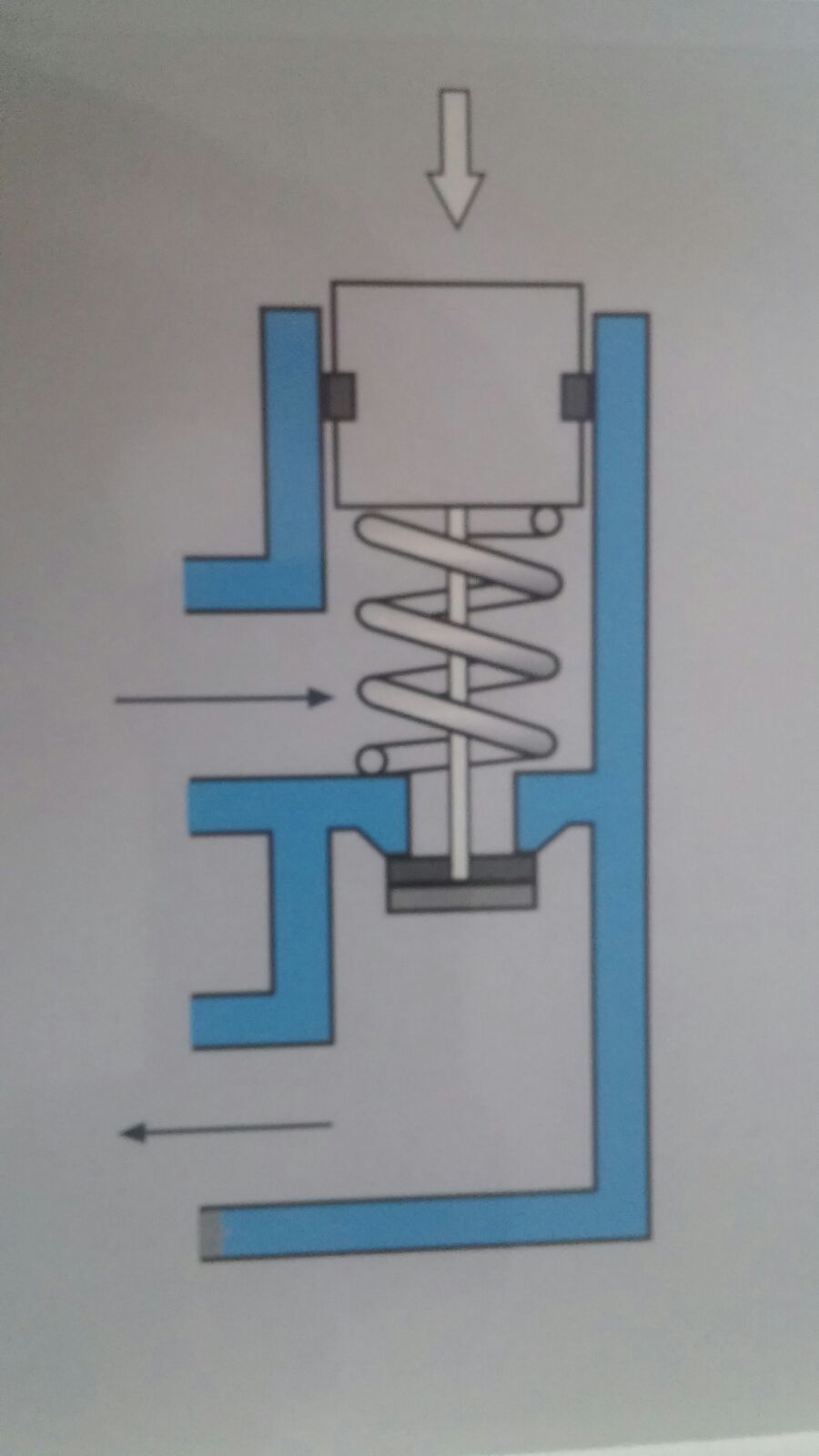

I find your considerations very interesting, and I don't have a proper answer to all of them, but I can address one;
The issue with pure mechanical action is generally that you can't go very high pressure without 'ridiculous' mechanical force to open the valve. That is what has stopped me from using (simple) designs like it. However, with a design like this, the force required to open the valve can be tuned by choosing the right spring.
This allows for high pressure firing, provided you find a spring strong enough. This would require that your input pressure always remains the same, or within certain boundaries. (because your mechanical system can only supply so much force)
I haven't seen this design being used yet (not that I have seen much 'advanced' systems), but I think with a few modifications, for example make the piston a conical shape for better airflow, I think it would work great.
If anyone has some other good examples of mechanical valves, please share!

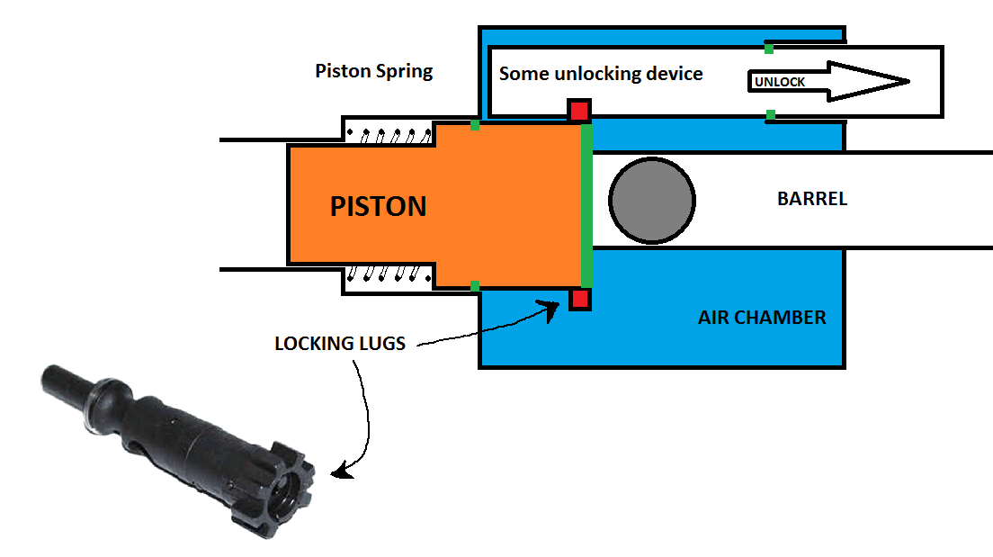

I imagine you could use a rotating bolt/piston like assault rifles use. It's a very tough and tried mechanism like in the picture attached. (Green things are airtight seals)
A sort of operating rod or "bolt carrier" would be used to unlock the piston, thus opening the valve by allowing the piston to fly away under chamber pressure. A spring closes the valve when the chamber pressure becomes too low.
An M16 bolt is overly intricate to machine. But triangular lugs like this one aren't unheard of and might be more suitable:
Something for you to notice is also the reduced diameter of the piston relatively to the chamber diameter. A smaller piston face means a smaller force needed to be tolerated by the locking mechanism.
I think it could be desirable to have the unlocking device to unlock upon pushing forward, but I'm not sure how to actually, in practice, make it lock or unlock. As it stands in the sketch it's just magic.

Mechanically actuated blow open valves.....not coaxial, but might give an idea or two. Common theme is to create a force bias using sealing diameters and to over come that bias using a mechanical striker.
Striker is the "U" shaped piece and although not completely obvious, it slides on the spool shaft. Striker spring goes between the striker and the pin through the spool shaft. Change in diameter on the shaft acts as a dash pot to dissipate excess energy of the spool (bumper). Manually reset by cocking striker. Would use a conventional sear/trigger.
Knock to crack blow open valve...steps on spool provide a degree of regulation and reset the spool, allowing chamber to re-fill.
Intended to use a paintball type tank, rifle was intended to be similar in layout to an AF Condor.
http://www.spudfiles.com/pneumatic-cann ... c7457.html
This was one of my very first projects when all I had was syringes and epoxy, these days I would use proper o-rings and a balanced piston to reduce the strain on the trigger.
