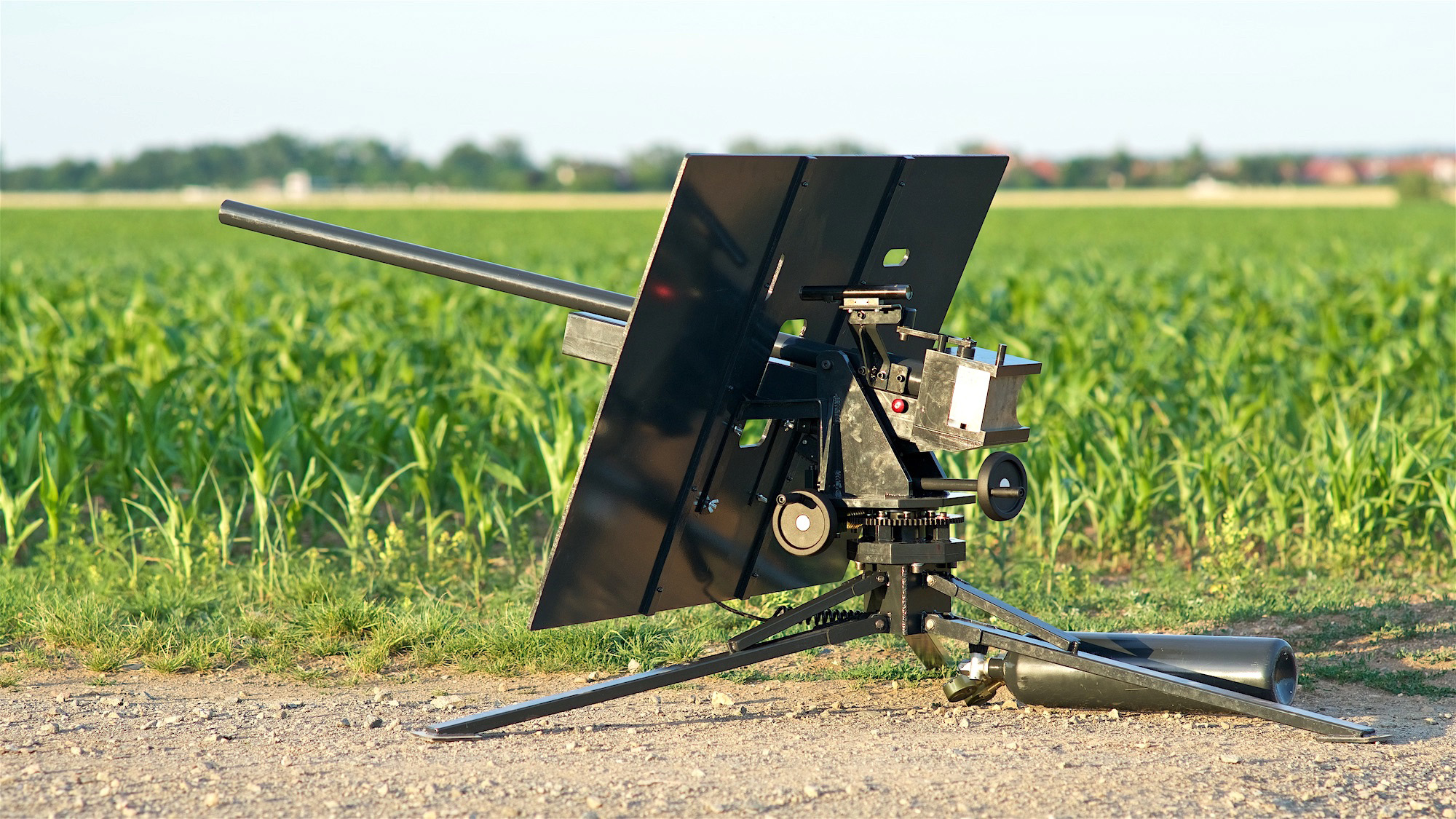

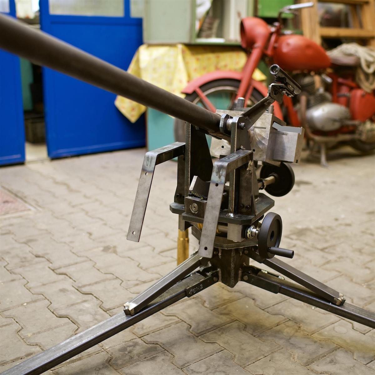

Thanks! It should be finished in March/April hopefully. The valve is 24V DC 1/2" rated to 50 bar. The air goes from scuba tank through initial regulator and safety valve.

Very impressive! Do you actually load cartridges or do you put the projectiles in directly? What does the ammunition look like?
I load cartridges. It solves several things at once; transporting of fragile ammo, loading of fragile ammo and it looks and feels perfect. Empty cartridge is ejected at the end of the breech opening cycle.
I don't have any drawing or standalone photo of the ammo (yet). But the shot is drag stabilized. What you see protruding from the cartridge is the main body of the shot, hidden in the cartridge are simple X shaped stabilizers of the same diameter.
Is there a spring loaded ejector?Empty cartridge is ejected at the end of the breech opening cycle.
Also do you feed air through the base of the cartridge?

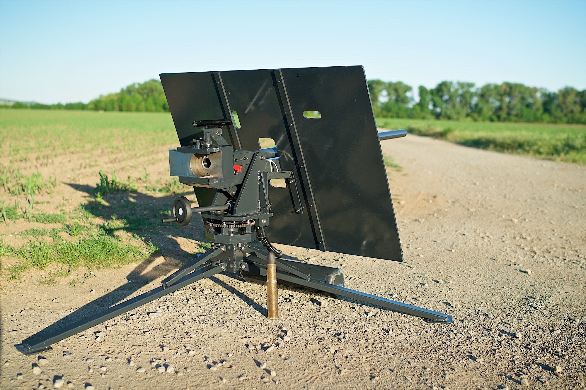

I'm going to make a proper video in the beginning of July. I'm still fine tuning several parts of the gun. For the time being, a new photo of the gun and a snapshot from safety tests. One hit is from the gun (2m distance), another one from paintball marker (tournament-grade paintball, 1m).
