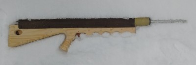

Not ready for showcase yet... thought I'd post this now and maybe get some inspiration on how to finish this guy.
Short story: This is the Bullshark, rebuilt in bits from my MK 2 back in 2003, standard piston valve muzzleloader, .64 cal currently shooting marbles at 240psi. Overall length 38" , overall weight under 5 lbs, mechanically triggered

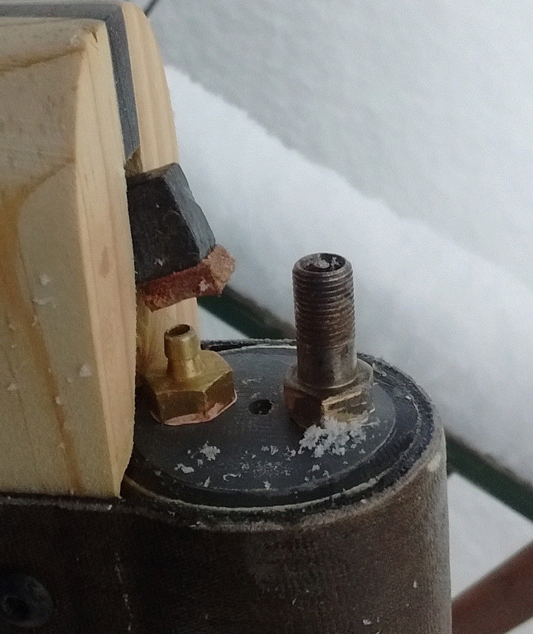

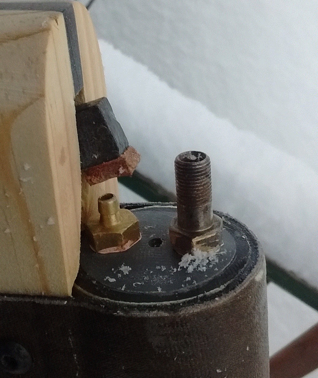

I'm quite proud of the pilot valve that I call the "Liftoff" valve (hopefully I can get these pics to work)
Chrono shows 630fps @150 psi with marble, 430 fps @200psi with 5/8" steel bearing
Since getting the pilot to stop leaking it has been awesome@240psi (that's as high as my bicycle pump goes) but it was snowing too hard to get the chrony out... data and video to come...
More of the story... part of the rationale behind the design of this launcher was to use as few plumbing parts as possible. The Liftoff pilot can be made of very basic materials. The pressure tube is ABS DWV but before the obligatory safety warnings get posted, it has 3 layers of Kevlar wrapped around it in aircraft laminating epoxy (plus 2 layers glass sanding veil)
The stock has minimal inletting, as all the mech is in one plane. Trigger has to be mechanical for me... originally I piloted this thing with a schrader at the end of a tube but I learned to shoot on real triggers and hate mushy valve triggers.
It's a "no excuses" sort of build... Any smooth tubes, scrap schrader, plus some gumption can be the basis for a similar build. I did have access to a lathe briefly so the end plugs are machined, but nowadays I would probably cast them from epoxy with additives.
750 fps marble launcher

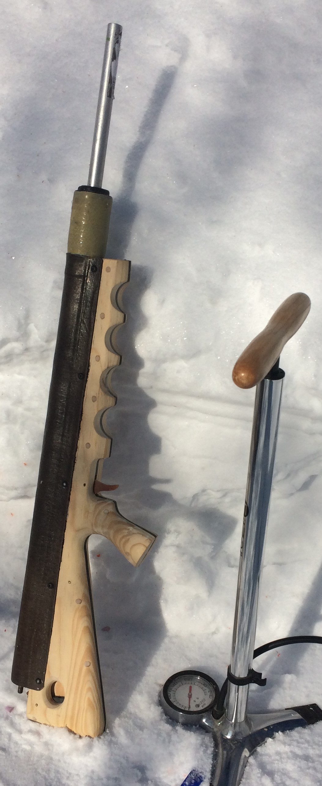

Better pic (not sinking in snow)
The wood definitely needs some colour, but I'm not happy with the quality so it will probably get paint. Needs a trigger guard... so sketchy without.
Needs ramrod holder.

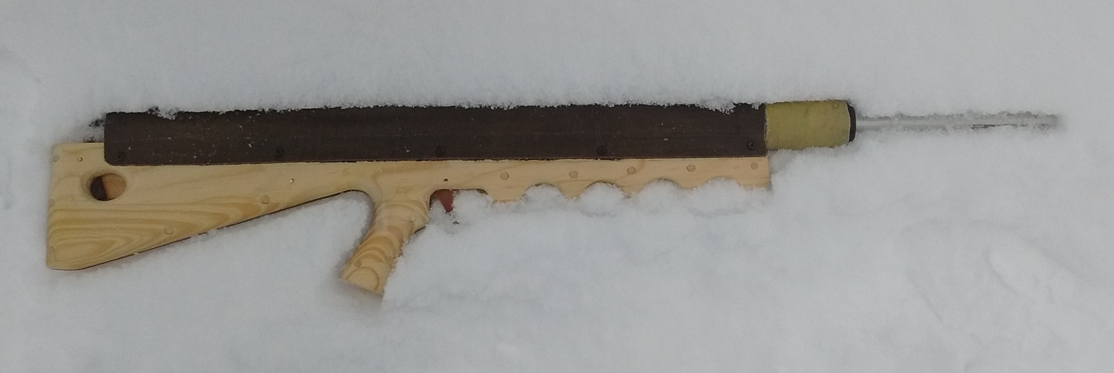

Interesting pilot setup, how do you force the seal against the nipple?

The seal is held against the nipple by a pivoting bar. The other end of the bar is held by a sear which is the end of another, longer pivoting bar. Pulling the trigger actuates the longer bar, moves the sear down, allows the first bar to pivot and the seal to move. Very low forces on the mech. The final reveal will show how it works.
I got the idea from my testing of the launchers by holding a thumb or finger over the pilot port. It's just a mechanical finger! The actual seal can be fussy (eraser doesn't work more than once) but grease on leather works, plastecine on leather also works (though I have a suspicion it slows piloting slightly if it gets in the nipple)
Currently it holds pressure overnight.
Got some paint on it yesterday and a trigger guard today (now it can be locked) but it needs a very high scope mount to be fabricated.

It would be much more reliably and good to higher pressures with an o-ringed spool, don't forget you share the same continent with some friendly machinists if you want something more professional done.The actual seal can be fussy (eraser doesn't work more than once) but grease on leather works, plastecine on leather also works (though I have a suspicion it slows piloting slightly if it gets in the nipple)

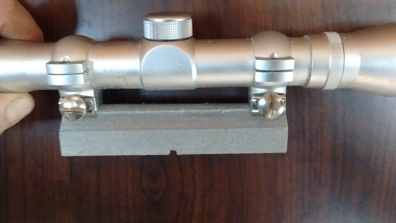

Anyway, more progress, got the scope mount fabbed, painted, epoxy is curing I type. If anybody is interested in mounting a scope on a homebuilt this is my "one group zero"
In my version I center the scope in it's adjustments to give me the widest range after mounting. THen I shoot a group at first distance (ball still traveling up) after consulting ballistics calculators to optimize point-blank range. For this group I hot glue a laser to the barrel, shoot at a bullseye 3 times (use a larger backstop than you think you need... ask me how I know) at 9 yards
Now clamp the launcher so that the laser still points at the bullseye at the same distance. Mount the scope so it points at the point of impact (center of group) using shims, tape, whatever will hold it in position. If you have patience you can keep carving the mount until it sits just right. Mix epoxy and slather it on... usually some more shimming. Using this method the scope should be zero-ed without having to use the adjustments much.

The high scope mount:
