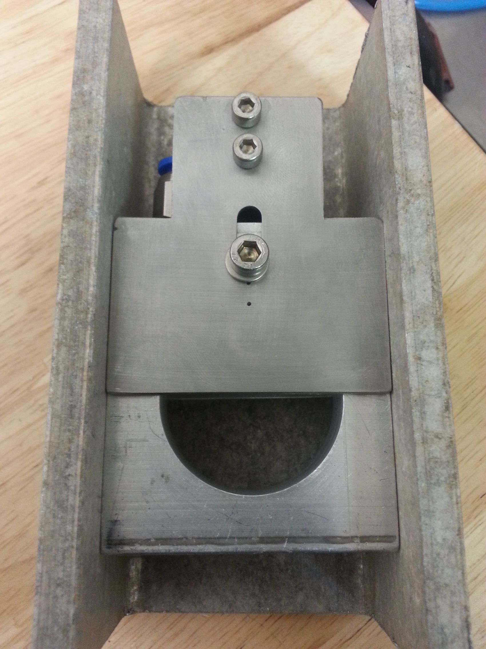

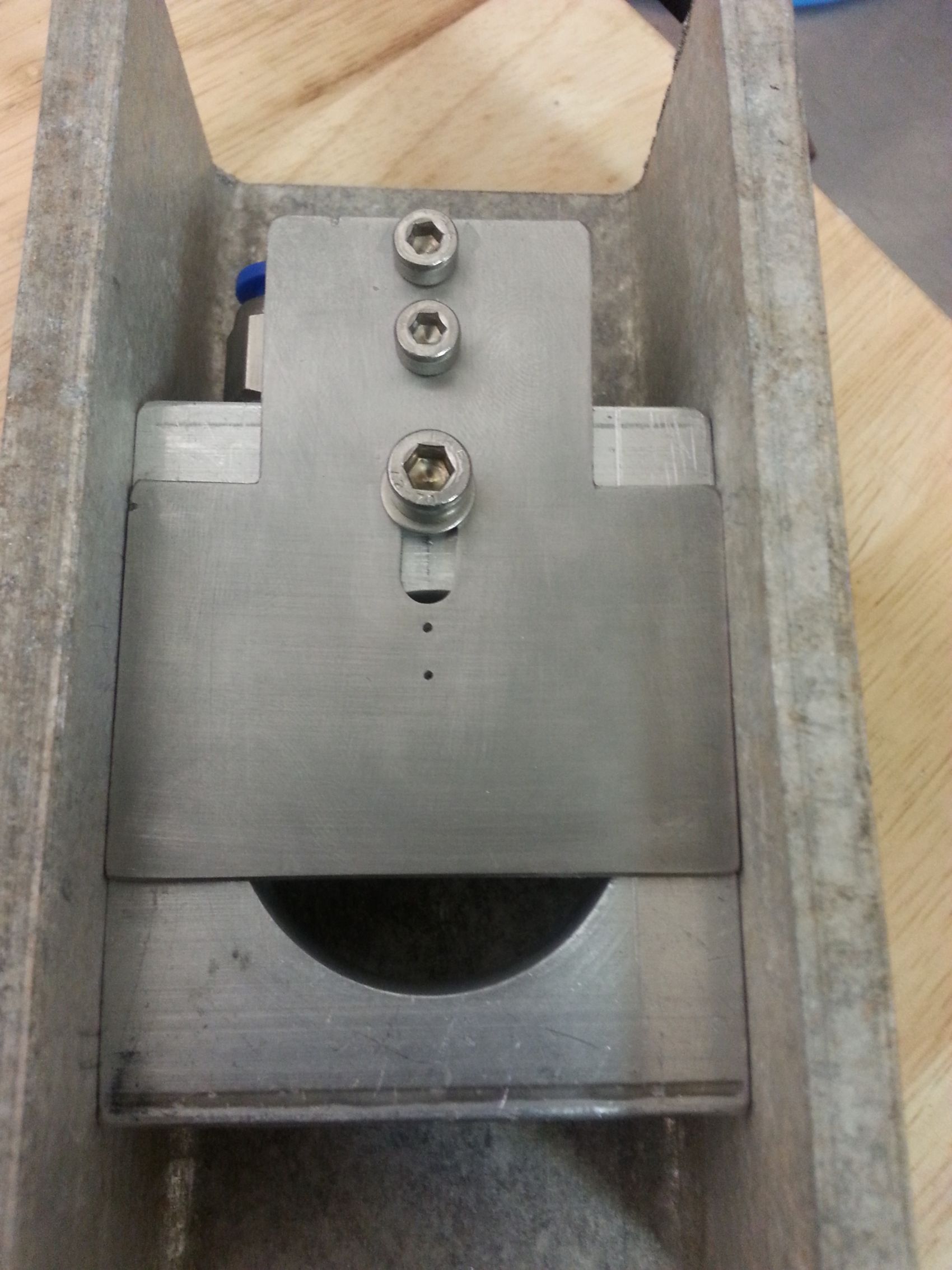

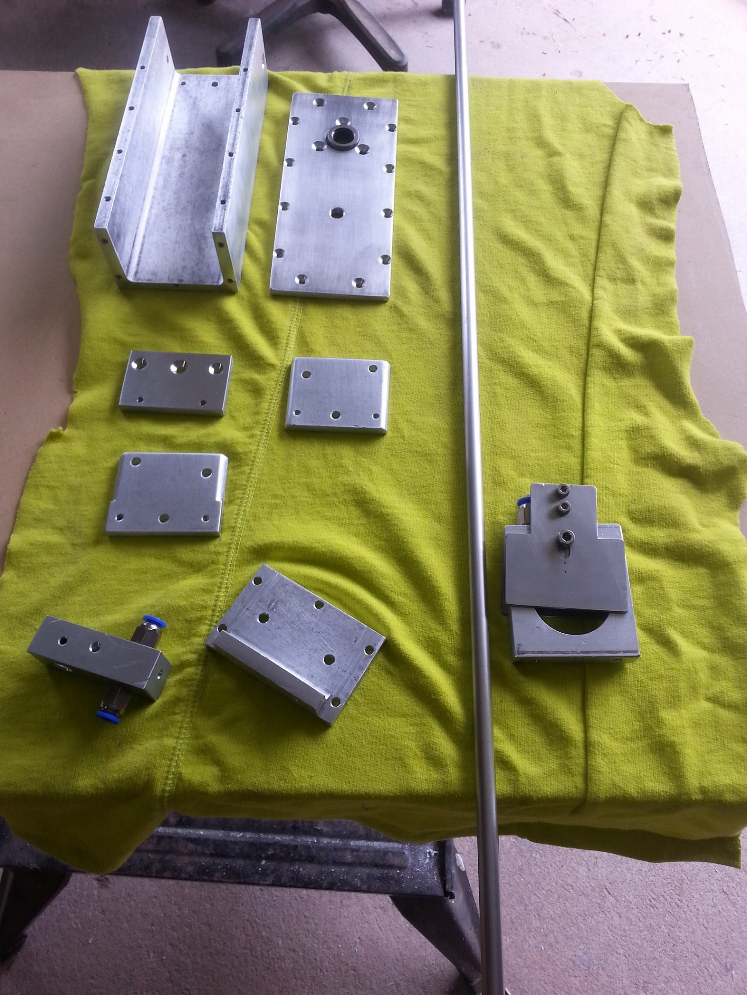

work is progressing slowly on this project, finished the vortex block and the side shields, the vortex hole is about 40mm, the shields block it from 20 to 10mm, does that seem like a good range ?
Posts: 26220
Been thanked: 352 times
Sounds like more than enough to have it feeding reliably if you have a good flow from your valve.

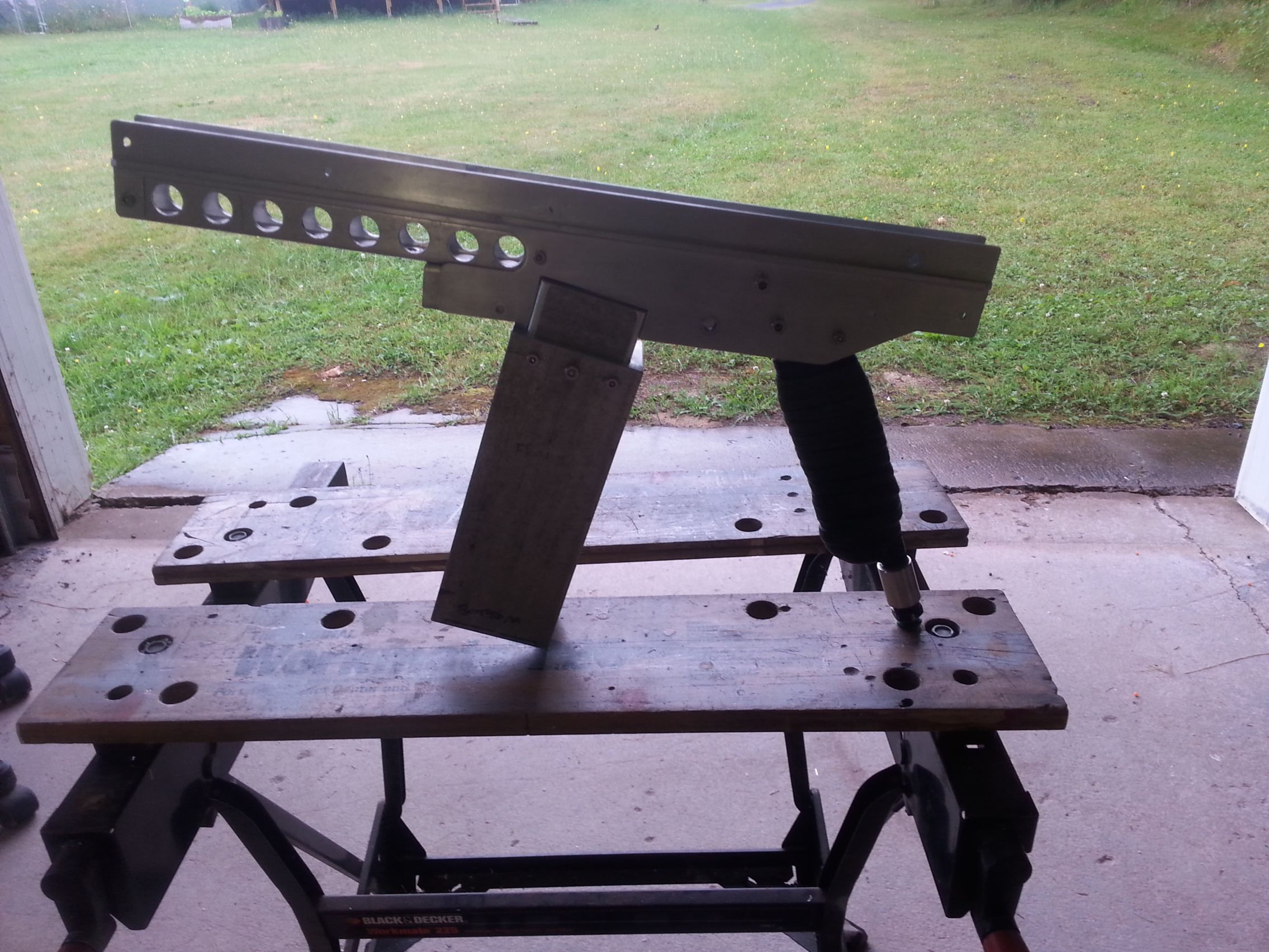

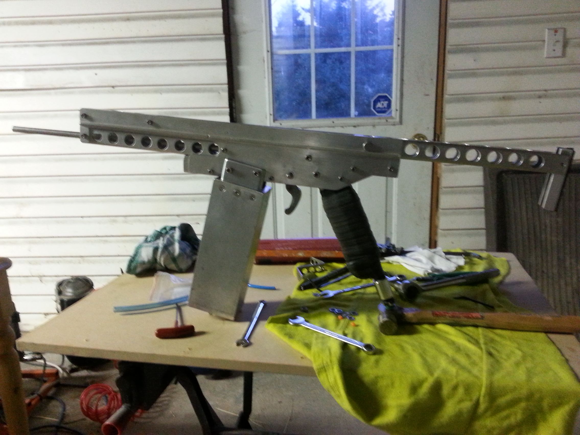

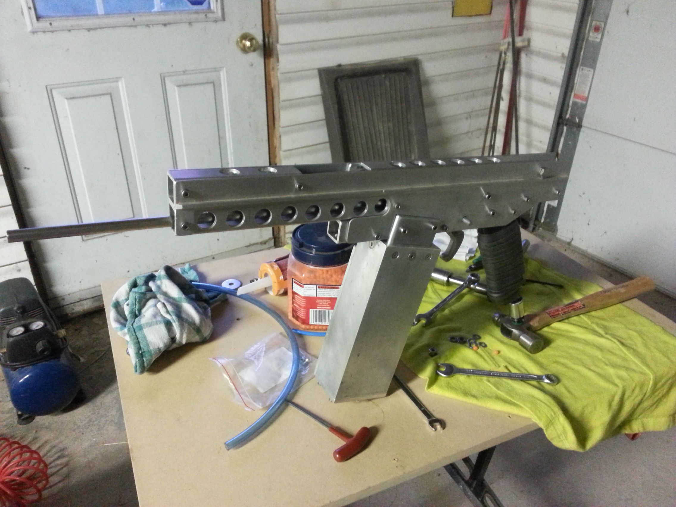

Working on this again, it's going to be based on my pump action BB gun that I built awhile ago, never really used it as it was a pain to reload, so the frame is mostly built already, just got to add the vortex block/hopper. The barrel starts at the base of the hopper so will need to curve.

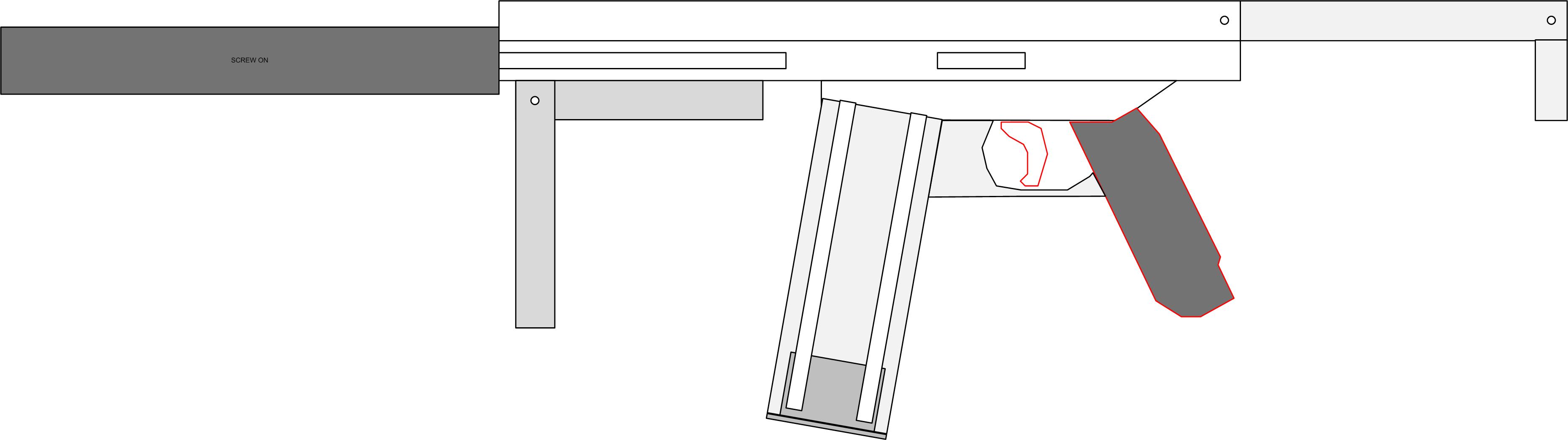

Should look like this with the folding stock, front grip and the barrel extension on

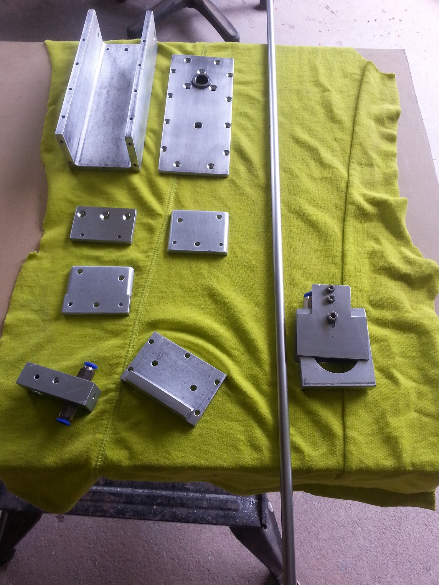

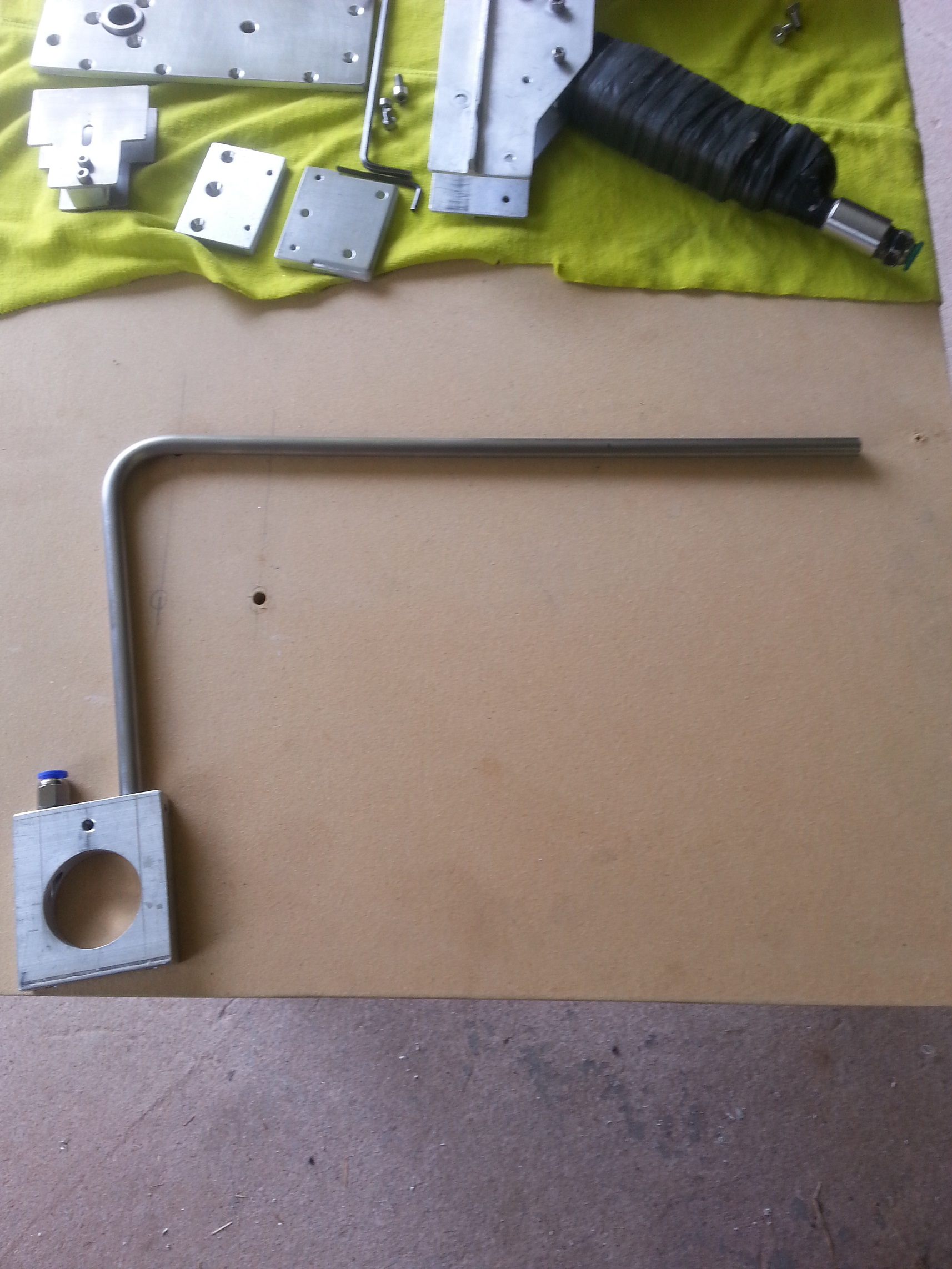

The magazine parts finished.

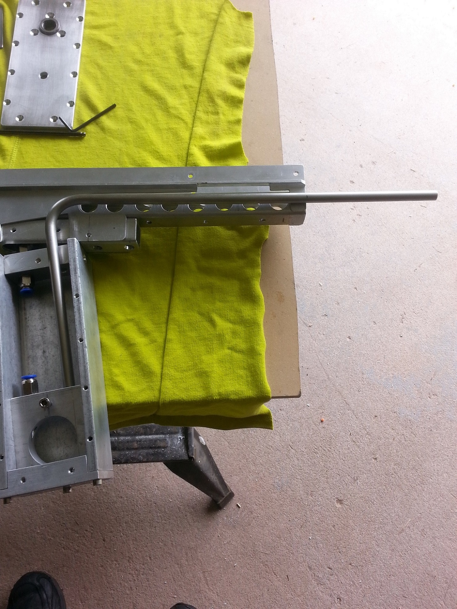

Cut and bent the barrel
Total length is about 540mm
