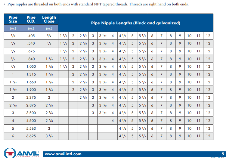

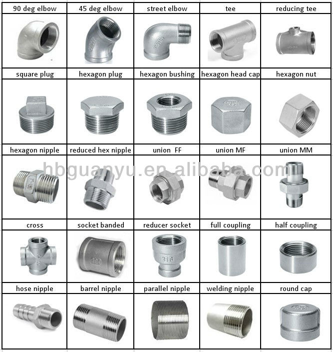

Should be able to assemble what you need from the appropriate fittings, if you know where to source them. Barrel nipples come in various lengths so you don't have to worry about cutting threads.

You could go 2"
This is interesting. So one could assemble the whole thing with screwin fittings?

Air chamber made of fittings should allow higher pressure to be used or/and better safety then PVC. I have no idea how to implement a tire air valve in to the system. I would rather replace the hose going from the pump with other pressure hose with some quick release fitting coupling that you implement in the launcher
There are fittings rated to different pressures. It is easy to find those rated to 150 psi or higher for even better safety. Simple ball valve might suffice for your build imho.
