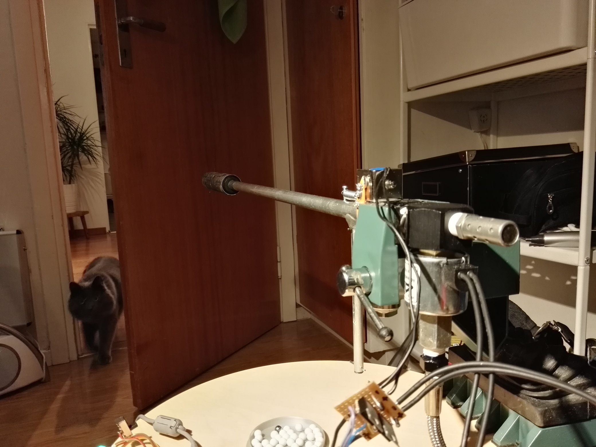

Almost the hole thing, the tank does not show.

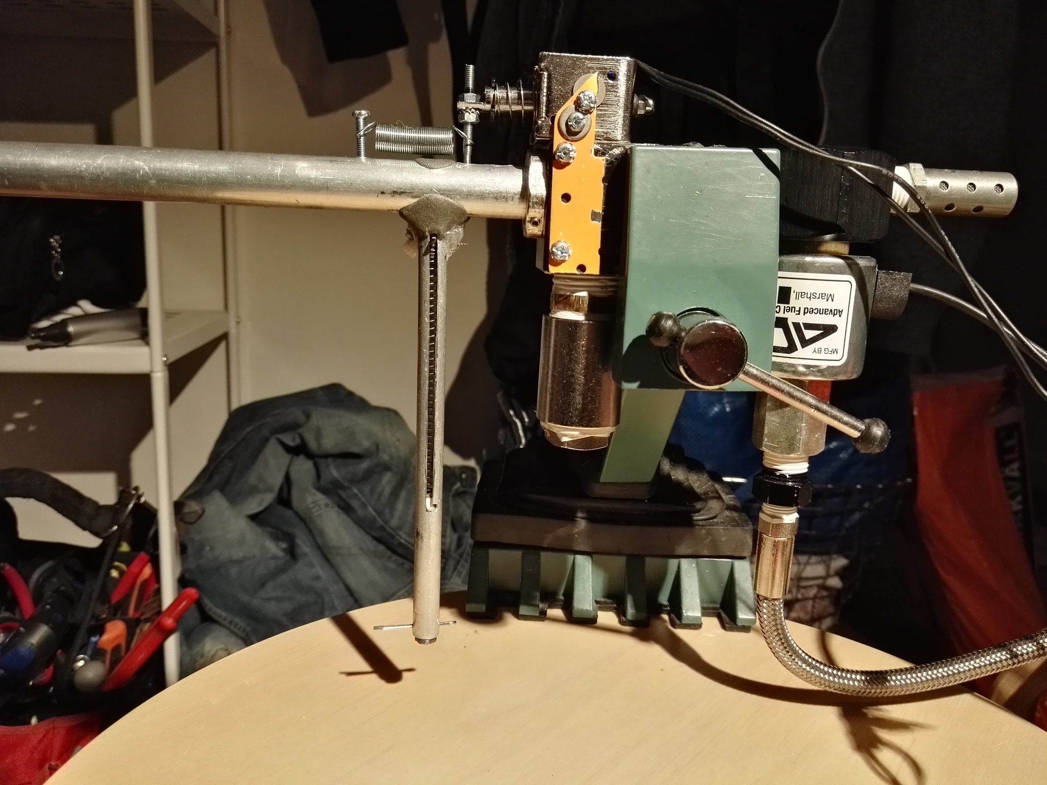

Magg, loading mech, qev, dump tank, 3 way solenoid and reloading solenoid, silencer on the exhaust port!

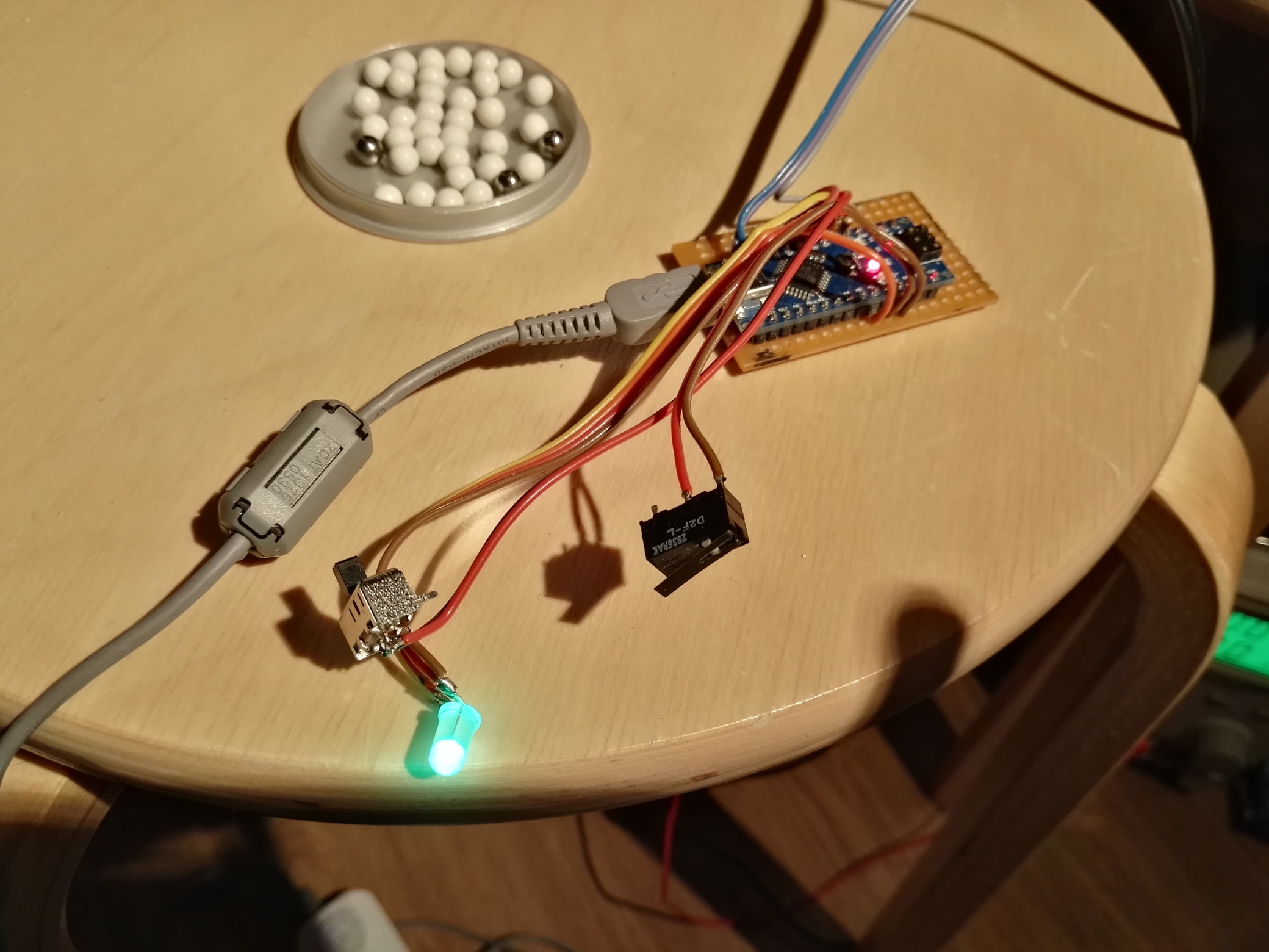

Brain, trigger, fire selector switch and info rgd led.

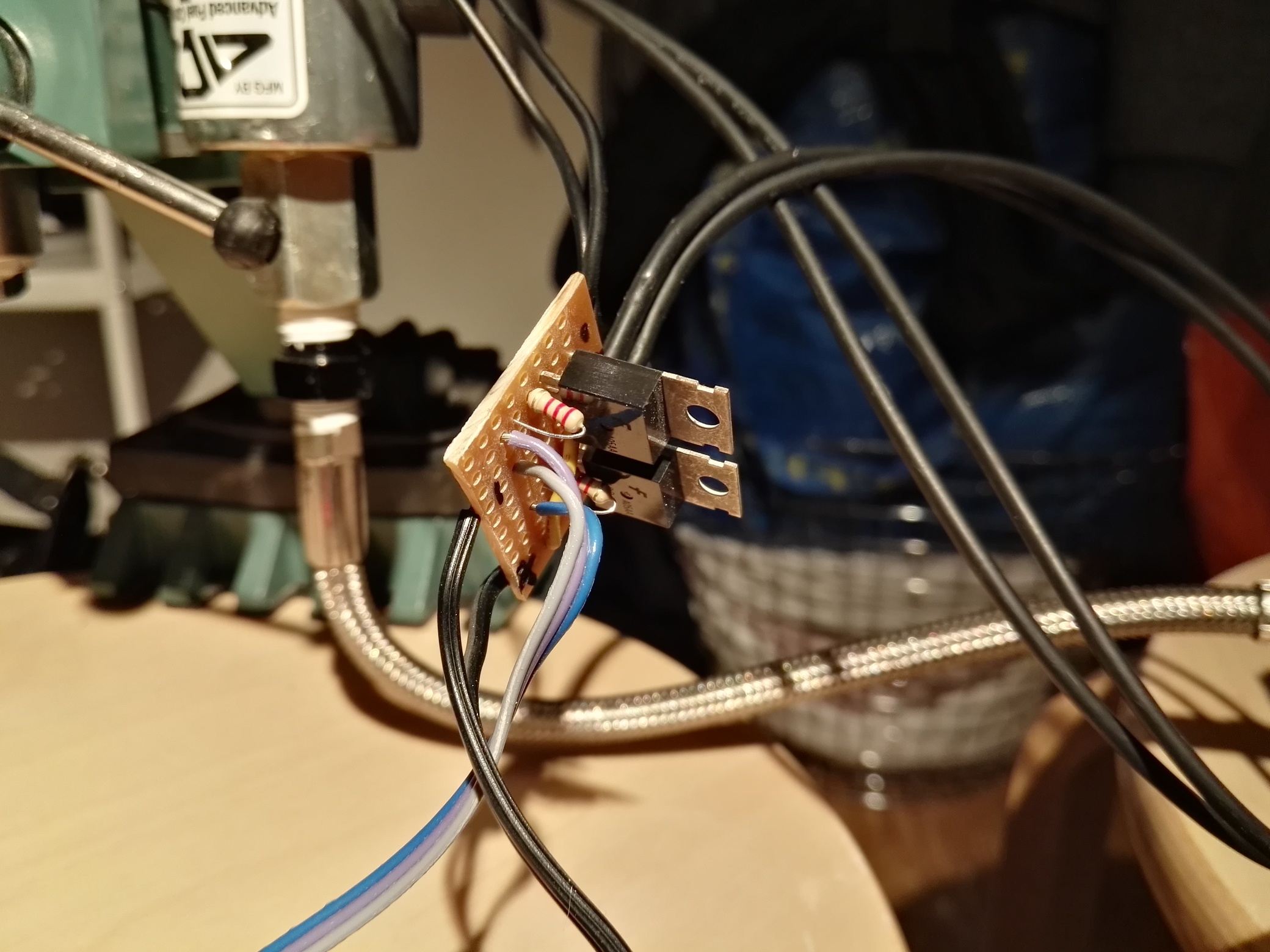

2 channel transistor board.
