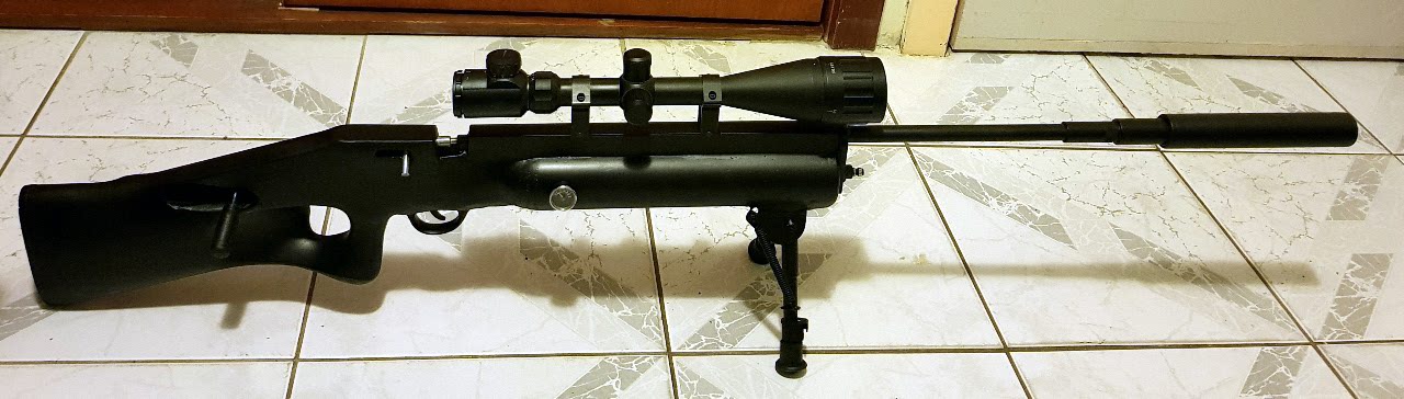

Has anyone had experience with helium instead of HPA? My latest homemade air rifle was already performing pretty well with HPA (38 FPE).
Then I tried helium and it increased to 53 fpe!!!

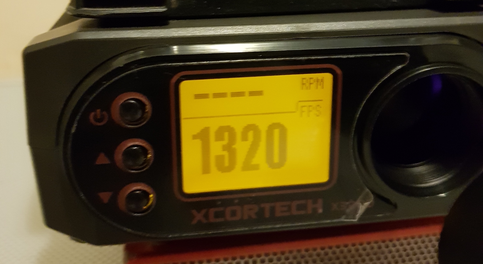

D_Hall wrote:What are your muzzle velocities?
At 2000 psi I'm getting 1150 fps.

Air2theBrain wrote:Chrono pics please :)
How long is your barrel?
Just got 1320 fps when shooting a 19.09gr pellet.
73.88 foot pounds.
24" barrel.

Air2theBrain wrote:Nice..so that fps was achieved with a 2000psi shot of air?
The gauge was sitting on about 2,200 psi of Helium.
That must make quite a crack! Interesting rifle build, I'm guessing it's a home made hammer valve?
