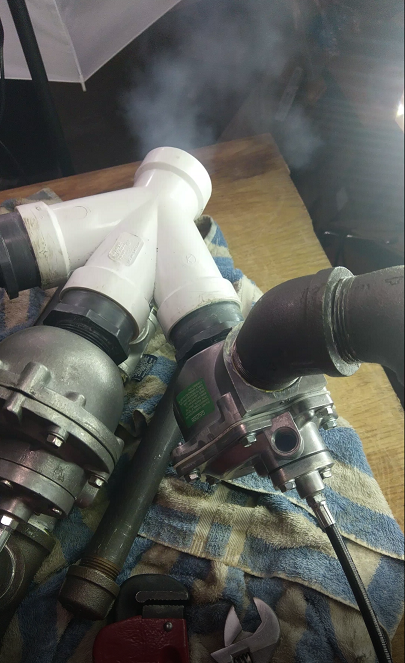

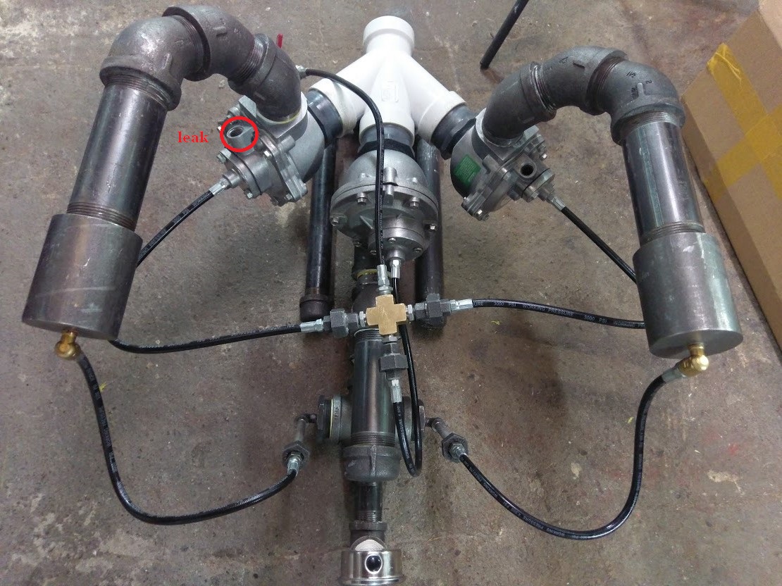

I'm building my cannon with 2 asco valves(1.5 in.) and 1 goyen valve (1.5 in.). Pictures attached:
The 2 hoses coming from the "horns" to the body are just part of the chamber. 3 hoses coming from 1/8 pilot ports of the 3 valves to a tee. One hose comes from the tee to the 1/4 ball valve as the trigger. I have a loud leak coming from the 3/8 exhaust port of the left asco valve (picture) and maybe some other places but right now that spot is the most obvious :cry: . I think the valve is defective but before taking apart or do anything stupid I need the pro's opinions.

Use something like bubble magic with a brush or spray bottle to coat the joints and connections and look for bubbles.
Stopping all the little combined leaks may indeed solve your valve issue. Some valve's will have the tendency to be harder to seal, more so when new. Stopping the leaks may give the extra pressure needed to seal the valve.
Welcome to Spudfiles. :mrgreen:
Looking good, I'm reminded of the Hochdruckpumpe
Sometimes not filling fast enough causes leaks but this would be coming out of the barrel end, I'd wager it's more likely that your diaphragm is damaged or needs cleaning.

So I checked for leaks...Only that spot is my problem. So I opened that one up and the one on the right. I discovered that the leaky one's missing a spring on top of the pilot diaphragm. They both have no spring on the main diaphragm though...I already ordered parts...hopefully that will fix the problem. I'm going to fill the chamber with a pcp pump...Do you guys think it will be good/fast enough to seal my valves.

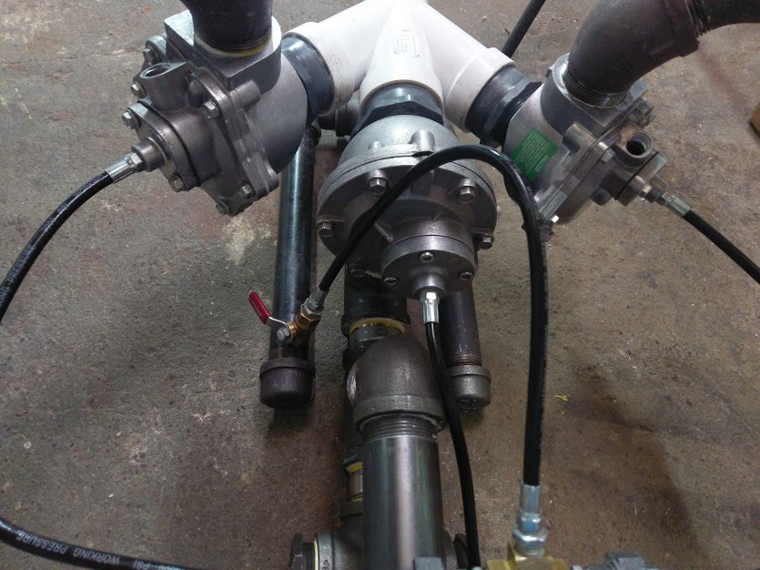

Ok It is now air tight! takes about 80 pumps to get to 50 psi :shock: HOWEVER it does not shoot when triggered :x air goes out through the ball valve instead. Im thinking even if the left asco valve is falty( replacement springs are stiffer than original springs) as long as the system is air tight the other 2 should still shoot, correct? The asco model is flex kleen M28244 and goyen is RCA45T which everyone uses and I don't see a problem with the set up. Waiting for everyone's opinions.

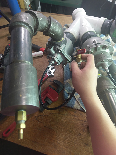

Yes I order another asco M28244 on amazon for $30. I took the 2 springs and valves from this new valve and put them in the faulty left valve on the build. When triggered, air goes straight out of the ball valve! All tests done at around 60-70 psi...that's a lot of pumping :bounce: The 2 good valves did not open either. I even opened up all of them to look at but nothing seemed wrong. My last chance is to probably take each of them apart to test separately which is a pain and I should have done from the beginning before putting them together but I can't see what unique difference that makes compared to original 3 valve setup. What you guys think?
I think you need a upgraded piloting system to do the task your asking of it. A stronger one. Higher pressure on the piloting side how ever you can make that happen. Increasing the flow rate through larger porting on the pilot would also help.
Keep at it, you're making something that the engineers of the valves never intended them to do X 3.

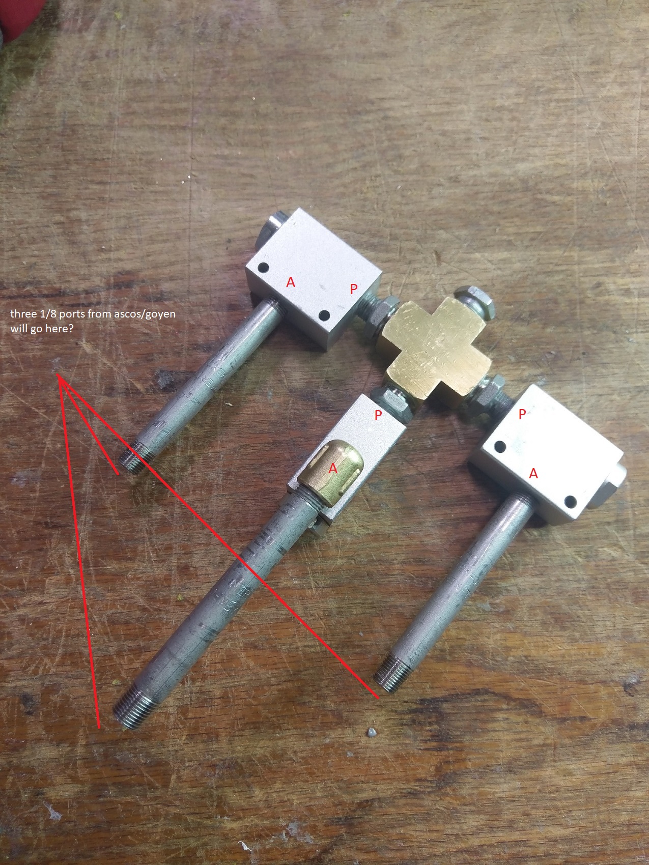

I think jrrdw is right. My pilot seems to be the problem...bad flow probably. So what do you guys think I should do to pilot? a 1" sprinkler valve? or this:
The problem with this new setup I see after digging around the forum is the QEVs can't be filled from A without some sort of modding. That means I cannot exhaust through P if my pilot air comes though A...? These are 1/8 QEVs, will the quck release I get from them compensate the bad flow?
