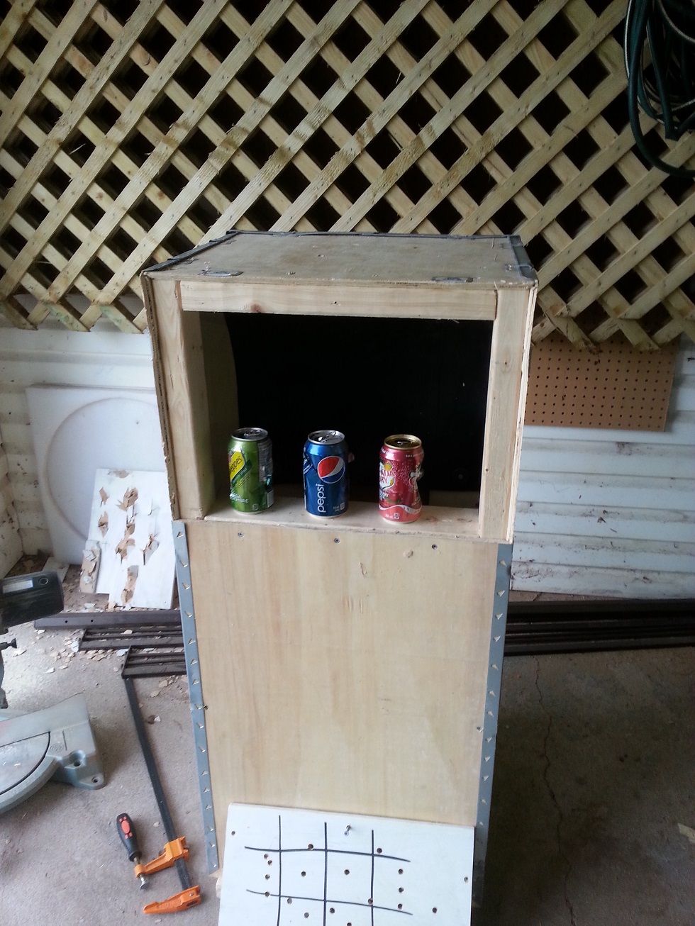

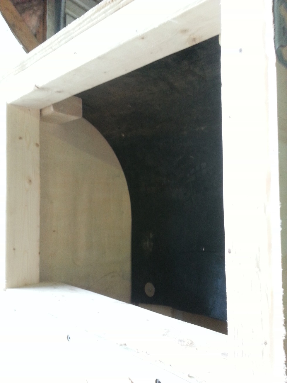

Steel balls are bouncy, my target has a thick piece of rubber at the back to absorb the energy and points them downward so I can collect them.

I have to make something similar, to shoot inside my little workshop, although I am shooting with this to "lost ammunition". Do not bounce your steel balls? I shoot a can of soup and back I have a cardboard box with 30 cm of compacted newspaper. There I pick them up and they can not bounce like that.
