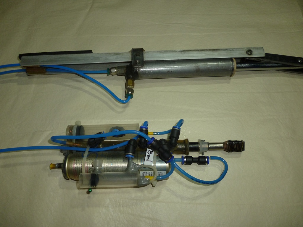

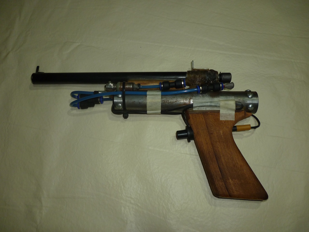

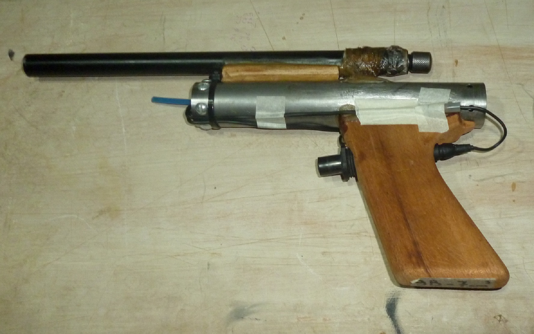

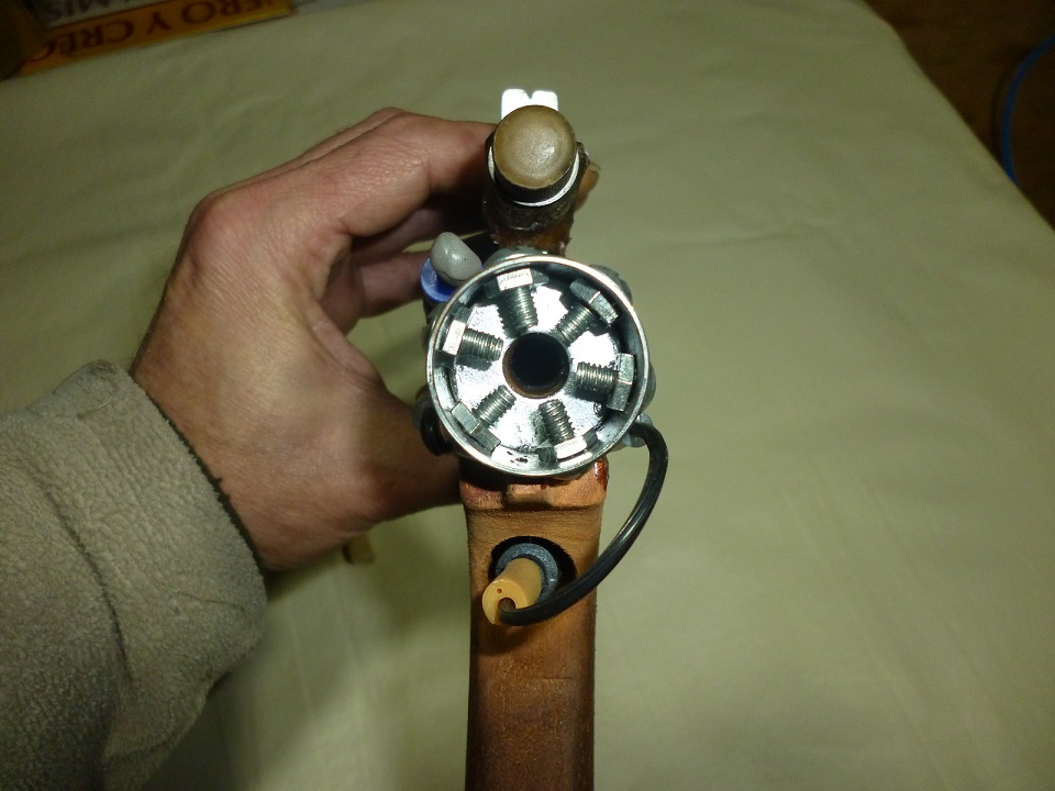

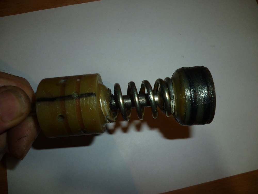

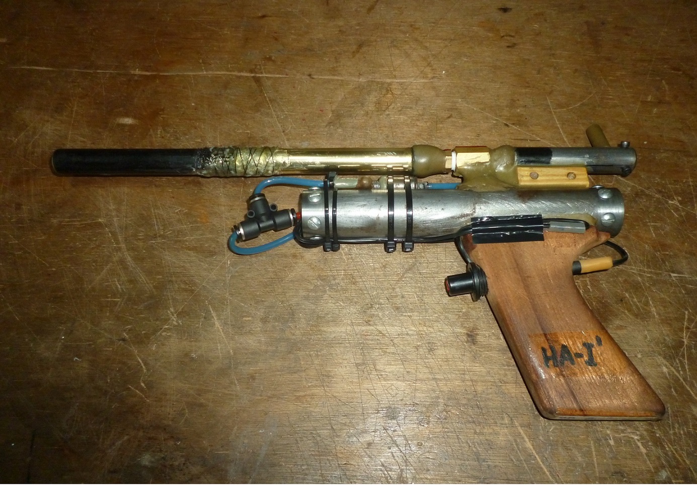

I am testing this small 7X hybrid that shoots 1/4 "steel spheres, it has the new hybrid system, with a spring, I have also finished the charging station with the new gas rapid doser design. I have to make the corresponding video to share it. The only thing I found unpleasant is the damn bounce of these steel balls on certain hard surfaces .... :x

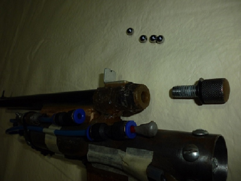

The firing barrel is a brass tube and the barrel bore is smooth, made of resin, and lubricated with a little bit of graphite. It has two connectors, one to decompress the combustion chamber and the other to load the mixture through the check valve seen in the photographs.

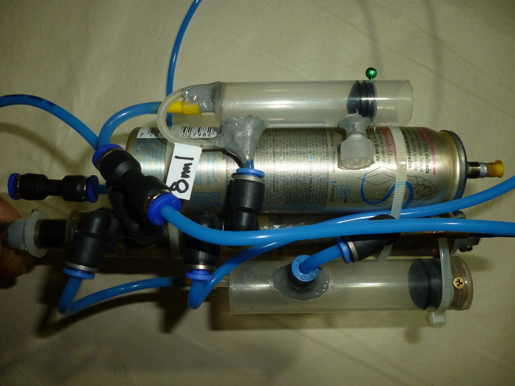

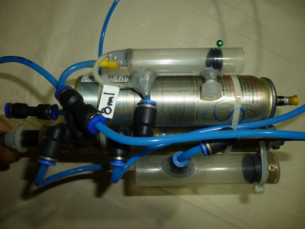

The charging station consists of this air pump and a liquid butane tank, the 8 ml dosing device, the gaseous phase tank, and the 6-way valve and two positions. It works like a clock and the shots are totally the same. It was impossible to cough this into the little gun so I set it aside. The mix loading system works for all my weapons. Only the syringe dispenser is replaced.
The ammunition fits tightly in the barrel. It is loaded from the back removing the screw that can be seen in one of the photographs.
The regulatory video is pending. :bounce:

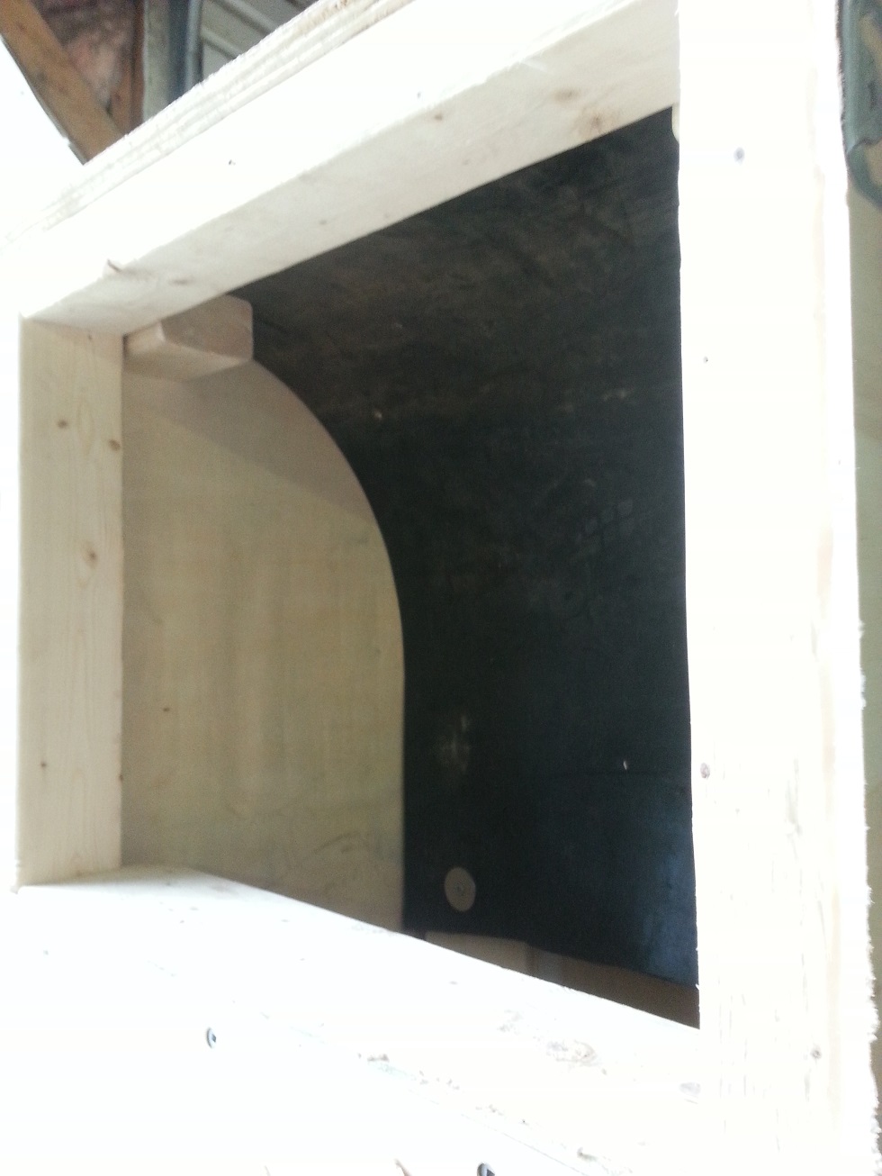

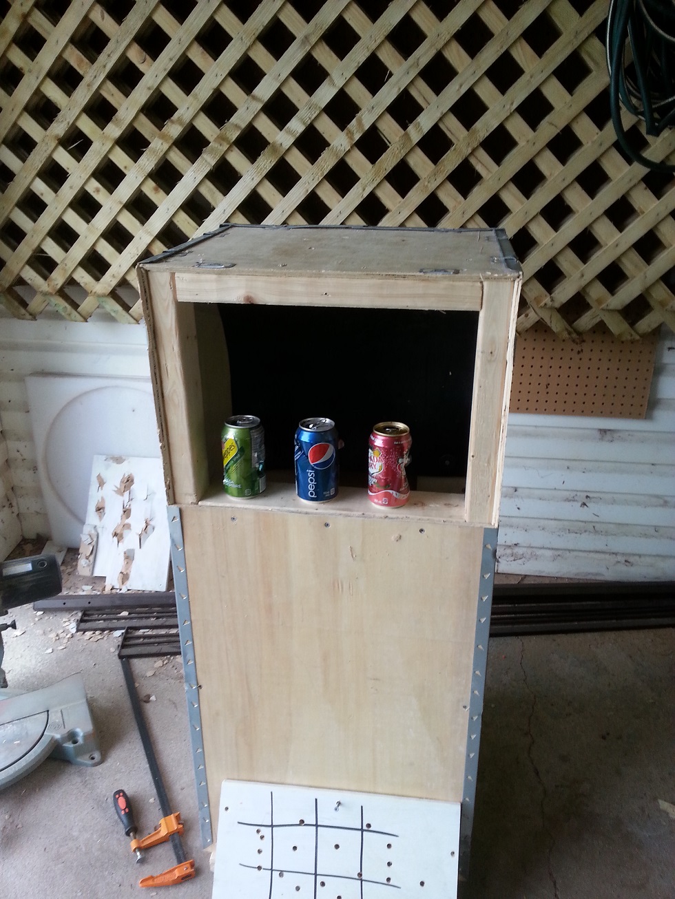

Steel balls are bouncy, my target has a thick piece of rubber at the back to absorb the energy and points them downward so I can collect them.

I have to make something similar, to shoot inside my little workshop, although I am shooting with this to "lost ammunition". Do not bounce your steel balls? I shoot a can of soup and back I have a cardboard box with 30 cm of compacted newspaper. There I pick them up and they can not bounce like that.

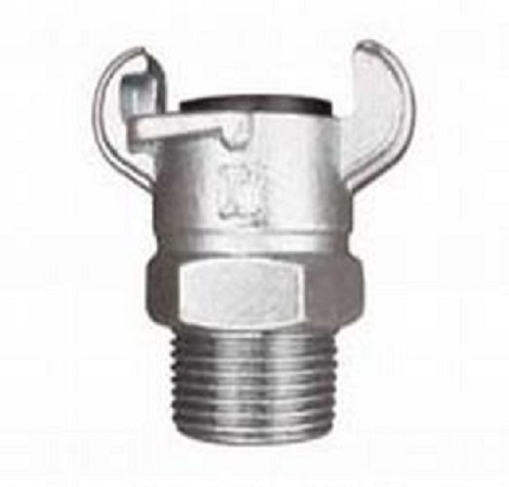

I was considering for a later version and more "neat" termination, using a half-turn coupling.
acople-rapido-media-vuelta-americano-hierro-34-um075-D_NQ_NP_770247-MLA26576774467_122017-F.jpg
acople-rapido-media-vuelta-americano-hierro-34-um075-D_NQ_NP_770247-MLA26576774467_122017-F.jpg (29.04 KiB) Viewed 17608 times
That works too :) or a traditional bolt action...

I'm going to buy one and try it. I imagine that having a longitudinal displacement guide for the firing barrel and a grip perpendicular to this would be similar to a bolt but easier to build :roll:

Shot test. A video shot, both are very short. In the second, you see the spray that was the target.
It is charged with 9 pumps of the air pump and needs 8 cm3 of gas.
It is not seen very well in the videos, (in one hand the camera and in the other the gun), but it sounds strong. Bad luck for the neighbors, (and for me, when my wife arrives). :( :D
The length of the firing barrel, the useful section, is about 6 "The ammunition seals completely everything, and this causes the pressure peak to be achieved, I did not try to give it more gas and more air pressure, because the shock absorber tube Recycled that I used to build the combustion chamber does not reach 1 mm in thickness ... I shot it with 7X but interposing high impact acrylic between my face and the weapon.
