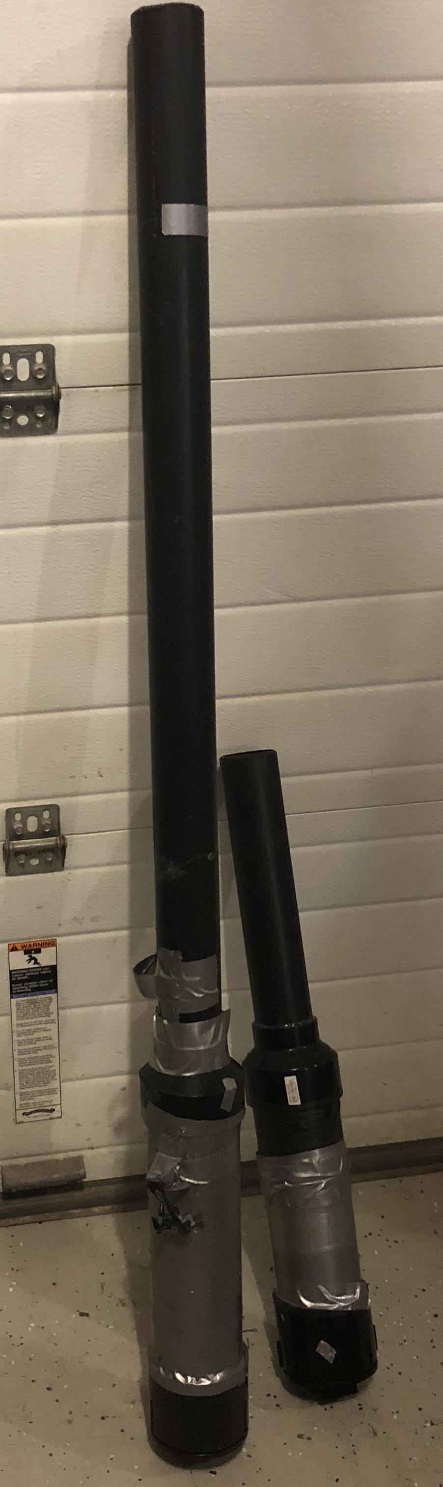

Ok here’s a picture of my first 2 potato cannons. The big one was my first one the small one was my second. They’re both solid core abs. I get my abs from home hardware, Home Depot where I live only has cellular core abs for some reason.

The tape on the chambers is for grip.

Primitive but still fun :) what's your ignition like and are you metering your fuel in some way?

My ignition is two small nails and the piezoelectric thing from a bbq lighter. They work pretty well and I use hairspray or deodorant in them. If anyone knows of a better fuel let me know.

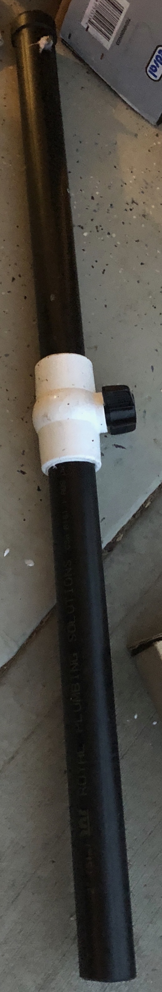

Ok here is a picture. I’m waiting for the cement to set (transition cement). The only reason I built it with ABS is because I had some scrap. I know that abs isn’t the best for pneumatics but if it fails it ruptures and I could probably salvage the valve with a saw and a core drill bit (or whatever it’s called). This is solid core abs by the way. I used the valve from some scrap inner tube and drilled a hole in the chamber that was smaller than the valve, then I put the valve into my drill and held it to the hole and turned on my drill. Because of the rubber on the valve it fit perfectly. I added a ton of hot glue just to be safe.

So the ball valve is the trigger? They work really well when spring loaded, then you can have a better trigger :idea:

I was actually trying to figure out how to spring load it. What I have done to make it easier to turn (haven’t got around to firing it yet) is I put a thin layer of Vaseline in the ball valve and that seems to help a little.

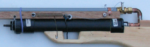

You'll need to make some kind of linkage. Attach a spring to the valve handle somehow, maybe need to extend the handle? then someway of locking and releasing the handle or spring.
This is one I made but it did get complicated
