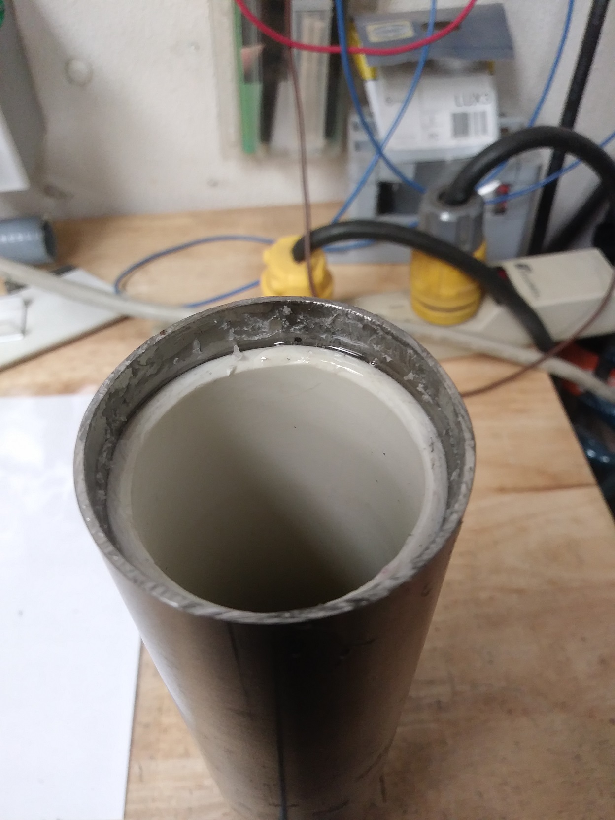

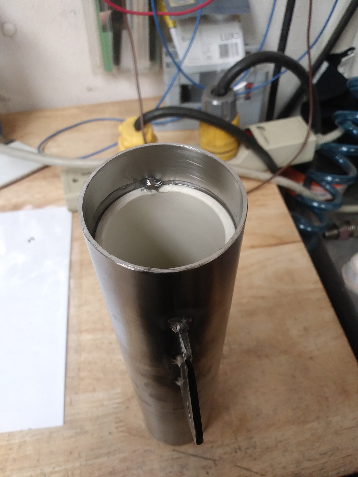

Starting a post for my 40mm lancher, planned ammo is foam balls (practice golf balls) Got a few parts assembled, waiting for a 1/2" QEV off Ebay.
Just going for straight layout to prove it works
Main - Copy.jpg (27.73 KiB) Viewed 10532 times
PVC pressed in with a bit of epoxy as well and a M4 screw as a stop.

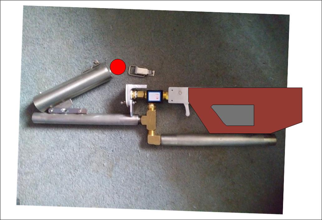

A new layout that will allow for a stock :idea: dropped the second chamber. Need the QEV to get final measurements. :?
Main 3.jpg (32.33 KiB) Viewed 10259 times

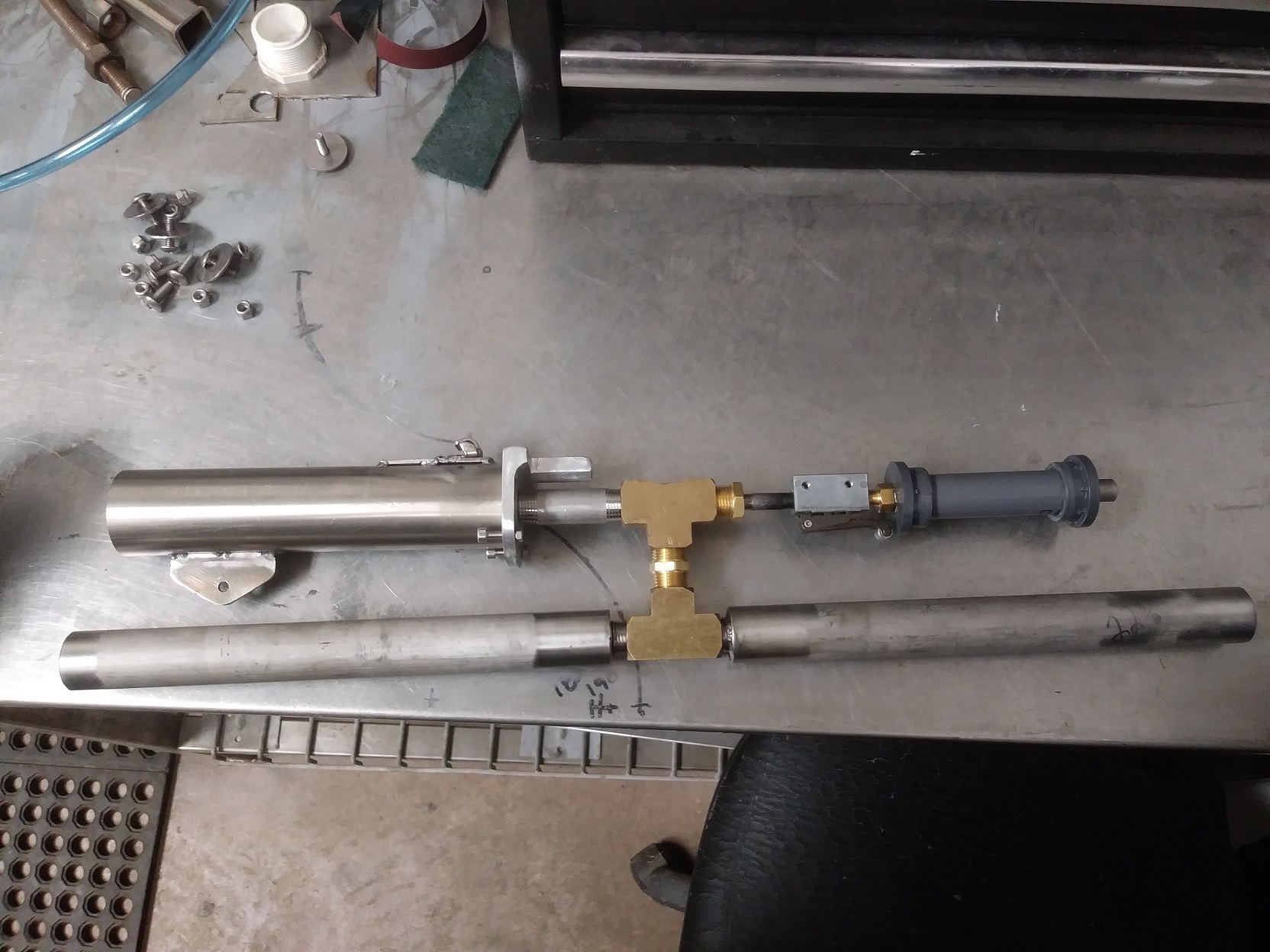

Got the QEV, let the building commence :D

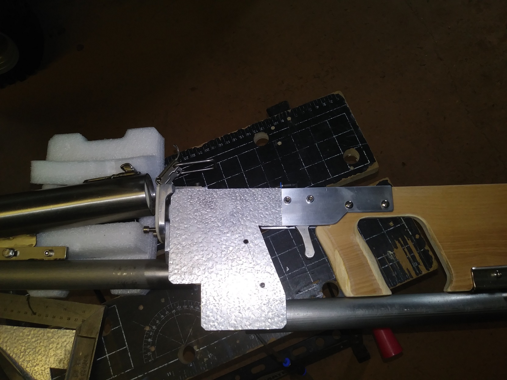

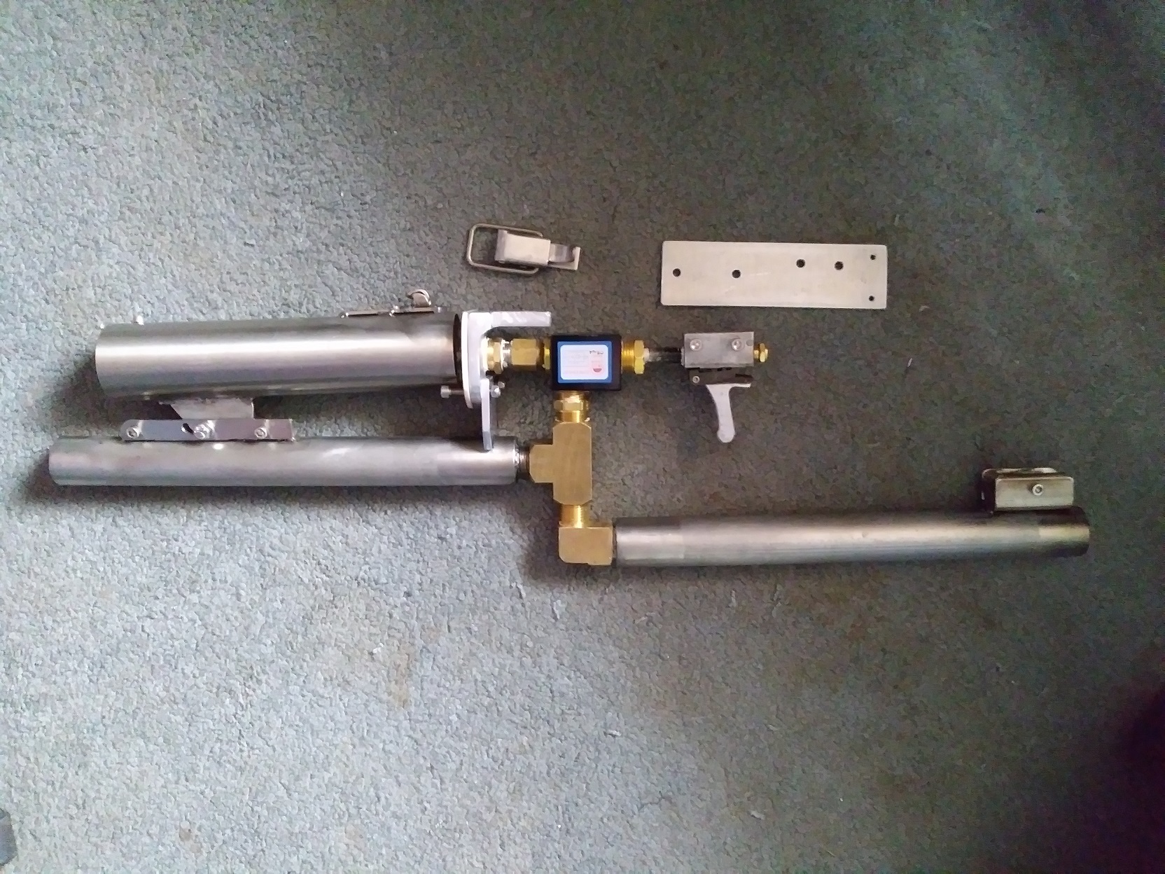

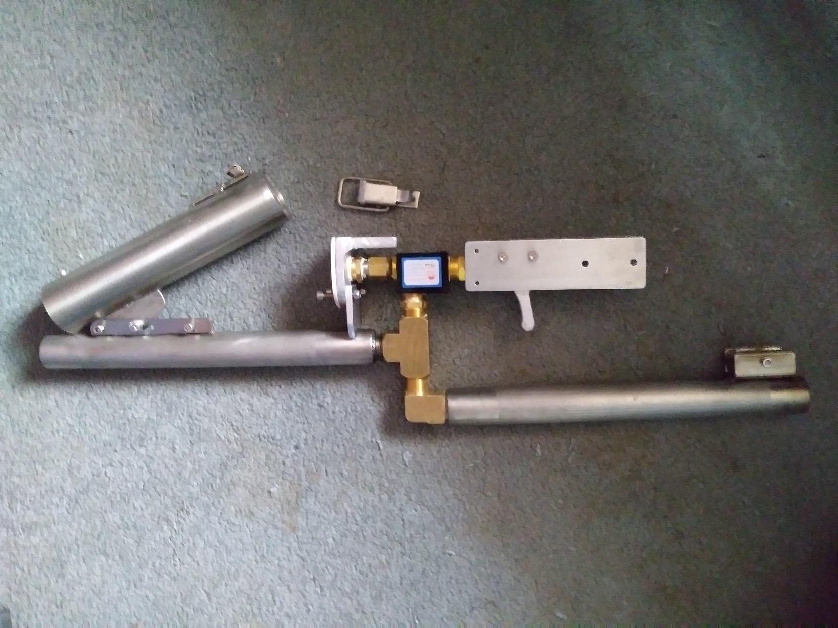

Main components finished ready for assembly, stock/grip made from 3/4" plywood will attach to brackets.

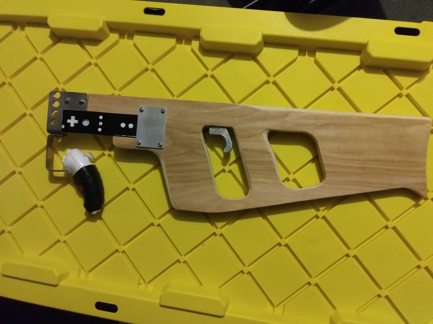

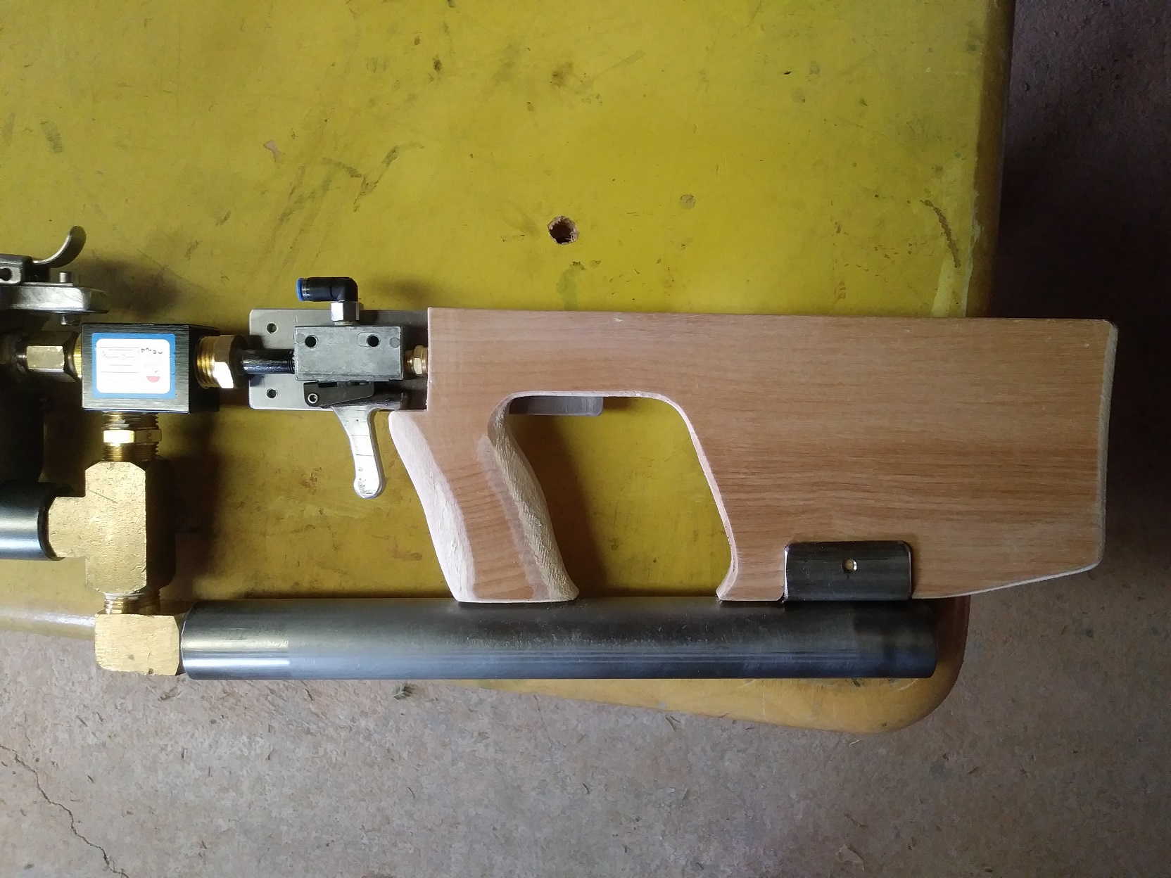

First fitting of the stock, it is actually the MkI Wii light gun stock that I kept just in case, fits perfectly, just need to reshape the top aluminium brackets.
MkII Wii gun

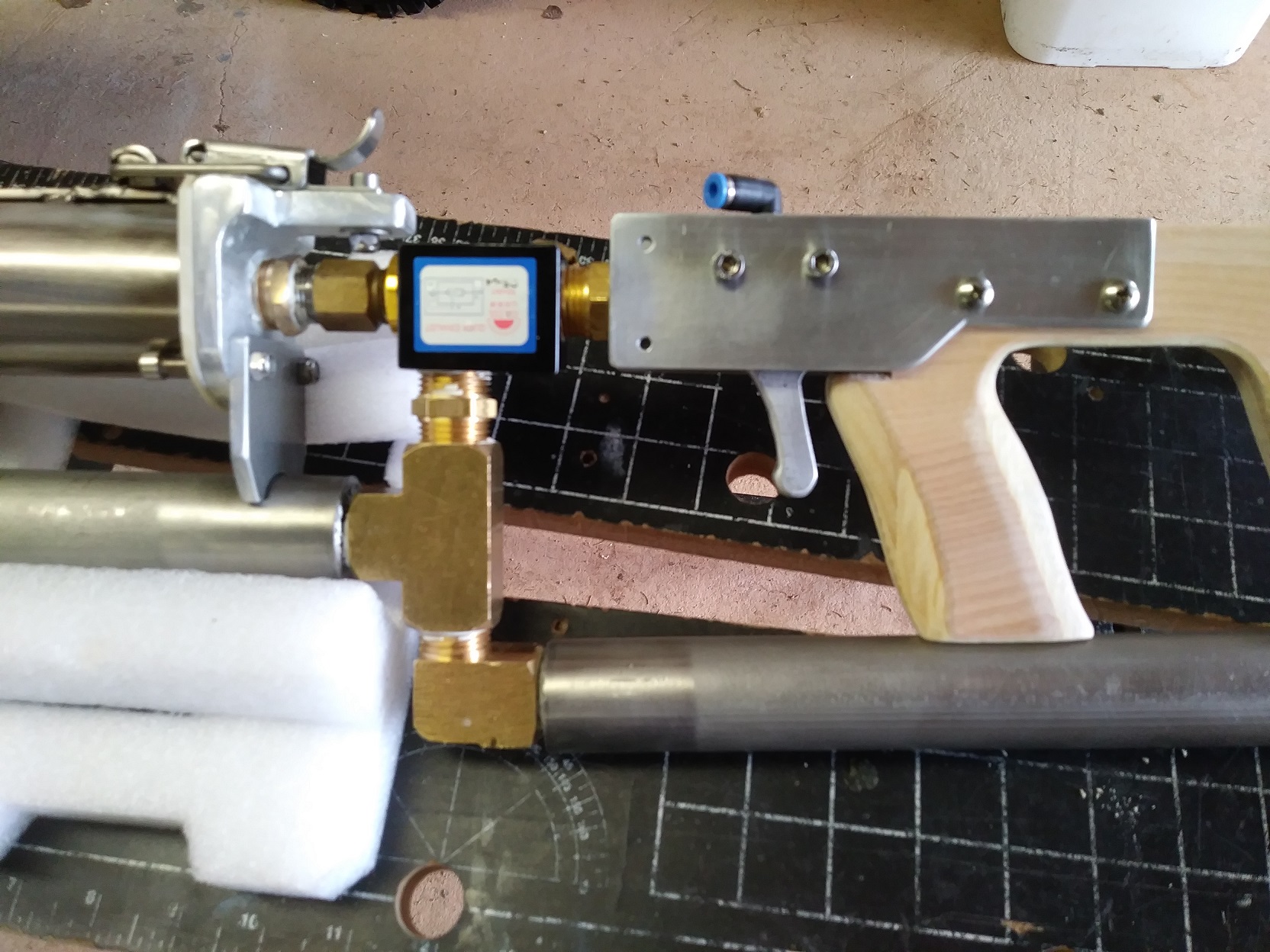

Stock fitted, going to make some side plates to cover the QEV.
Dry fire at 150psi, a good puff of vapor? fired a dimpled foam golf ball, went over the house, probably 200 feet.

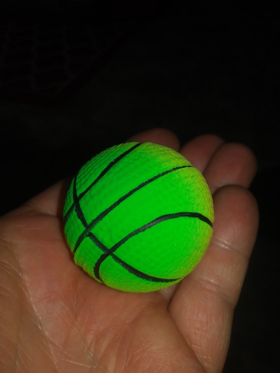

A new ammo to try, hard rubber bouncy ball, $0.50 form the local Dollar store :o Same size as the practice golf balls.
These dimpled ones will go 200'
