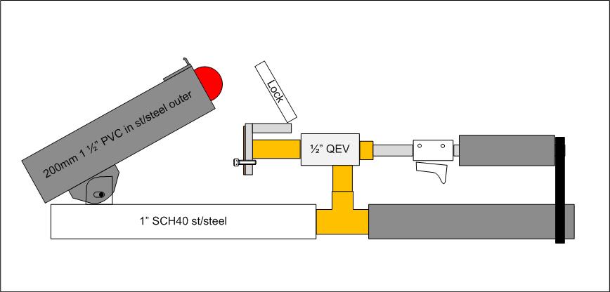

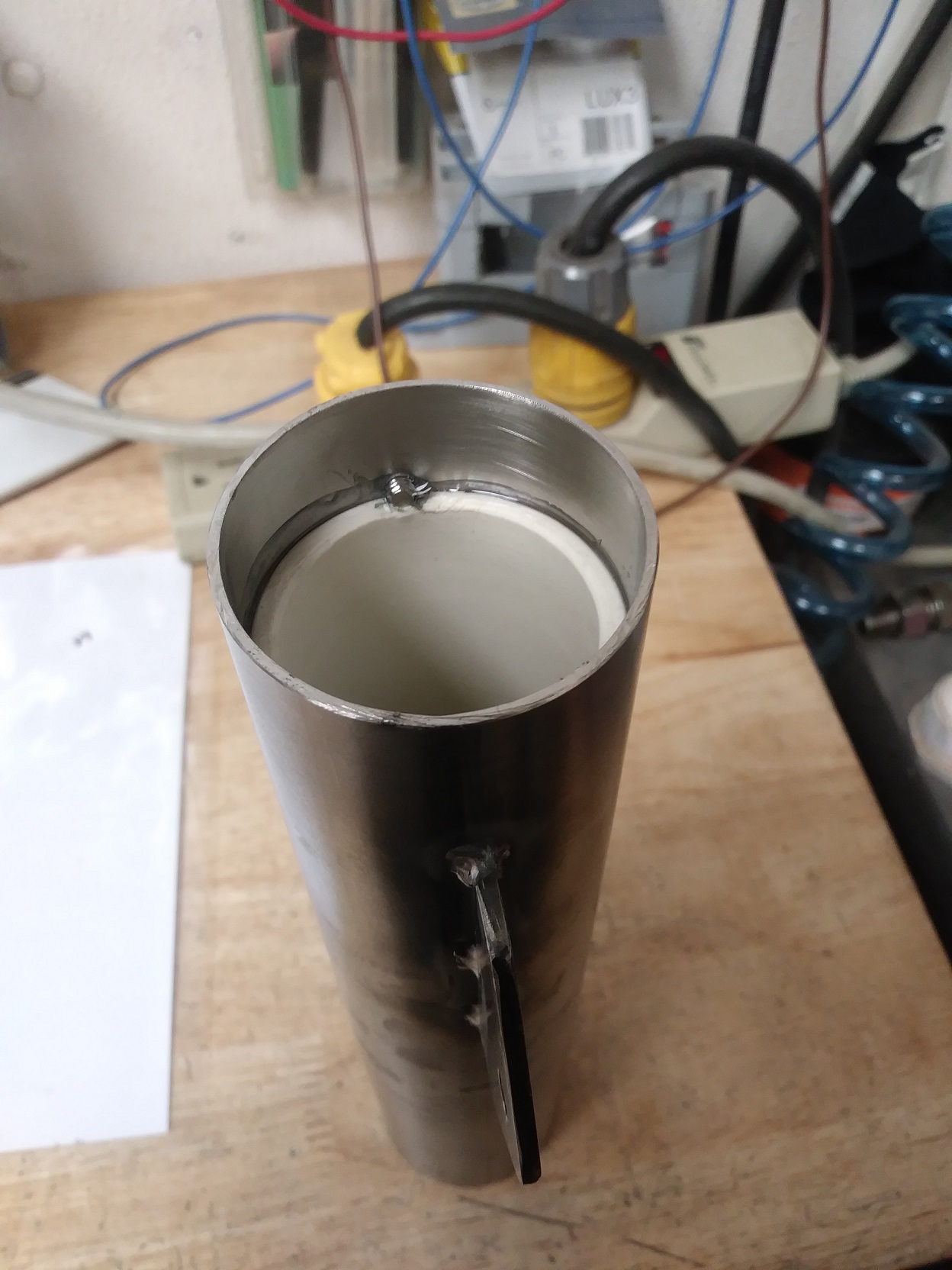

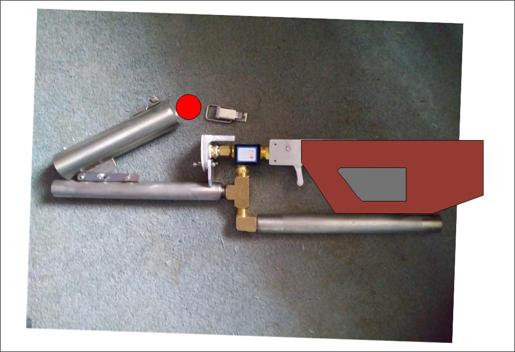

Starting a post for my 40mm lancher, planned ammo is foam balls (practice golf balls) Got a few parts assembled, waiting for a 1/2" QEV off Ebay.
Just going for straight layout to prove it works
Main - Copy.jpg (27.73 KiB) Viewed 10530 times

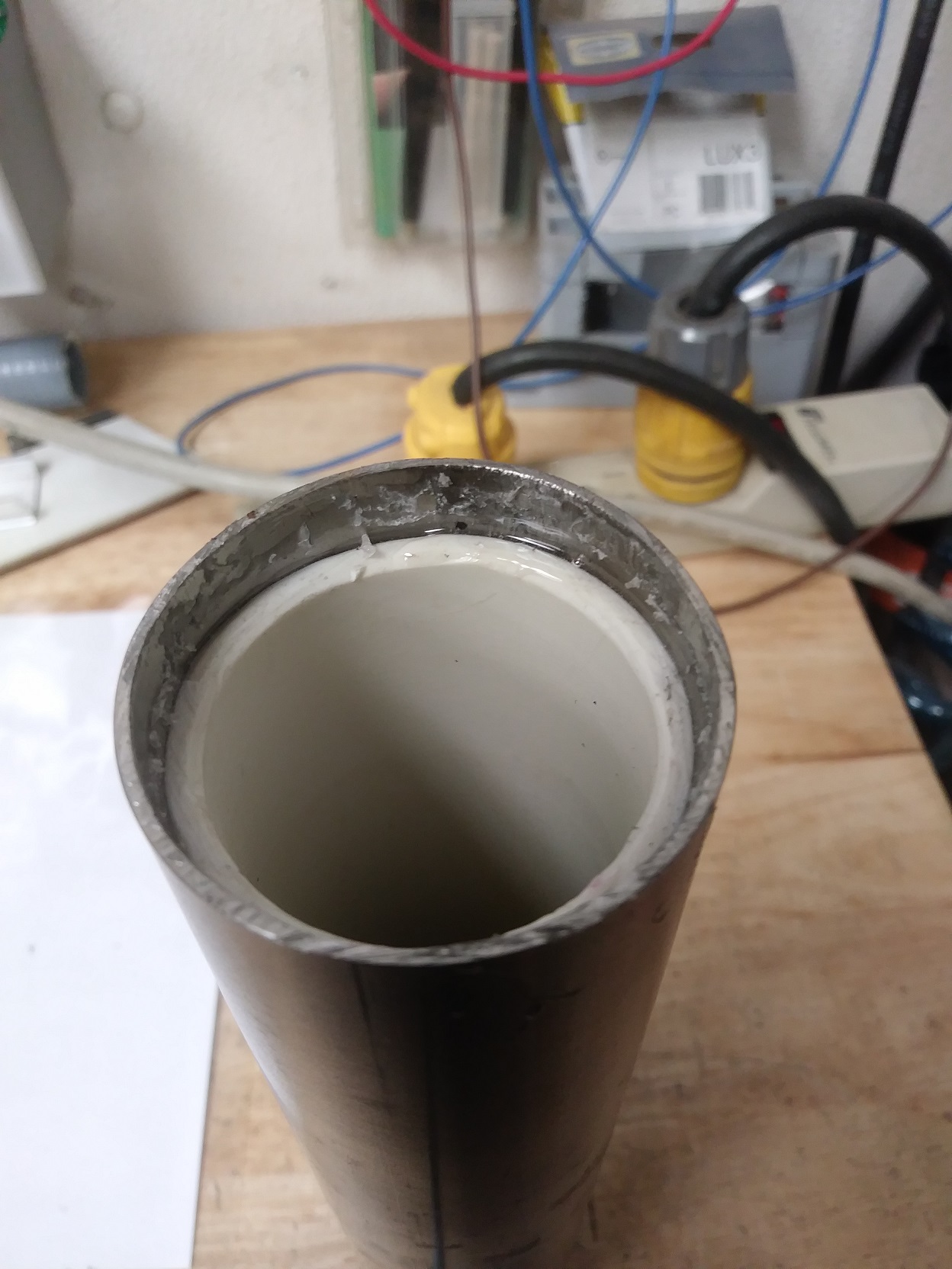

PVC pressed in with a bit of epoxy as well and a M4 screw as a stop.

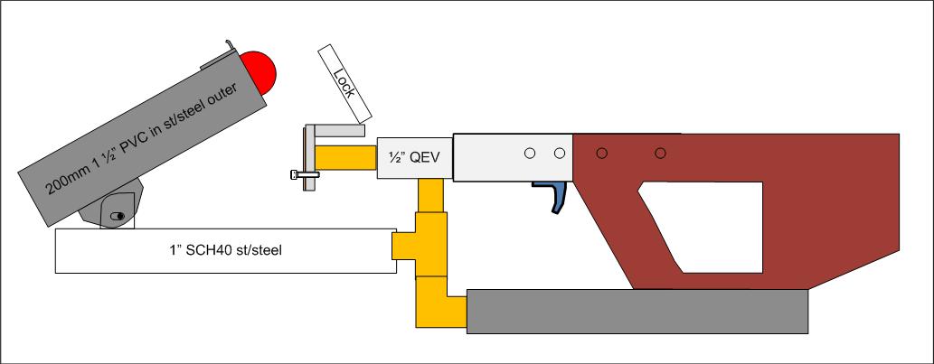

A new layout that will allow for a stock :idea: dropped the second chamber. Need the QEV to get final measurements. :?
Main 3.jpg (32.33 KiB) Viewed 10257 times

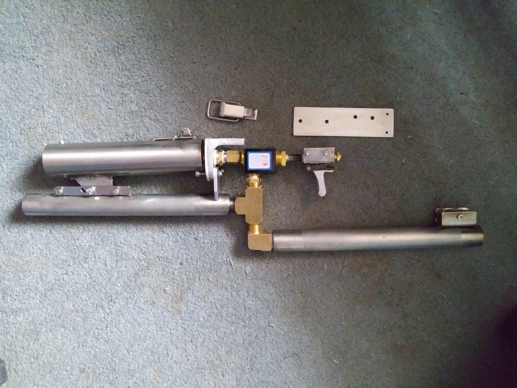

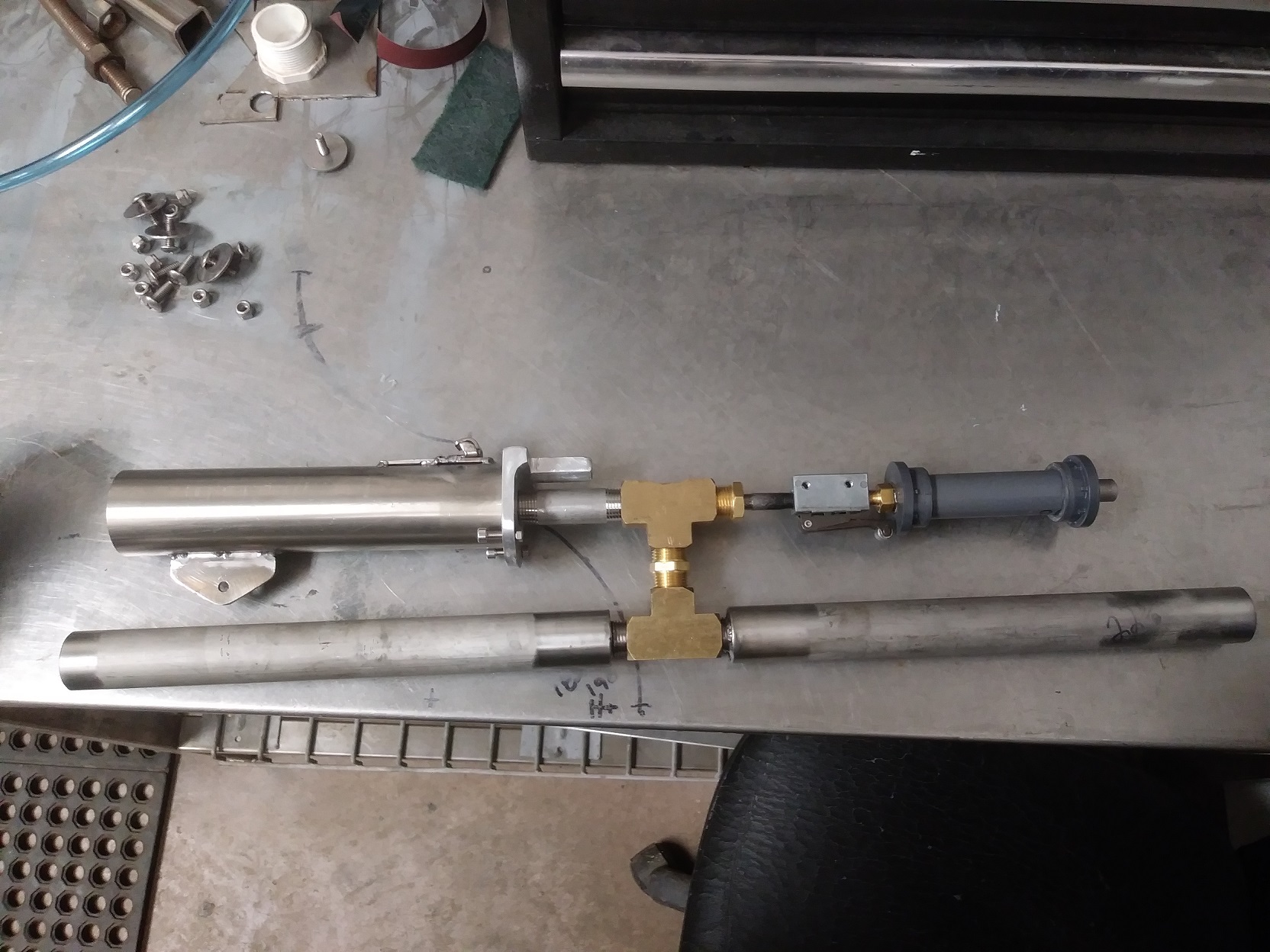

Got the QEV, let the building commence :D
farcticox1
Canada
Posts: 1088
Has thanked: 69 times
Been thanked: 103 times

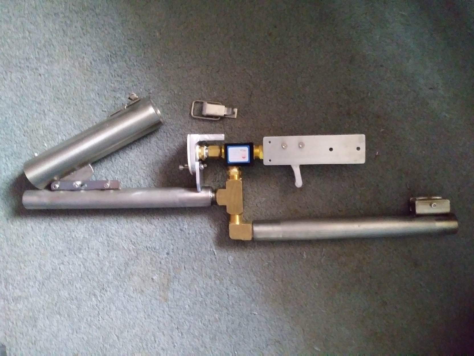

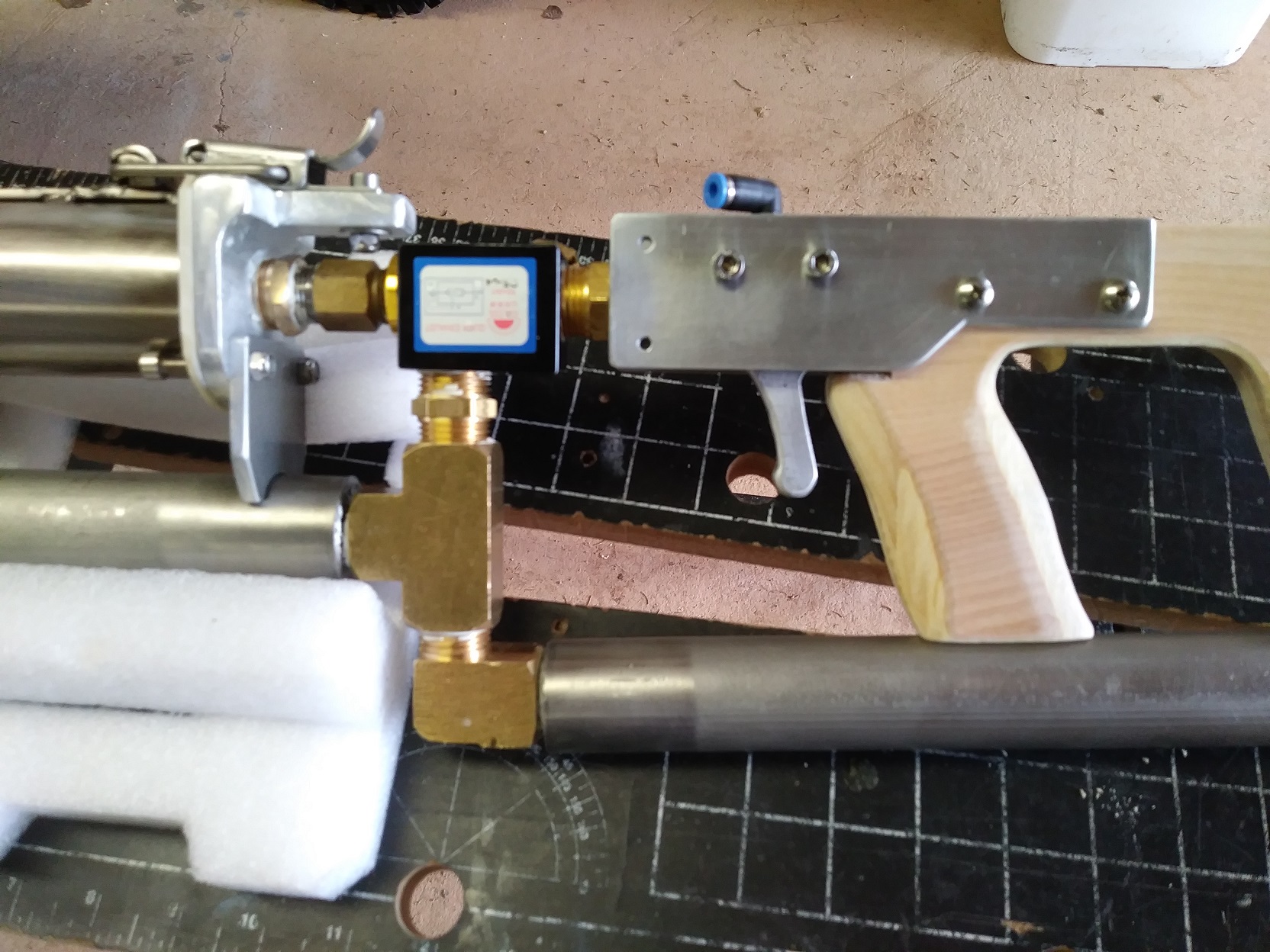

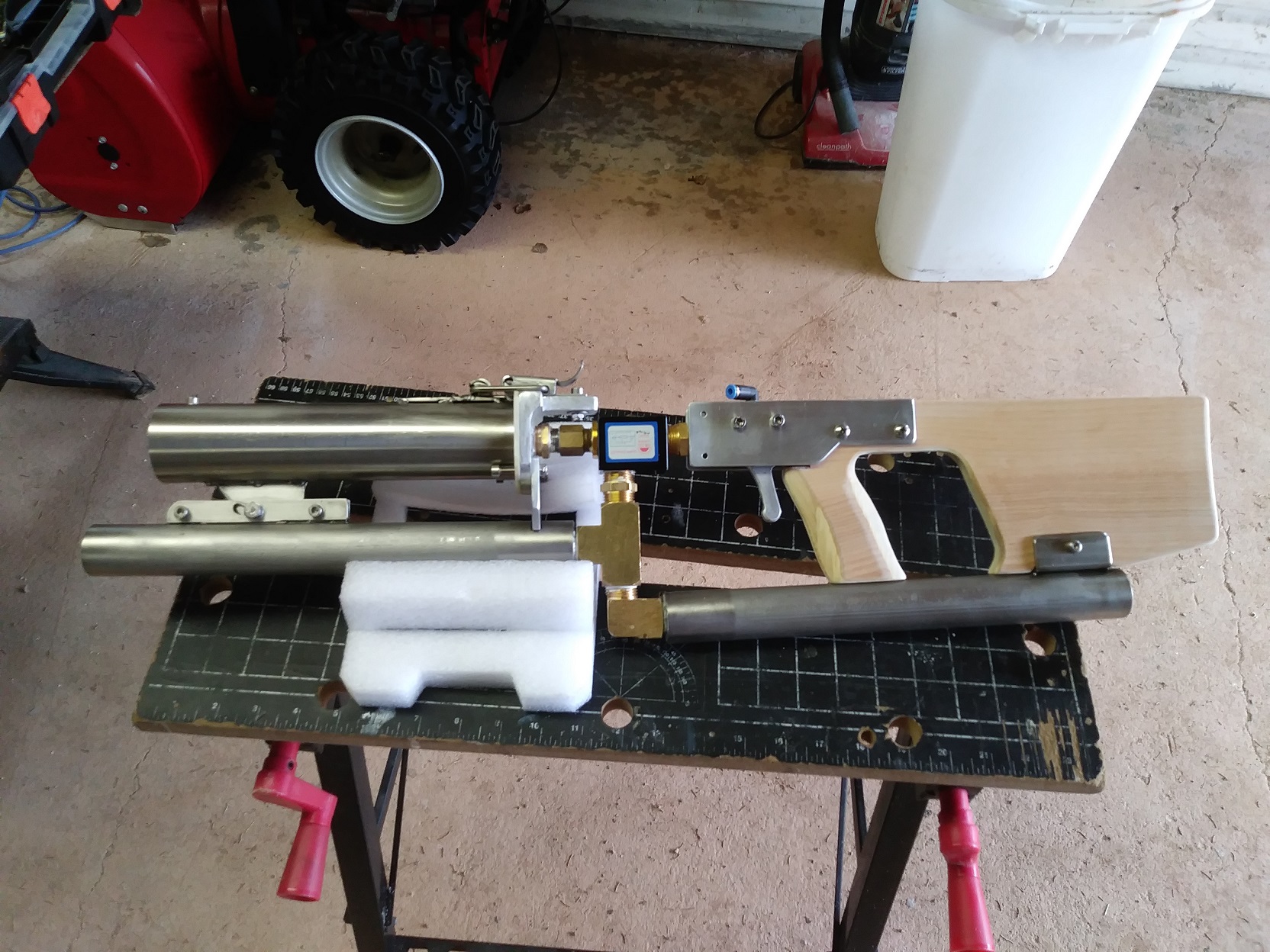

Main components finished ready for assembly, stock/grip made from 3/4" plywood will attach to brackets.

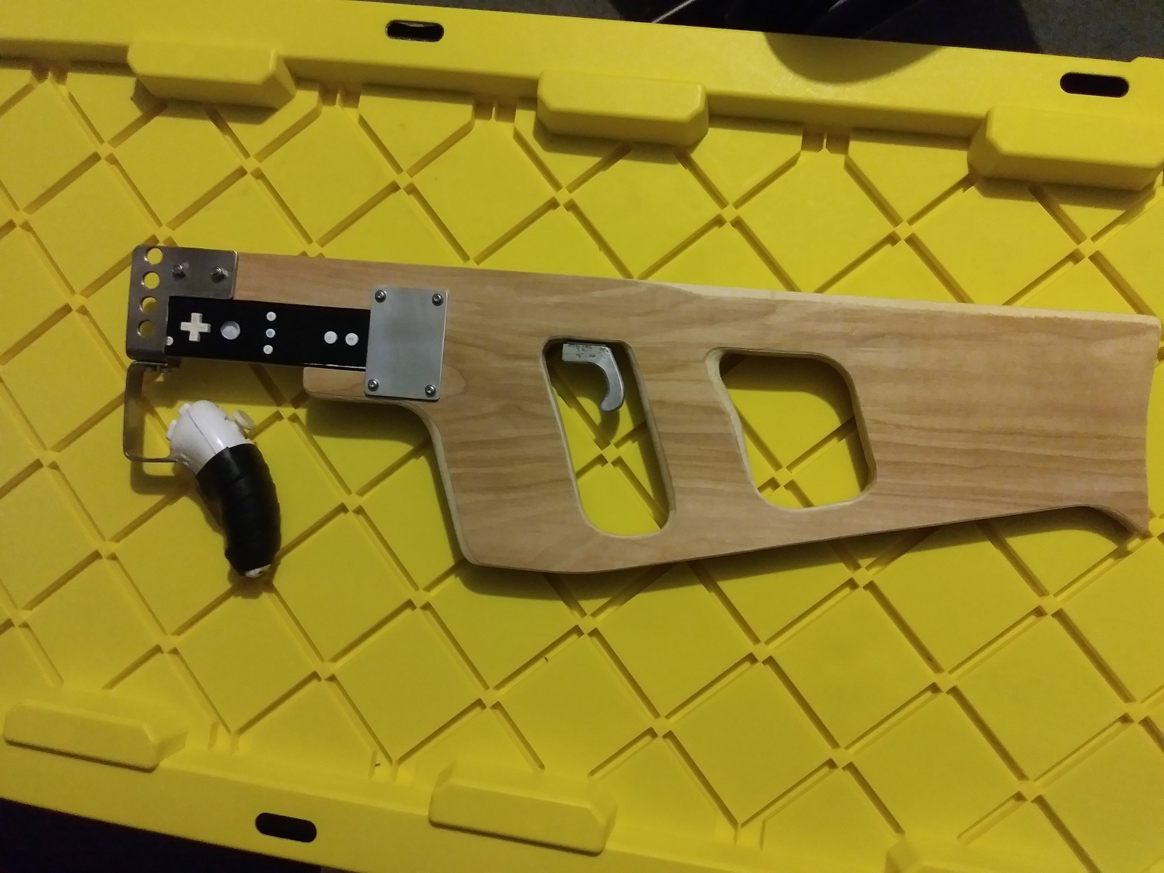

First fitting of the stock, it is actually the MkI Wii light gun stock that I kept just in case, fits perfectly, just need to reshape the top aluminium brackets.
MkII Wii gun
Moonbogg
Posts: 1742
Location: SoCal
Has thanked: 169 times
Been thanked: 104 times
This is looking pretty nice. Looks like a fun little launcher. I really love the break barrel design and locking mechanism, plus it seals which is not always easy to do. Foam golf balls are a good idea as well if using around the house like you have shown. Good stuff. Looking forward to some slightly higher pressure testing perhaps...

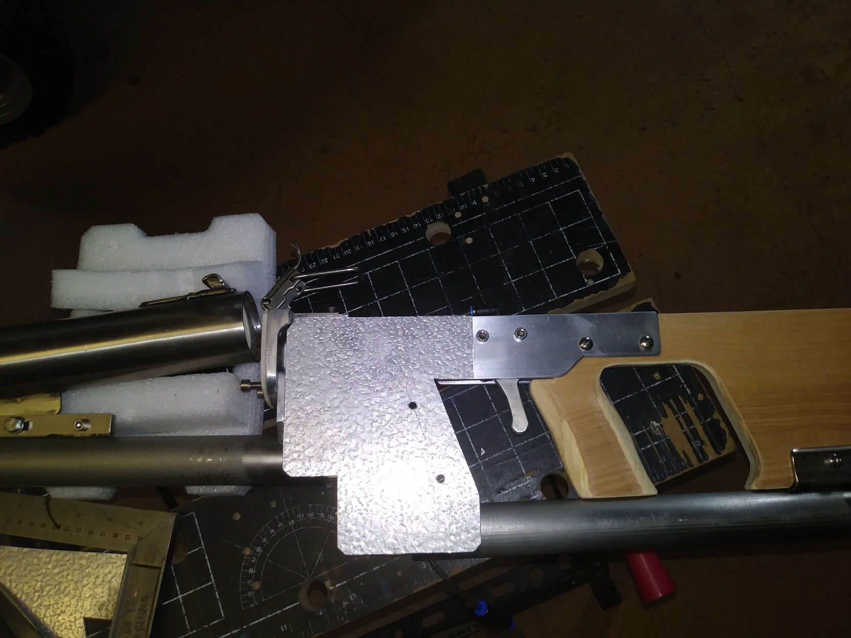

Stock fitted, going to make some side plates to cover the QEV.
Dry fire at 150psi, a good puff of vapor? fired a dimpled foam golf ball, went over the house, probably 200 feet.

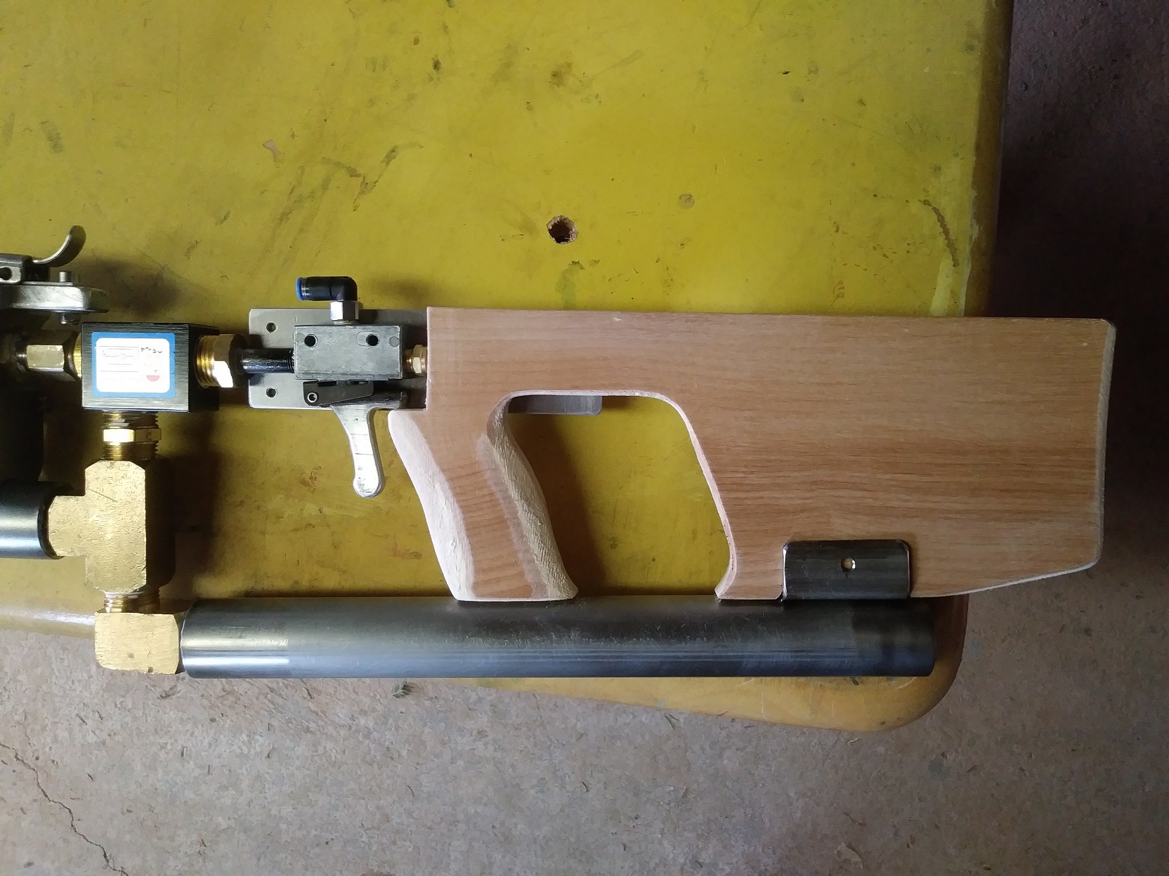

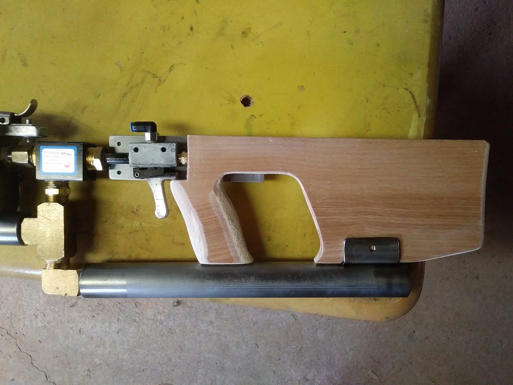

First fitting of side plate

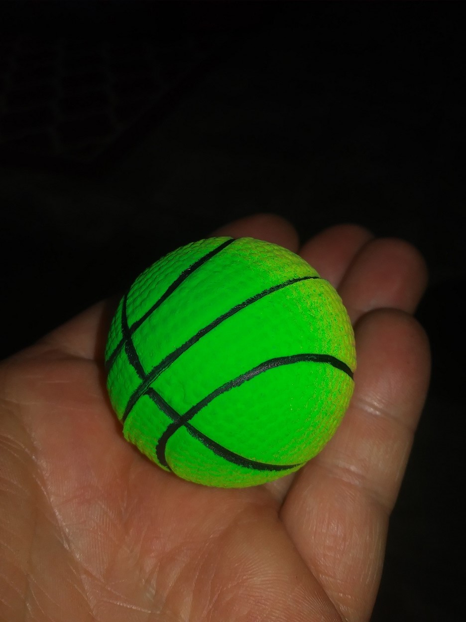

A new ammo to try, hard rubber bouncy ball, $0.50 form the local Dollar store :o Same size as the practice golf balls.
These dimpled ones will go 200'
