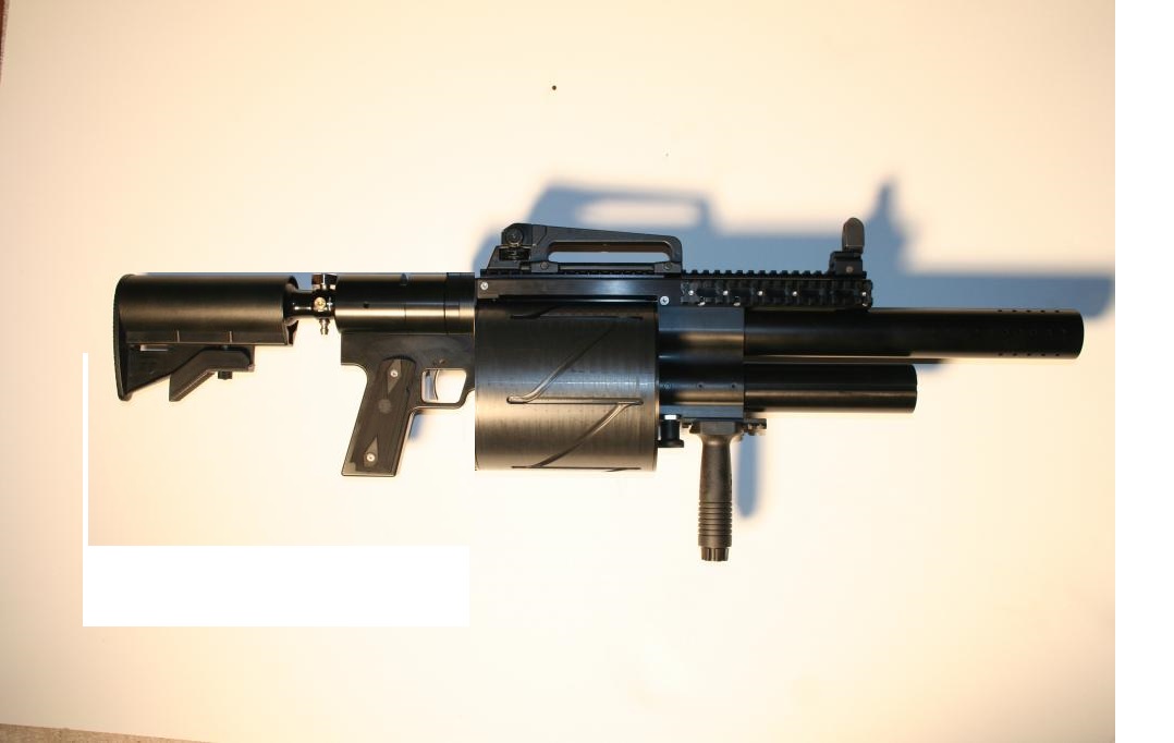

New cover for indexing mechanism, new trigger valve, trigger and mechanical safety. Increased flow from source tank, increased size of slide to accommodate indexing mechanism mount. Lots of new rails to mount handle, front sight, leaf sight, sling mount, etc.
Variable velocity with four indexed settings. Constant pressure.
10 pounds without tank. Will be working on lighter cam and fluting to reduce weight next.
Production parts being racked to anodize today.
*fap fap fap fap*

Just mounted a quadrant sight to the Ar style handle. It fits great but it has an offset angle to compensate for rifling drift. I am ordering a Knight's Armament leaf sight to mount in front of the handle. I might also mount an optical quadrant on the side rail. Lots of possibilities now. Perhaps a quadrant EoTech eventually.

It places the target in the proper position when the launcher is held against the chest. This is common with entry teams who maintain their body perpendicular to the launcher for more effective use of body armor.
The form is following the function regarding the over-under layout. A customer requested the handle and the front sight matches it.

Actually the velocity of that shot and the weight is within less-lethal ranges. The Eclipse is designed with a variable velocity selector above the pistol grip that has four power settings. We will be adding a range finder to automatically control velocity but for now it is done manually. Our target range is over twice this with a half pound projectile. This shot was fired at only around 300 psi with a small ballast. We have acheived 225 fps with a 150 gram projectile at around 400psi. Of course the heavy rounds will be for other payloads besides direct impact kinetic energy rounds.
