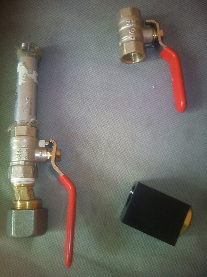

Hi! i Want to make airgun i have qev valve and some pipes and air chamber , can someone instruct me how to make airgun with this items>

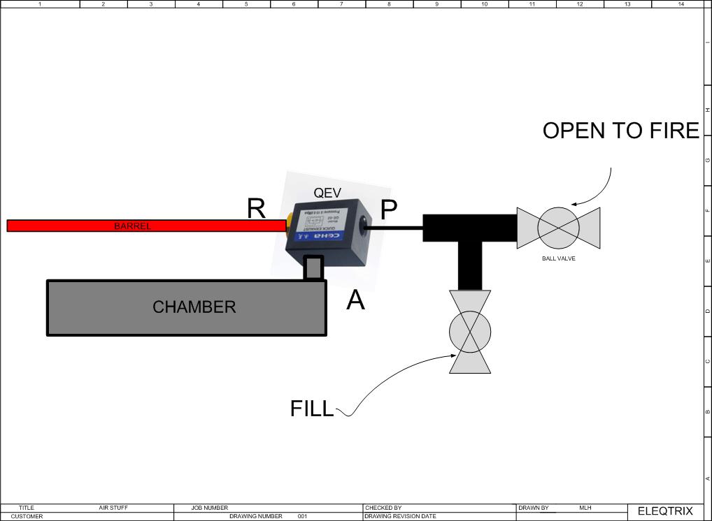

Or something like this :idea: What is the barrel and air source :?:

i will try that

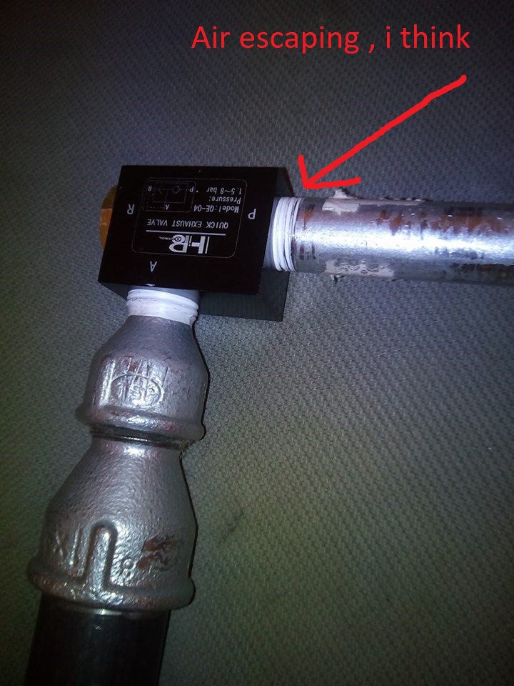

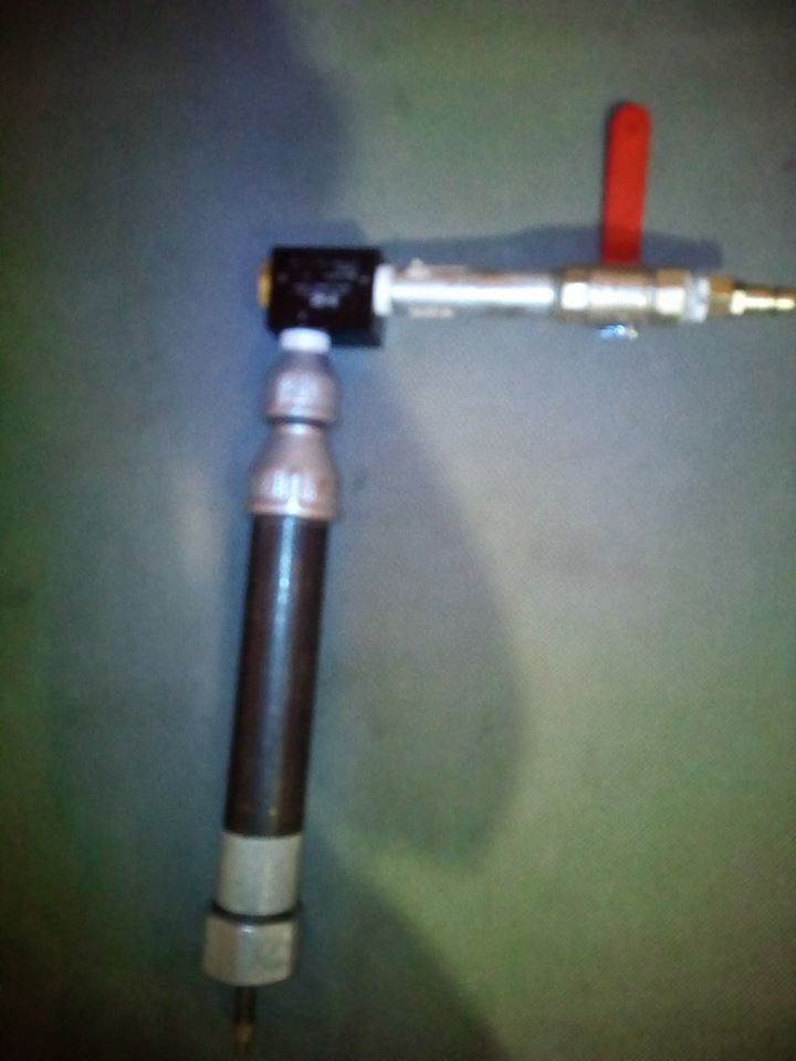

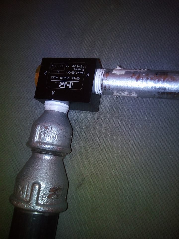

Hi , I made that , like he , but i dont add spring to QEV , and i dont know but its not working , i open ball valve and the air go from the valve where i pumps air , I need to add spring or what ? Plase help
If you want to fill from the chamber side, then you have to modify the piston/diaphragm. An easy way to do this is to heat up a pin and poke a hole in the outer edge.
Did you try filling it up from the nipple on the ball valve?

Another good explanation

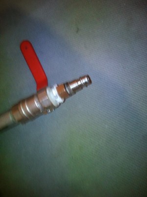

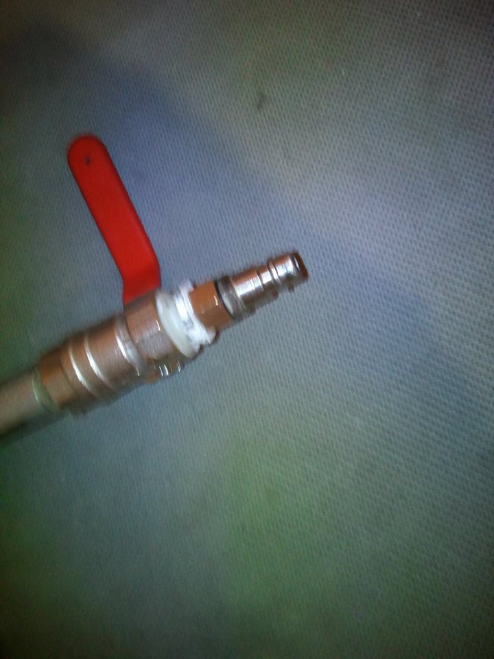

I fill air to that

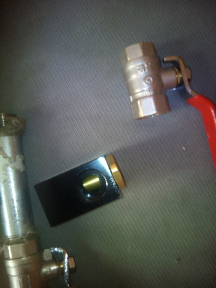

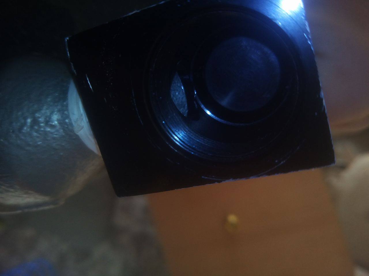

looks right to me. Is the valve stuck perhaps? With no air pressure, can you push the piston back towards the pilot?

I cant, rubber thing is stuck, i cant pull it out and i hear the air escape

Air leak not good, try some thread sealer like Pro dope :idea:

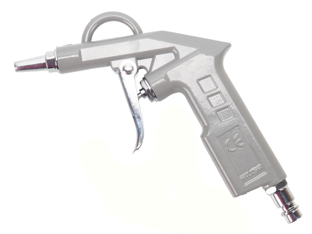

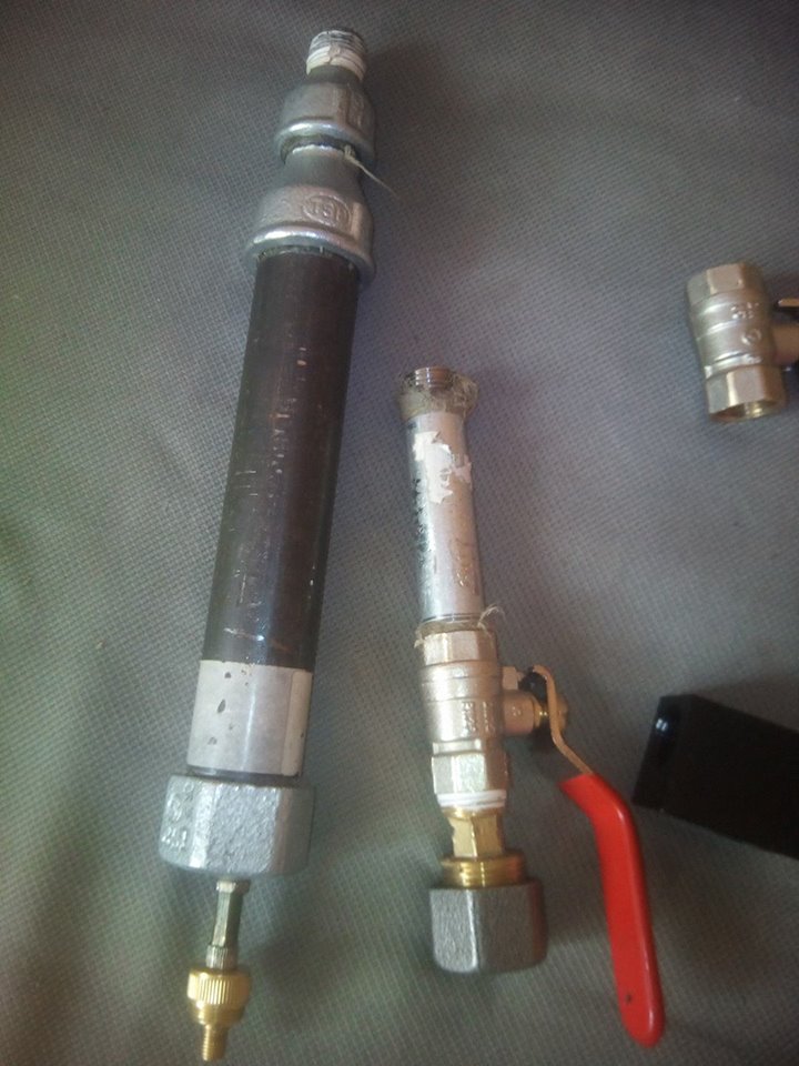

I think i resolve that problem. What is better for qev , Ball valve or air compressor gun? Which allows me to have more power?

Air gun will give you a ready made trigger :idea:
Regardless of the pilot valve you chose, the best way to increase performance is to remove the dead space between the pilot valve and the QEV:
