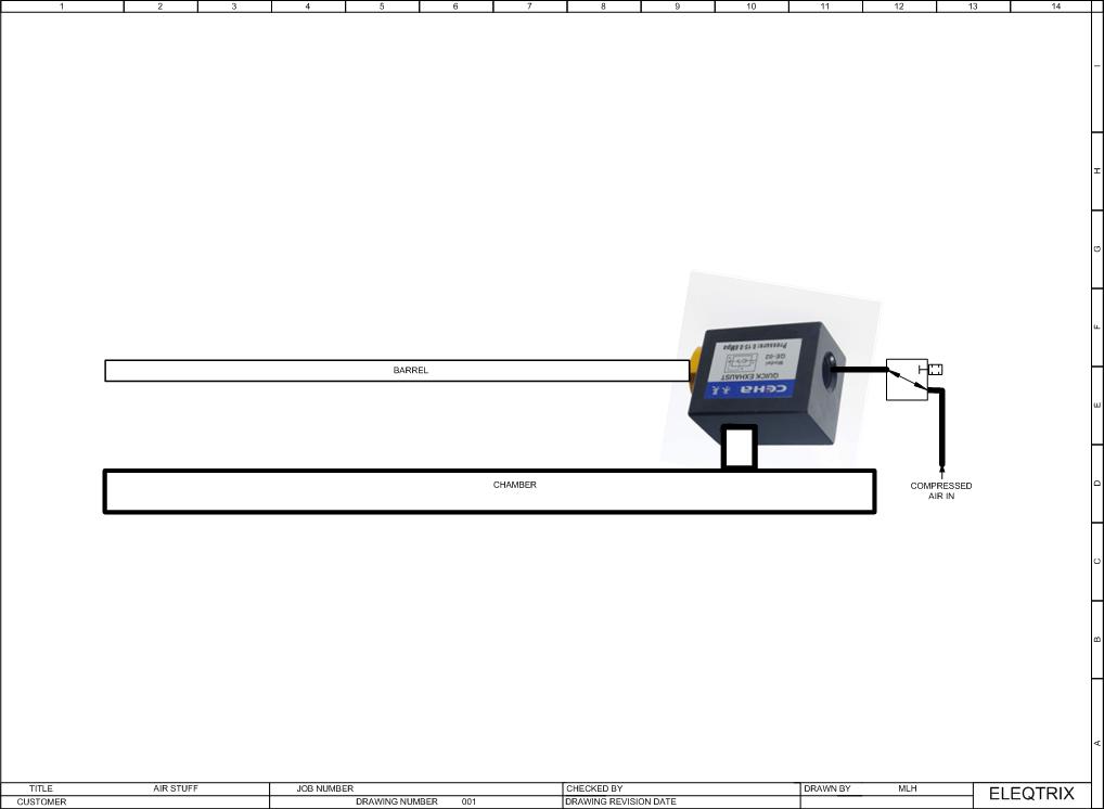

Everything I make uses a compressor as air source
I always have an on board air chamber (except the vortex
) and feed that from the compressor with a 4mm airline that is very light. I try and make the chamber at least 4x the barrel volume (math needed

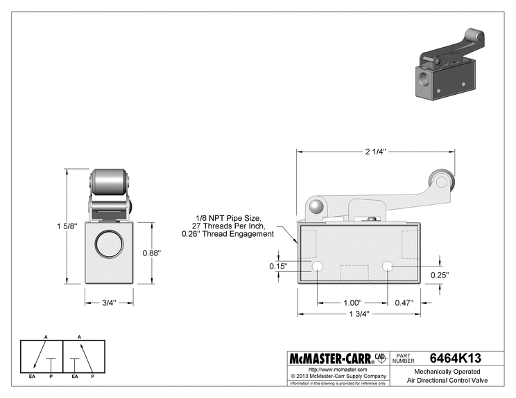

) A QEV valve is probably the easiest to get more power with if going with a single shot, but I get good results with air pilot valves as well. Depends on the barrel size, bigger bore will need a bigger valve, I prefer airsoft and 0.177, although I just made a 40mm
This is a pretty simple layout for compressed air. You will need a QEV and 3/2 valve (with 3 ports, some only have 2) trigger valve.
