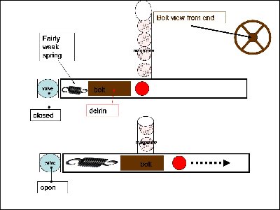

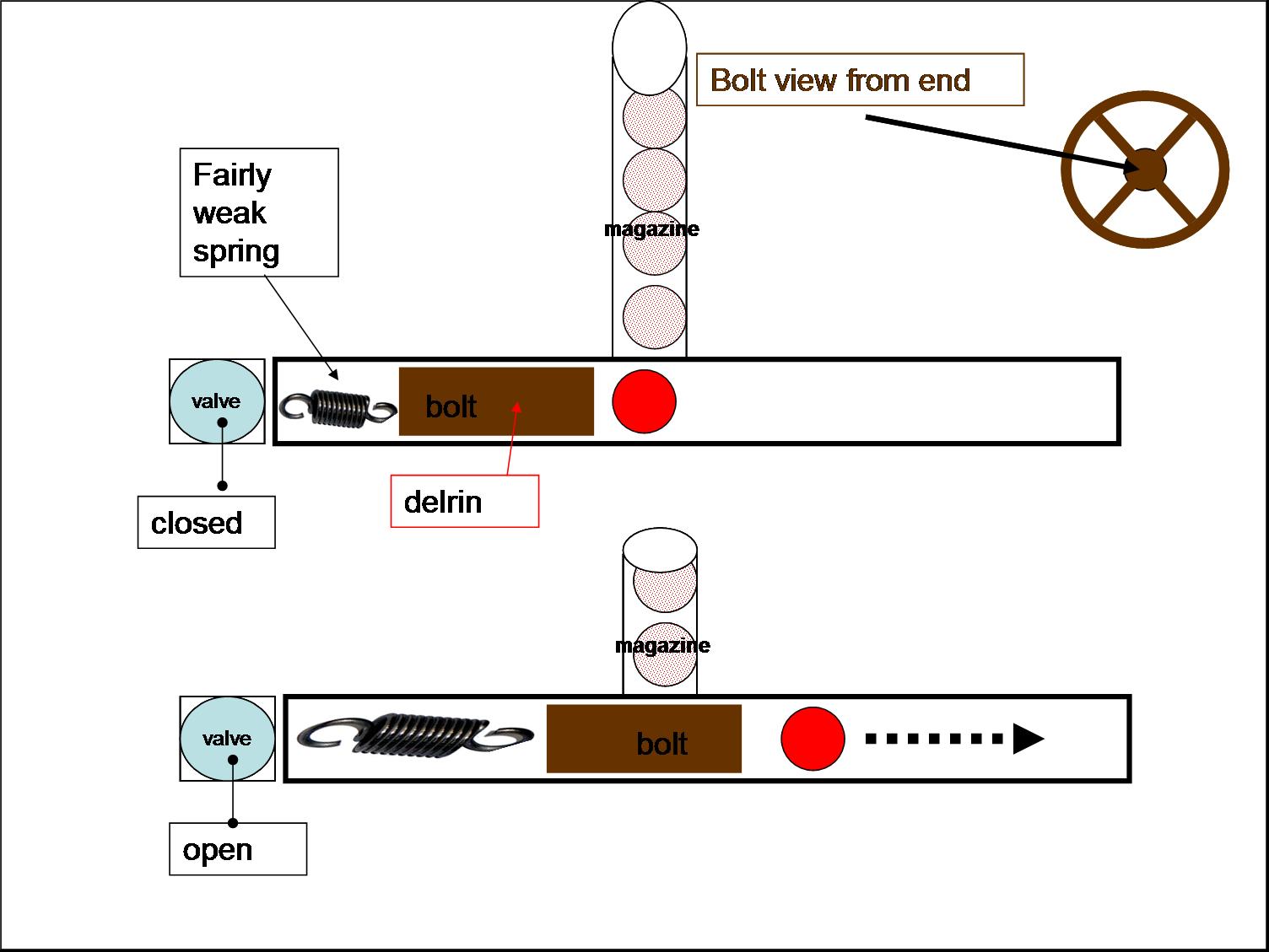

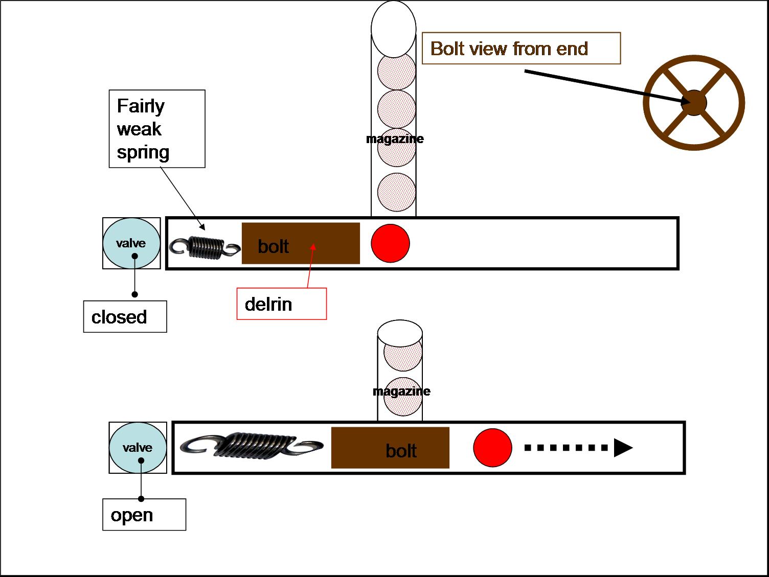

This design will be much more efficient. Grey is delrin with a hole in the middle, black is the spring.
adtchuck
Posts: 10
Joined: Tue Jul 11, 2006 8:08 pm
Location: Ohio, w. of Cleveland
OK, I like that, The peice of delrin would have to be larger, I tore apart a spider paint ball marker, and was looking at it, even though it has the two slides, one above the other, it still looks simpler than a tippmann gun. choices, choices, choices, MMMMMM? :?: :?: :?:
