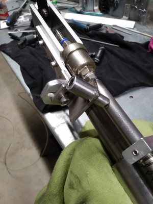

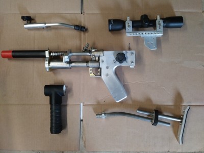

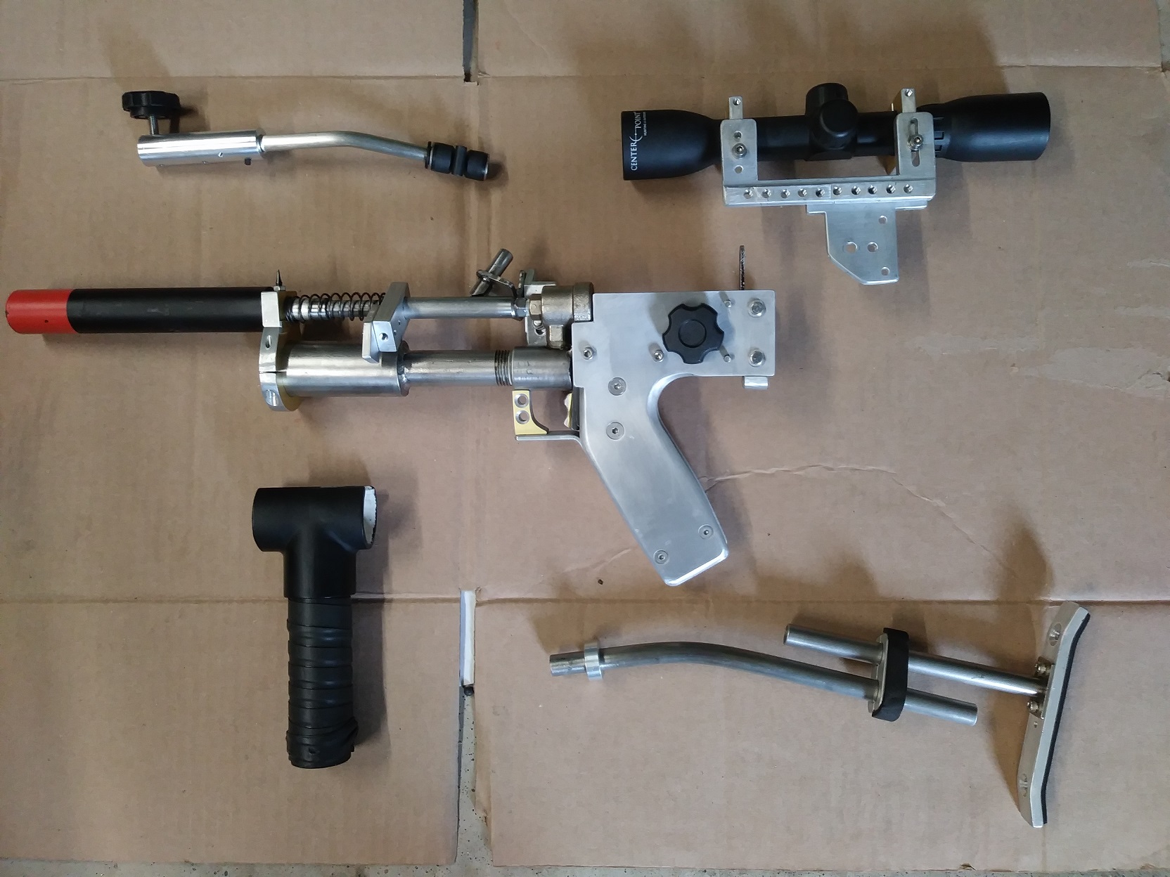

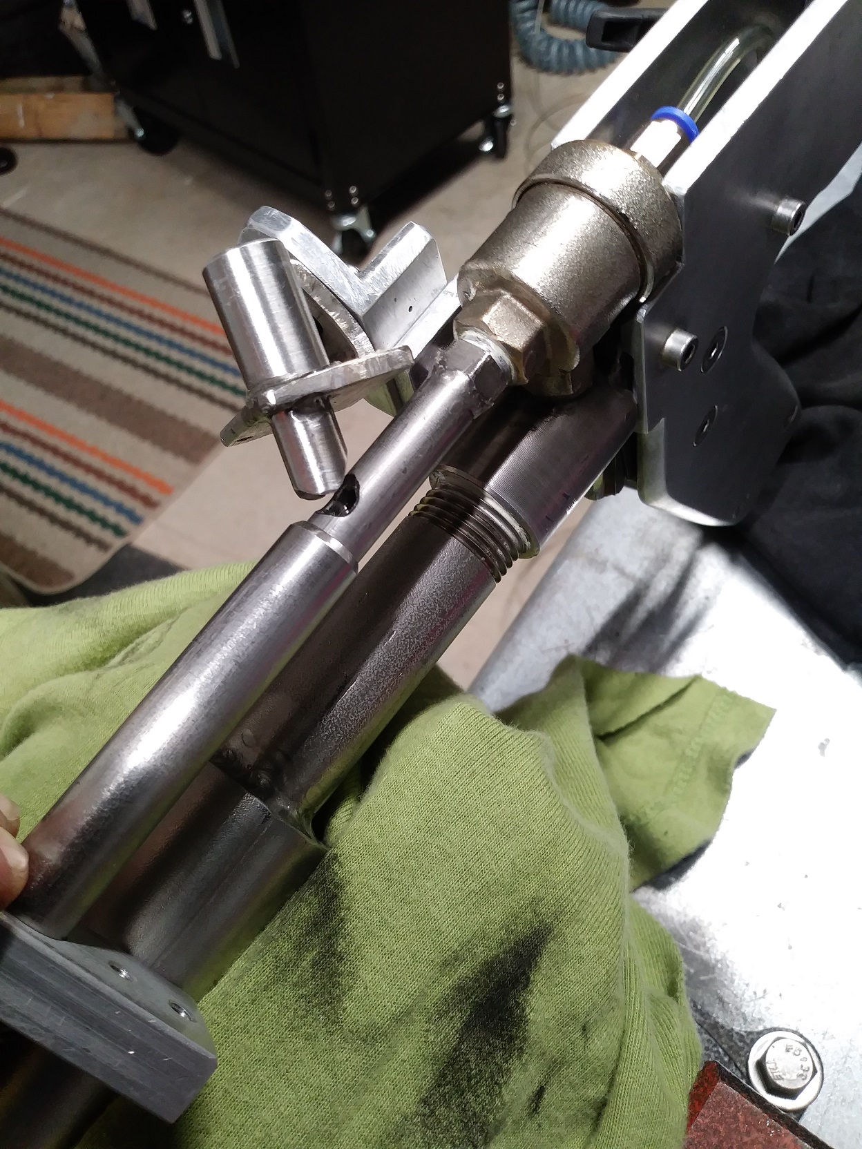

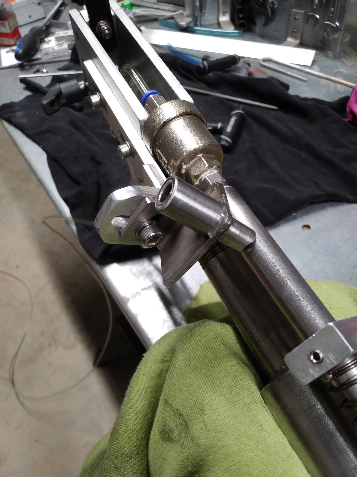

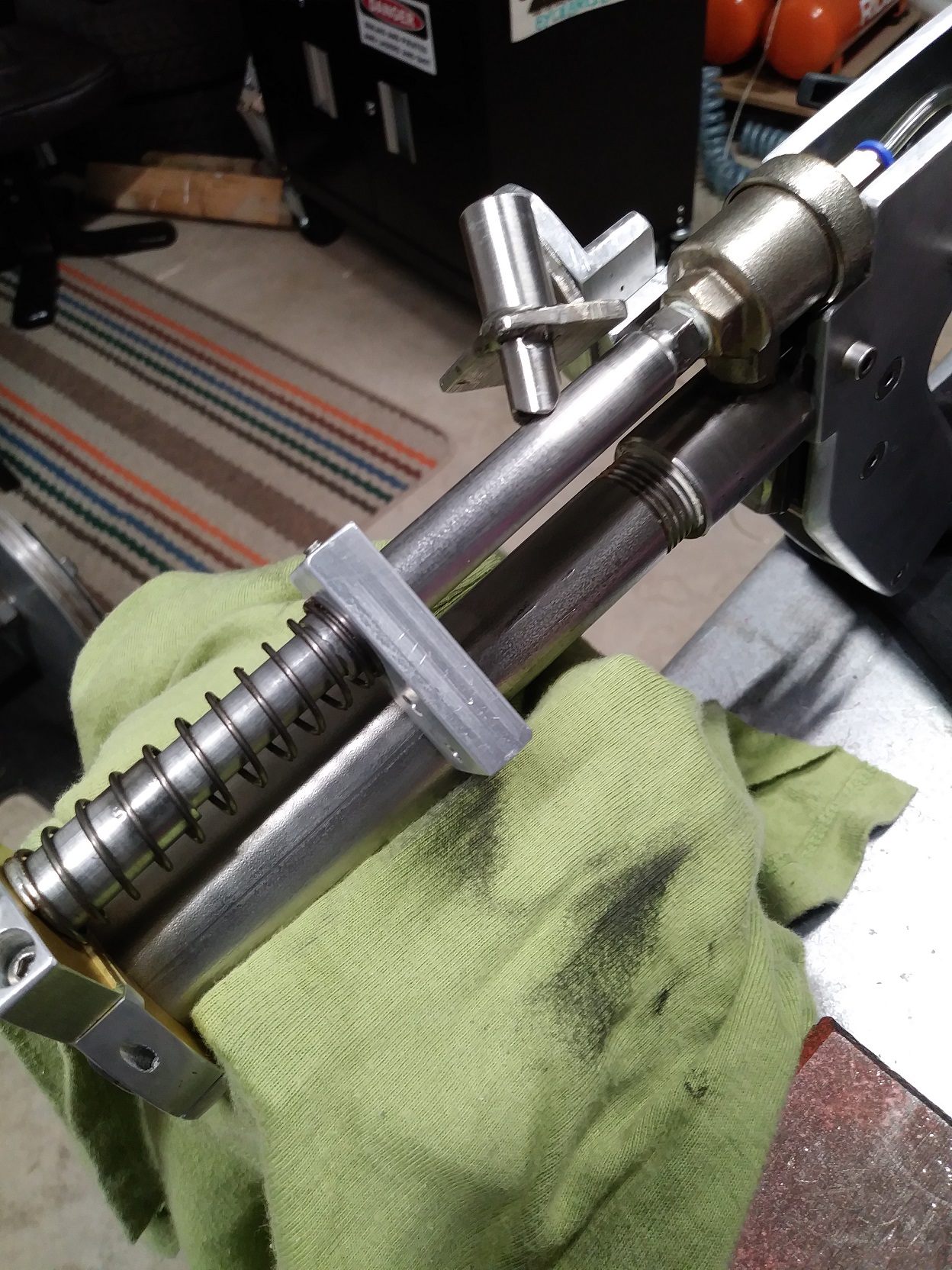

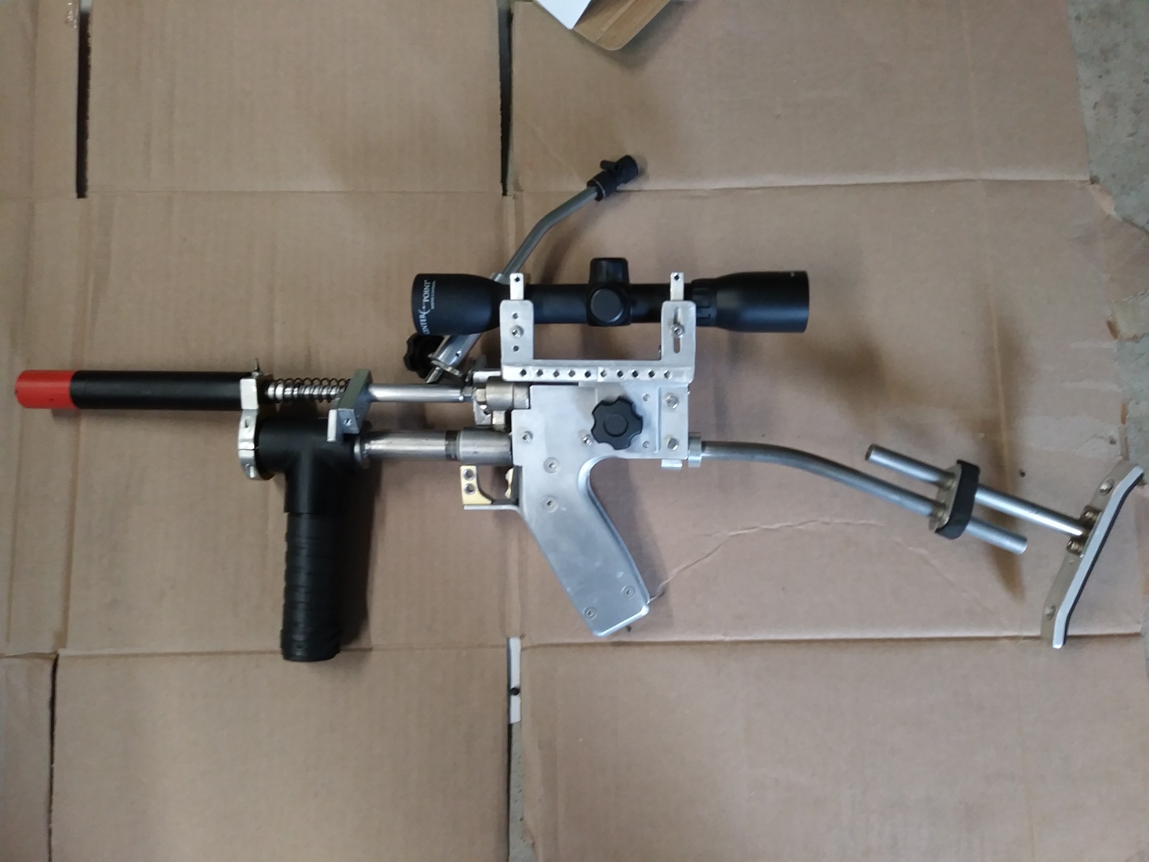

Added a gravity fed magazine tube to my air soft pistol, tube holds 36, the tube is removeable to leave a small stub which holds 6. A spring loaded sleeve over the barrel slides forward (thumb operated) to open a cutout in the barrel and let one BB drop in, the tricky part was getting the angle and alignment right, also had to make dimples inside the barrel around the opening to hold the BB in the opening or the sleeve would jam on the next BB.
With the removeable magazine tube, stock and fore grip on.
Still got to make an extension piece for the loading lever

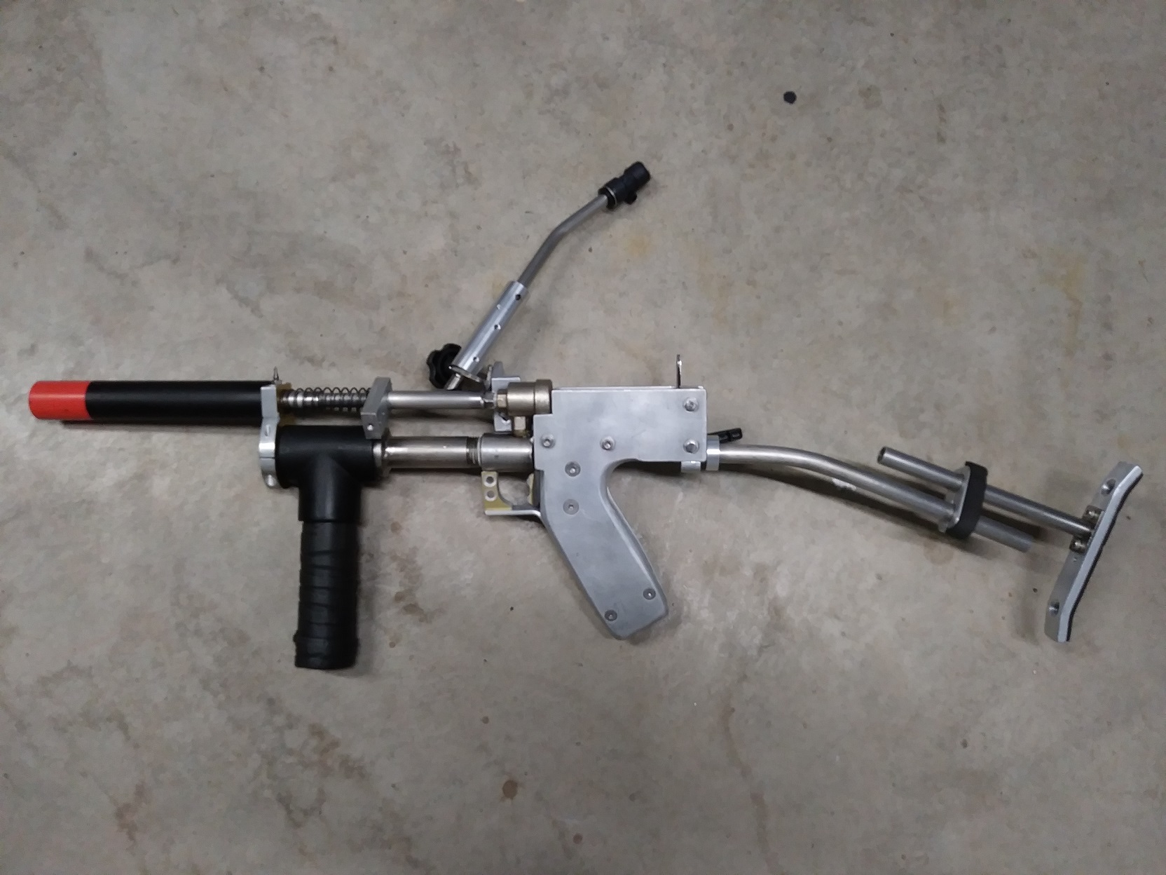

Now with quick detach 4X scope, iron sights can still be used at the same time.
