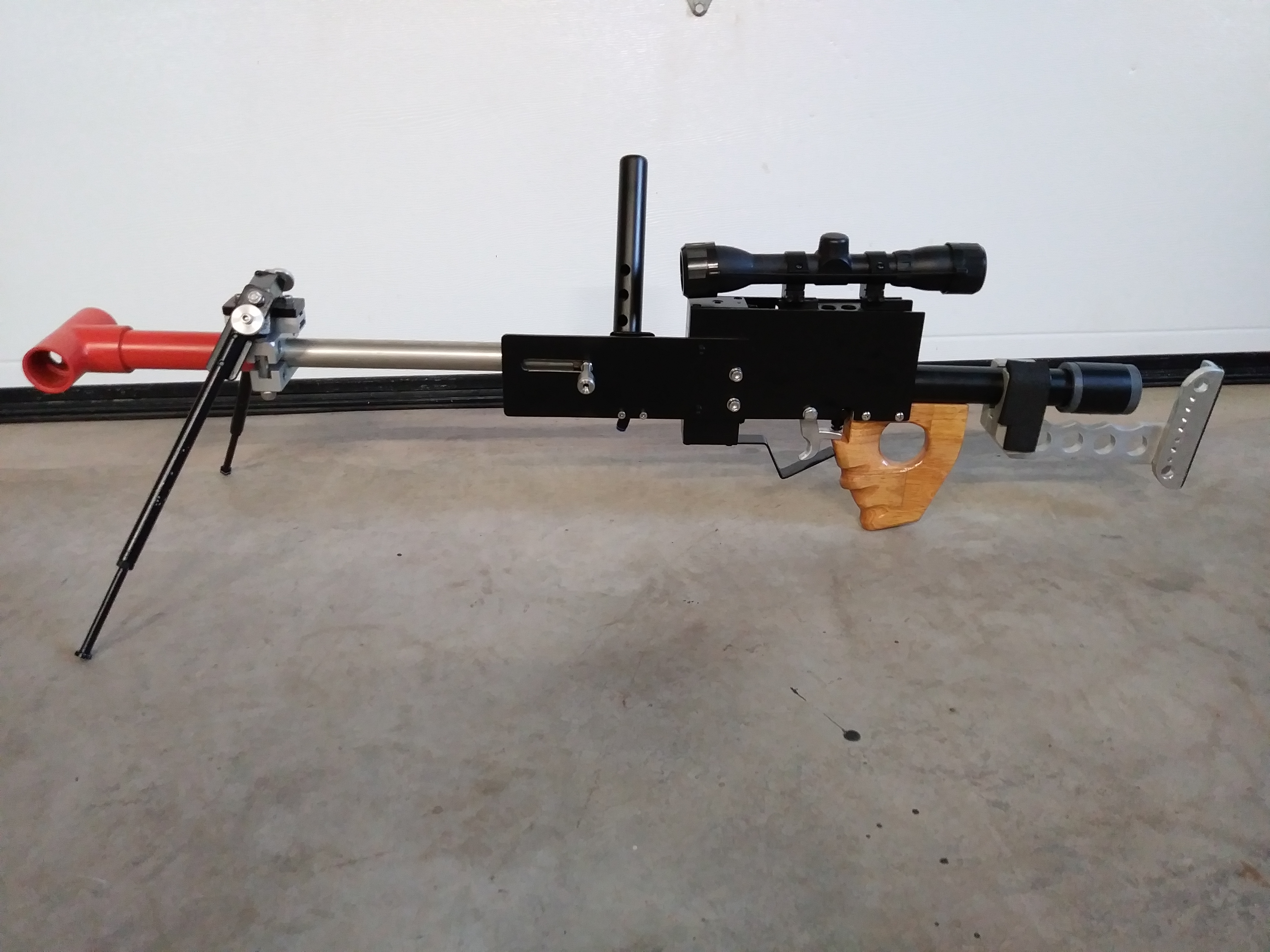

Running at upto 600fps @150psi, stainless steel barrel and chamber, 1/2" pilot air valve triggered by miniature 3/2 button valve, all hand made except the scope, PVC pipe for muzzle break. 7 shot gravity fed magazine tube, single shot bolt action.

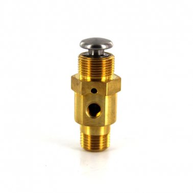

Trigger valve, 3/2, is threaded straight into chamber, 1" stainless steel Sch40 tube, and piped to air pilot valve.

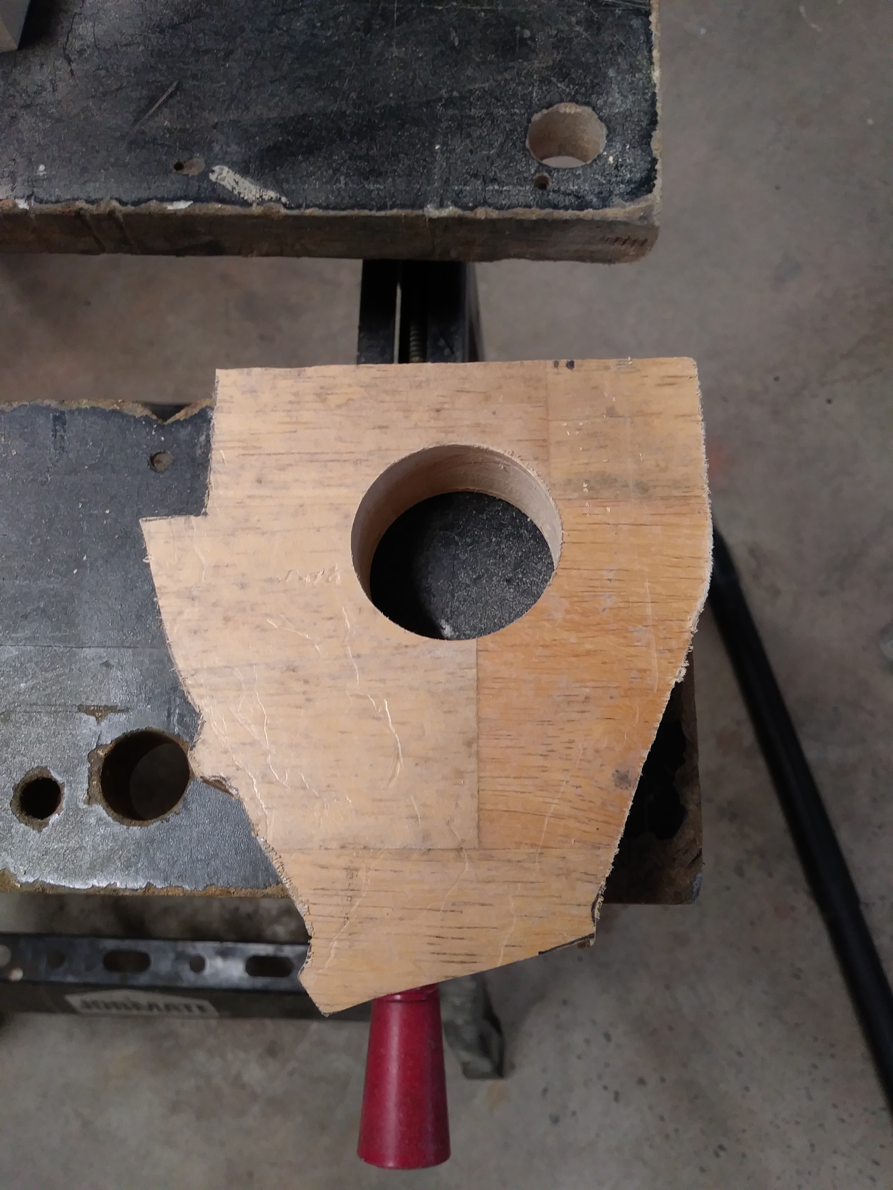

Grip is made from old kitchen table top.
Trigger valve https://tecotechnology.com/products/tac ... alve-10-32

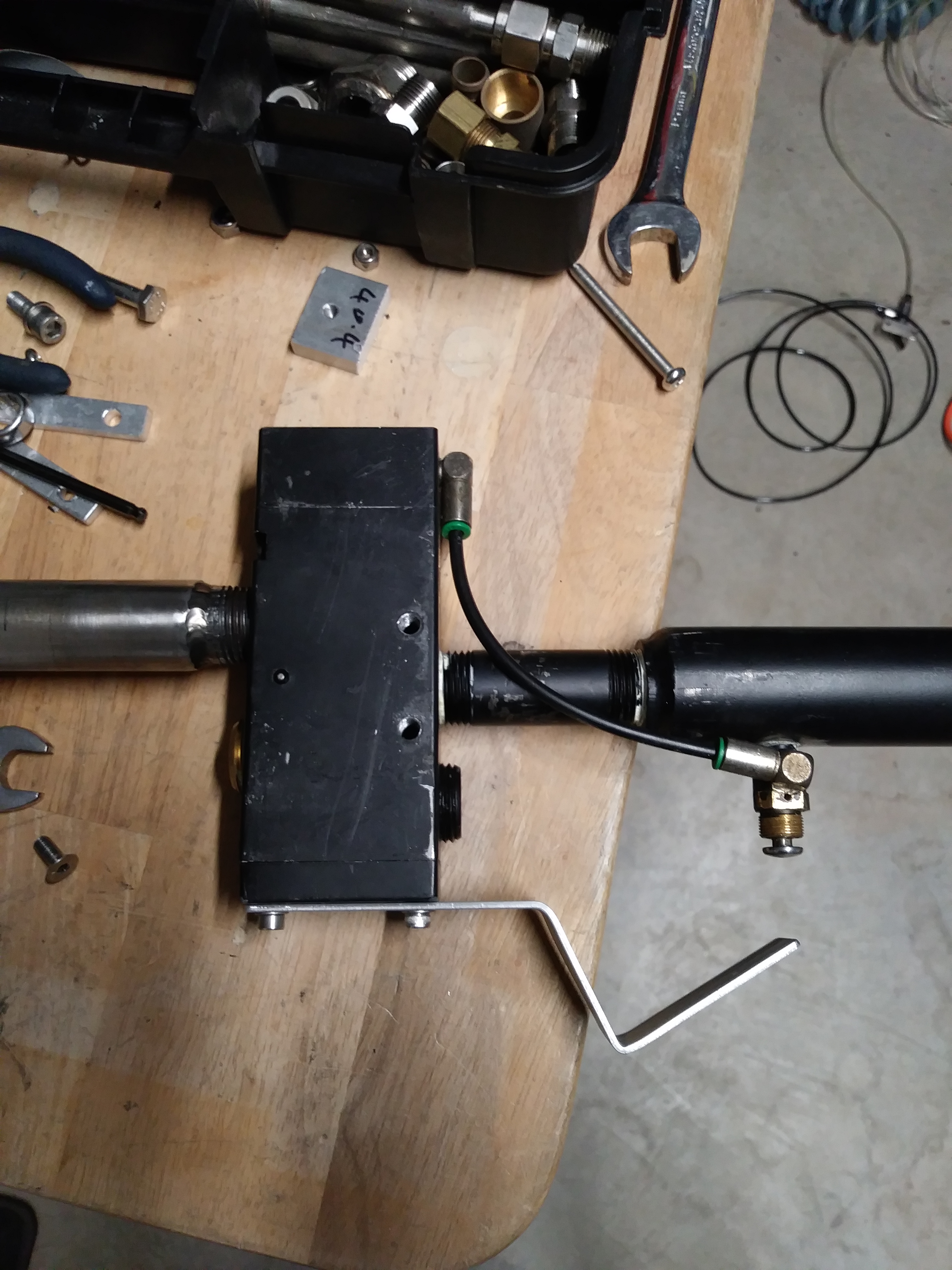

Main valve
https://www.automationdirect.com/adc/sh ... s/avs-5444
