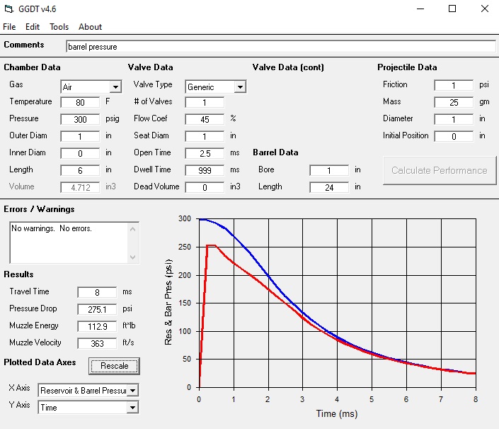

Here is a quick GGDT model of a pneumatic launcher with a 0.25 C:B ratio and a relatively lightweight 25 gram projectile in a 1 inch diameter barrel.
The model suggests that starting with 300 psi and using a fast valve, the pressure in the barrel spikes at 250 psi, the blue line on the graph indicates chamber pressure while the red line indicates barrel pressure.
That means that the barrel sees 80% of the chamber pressure as the projectile begins to accelerate.
Of course not all launchers are so efficient, but with faster valves and heavier projectiles it is something to keep in mind.
