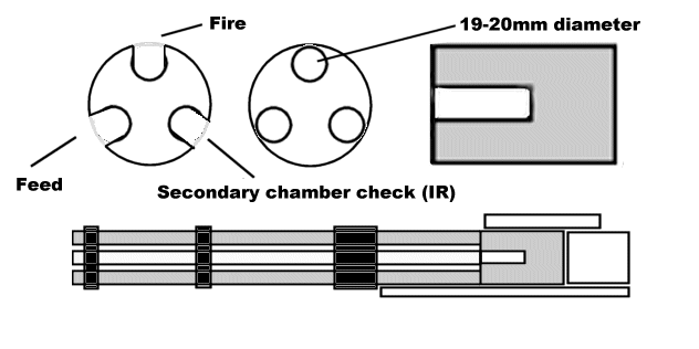

Here's my initial crude sketch:

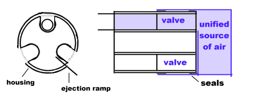

Here's my first obstacle: maintaining a metric fuck-ton of air into a rotating cylinder. If the barrels were spinning but the rest stood still, it wouldn't be hard (then the feed system would be hard instead, trying to throw something into a spinning hole every few milliseconds) but that's not how I'm doing it.
The image demonstrates my first idea: valves on each chamber with a unified air supply behind the breech. The cylinder would rotate, the air supply would not, and it would have a connection at the rear for c02 or a compressor. The seals would maintain air pressure even with the moving parts- at least that's how it would have to work. I'm not sure if seals even exist for that sort of application.
Also, the air supply would be shaped like a donut to allow for a shaft from the center of the rotating cluster, for stability. (The motor and clutch will be to one side of the cluster, not behind the air system)
As for the left hand image, that's a diagram of how the housing and ejection ramp will be placed. In case of a misfire, I want to remove the projectile so there will be an ejection ramp at four o'clock.
