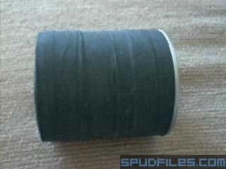

Here's an overall view of the finished piston. It's a dry fire piston since the cloth tape slides effortlessly inside a 3" pipe.

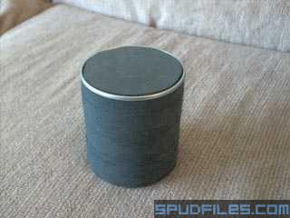

A shot of the piston face, just a rubber disk glued to the metal bottom of the can. I think I used contact cement.

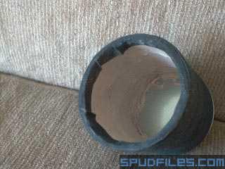

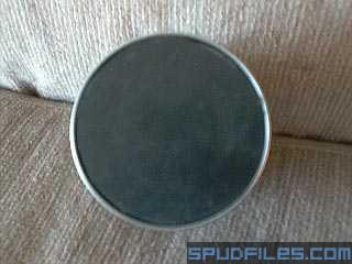

The back of the piston. Not so pretty eh? I gave it a few coats of Bondo just to make sure the cardboard didn't crush under heavy impacts. It worked at 50psi but I haven't went any higher since I switched pistons.

Finally here's a side view of the Pringles piston. The metal edge of the can is a great fit in a 3" pipe so I also built up the back edge with some extra layers of cloth tape to make it stable inside the chamber. You could probably use anything similar around the outside like felt or something, I had some tape laying around from my amateur street hockey days (that's the stuff they use to wrap hockey sticks).
