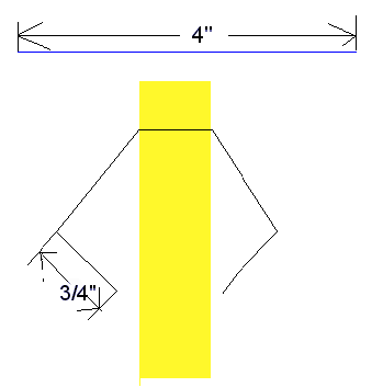

Body tube
Nothing over fancy here, just 14" of cpvc sdr-11 (1/2" thin wall). A pipe cutter works very nicely, although you will need to use a pipe reamer to remove the ridge around the inside edge. Use some fine grade steel wool (0 - 00) to 'rough up' the surface of the pipe (and remove the markings). Wash the pipe and your vanes in hot soapy water( if you hand wash your dishes that works fine, I would recommend that you do the dishes along with your dart supplies to maintain domestic harmony), I don't know how it would turn out if one were to use the dishwasher, rinse and allow to dry. I've been using 'Bohning Fletch-tite vanes' 5" stealth, 4 each(untested; one may be able to get away with using 3 vanes per dart, I have not tried this, I find it easier to do 4 vanes/fins). Draw 4 lines 90 degrees apart on one end of the tube(or 3 lines 120 degrees apart for 3 vane setup) these lines should be roughly .5" longer than your vanes. These lines are to help you glue the vanes on straight. Run an 1/8" wide bead of fletching cement along the lines (do one line/vane at a time) and attach the vanes, you will need to hold each vane in place for about 15 seconds till the cement starts to set, repeat for each vane. Note: do not let the vanes run past the end of the tube or you may encounter problems with them coming off in flight. set the dart off to side and allow the cement 1 - 2 hours to dry. If you want to get fancy apply a fillet of cement to each side of each vane base. While the glue sets/dries cut two(2) 4" pieces of .062" music wire. after giving the glue time to dry, measure 1" from the forward end of the tube and 45 degree offset from the vanes and drill a 1/16" hole straight through the tube(from one side to the other), rotate the tube 90 degrees and 1 1/8" from the forward end drill another 1/16" set of holes. Insert one piece of music wire through each set of holes (you want approximately 1.75" of wire sticking out from each hole.
<img src="http://www.spudfiles.com/official_pics/pic11.gif">

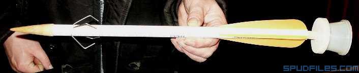

Here is my final one. It just needs paint.
<img src="http://www.spudfiles.com/official_pics/RexDart1.jpg">
