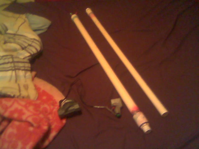

This is my 1st pneumatic I is just a plain old inline im going to mod it in to a UO sniper with a stock but ATM I only had enough for the bare minimum
Thought I'd have to make 1 after making my first combustion 3 weeks ago.

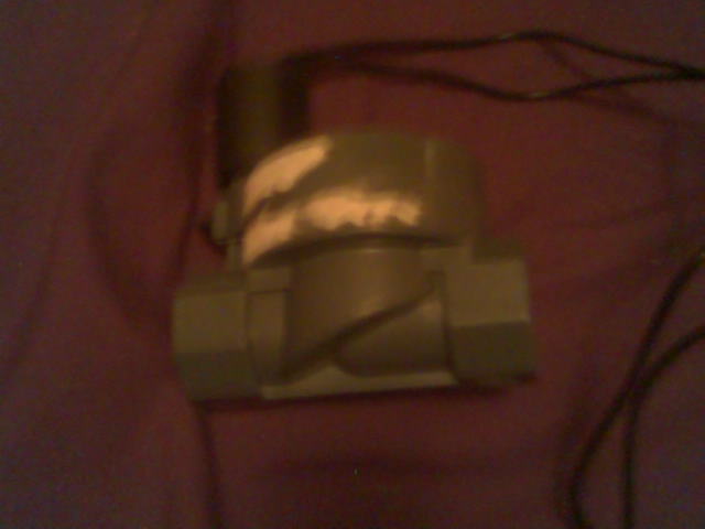

HAS NO POWER wont Evan throw a piece of potato across the road, and it takes about 3-4 seconds to let the air out of the barrel after clicking the button, I'm guessing its because im yet to mod the sprinkler valve, Although it dose do some spectacular water shows it will spray water 15-20 m up in the air.
it consists of:
a 1m length of 32mm
a 1m length of 25mm
some bits and pieces to get it to the right size for the sprinkler valve

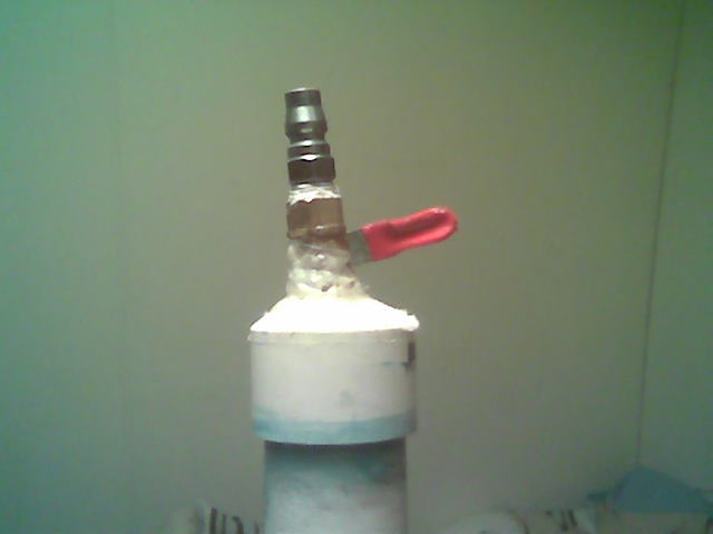

and a gas tap with a 1/4 nitto fitting for my compressor
Every thing is pressure rated even the reduction bits and couplings, I didnt skimp out.
Its relay strange I was going to make it bigger e.g give it a 3" chamber and a 1.2" barrel but I cannot find bushings and the other bits and pieces (im in Australia) I got all my components from a pool, pumping and irrigation supply shop.

mod sprinkler valve
dont flame me for not sodding the valve like a kewl I know that it should be done but I ran out of money
Disassembled
Disassembled

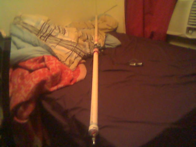

all together its massive over 2m
Because this was an imperial fitting and i only had metric drill bits i went 0.5mm to big so i epoxied it it leaked put paper around it and added more epoxy works well now. I'm going to get a new end cap and redo it

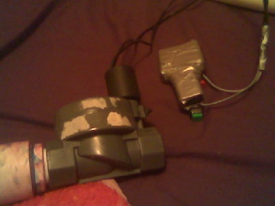

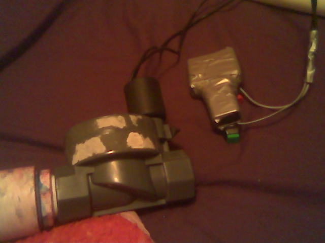

my terrible job a bit of duct tape r volt battery's and cheap switches
solenoid and switch
solenoid and switch
try heavier,harder ammo and it should go further like a marble or something,a big chamber will help and a better C:B ratio will also doa bit as well as modding the valve,
average cannon for a 1st pneumatic could be better but on a tight budget not too bad 8)

Try modding the valve,they have way more power that way.
