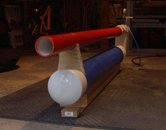

Cannon Name: Piston-Valved Americannon
Type of Cannon: Pneumatic
Chamber Size: 6" SCH 40 x 60" (1700 CI)
Barrel Size: 3" SCH 40 x 72" (510 CI)
Gas Source: 26 gallon air compressor
Valve: Barrel-sealing tee valve, 4" inlet, 3" outlet. Exhaust valve is an aluminum 3/4" Detrol quick exhaust valve actuated by a high-flow 1/4" blowgun
Special Details: Usage of 3" Aluminum Banjo Couplings (will add 2.5" SDR-21, 3" SCH 80, and 4" SCH 40 barrels in near future), heavy-duty 4" SCH 80 threaded cap for safety, spring-less piston design.
<img src="http://www.spudfiles.com/uploader/uploa ... d32423.JPG">
I have had this cannon done for a while, but I have just not had enough time to post it. Don't mind the crappy picture; although it appears dirty, its actually really very clean. I call it Americannon due to its patriotic colors. The chamber is 6" X 60", while the current 3" SCH 40 barrel is 72" long. I would have opted for a 10' barrel, but I really cannot store or transport it in my house right now; my parents are pissed enough that I built such a large/heavy cannon.
<a href="http://www.spudfiles.com/uploader/uploa ... .JPG">Side View</a>
The cannon is mounted on a very simple stand; just a long piece of wood with two supports for the chamber.
The <a href="http://www.spudfiles.com/uploader/uploa ... PG">barrel support</a> was cut from a piece of plywood I had lying around in my garage
The valve is a homemade barrel-sealing piston valve. The inlet is 4", and the outlet is 3". It is exhausted by a 3/4" Detrol QEV, which is hooked up to my <a href="http://www.spudfiles.com/uploader/uploa ... >universal fill-up and exhaust system</a>

I decided to use <a href="http://www.spudfiles.com/uploader/uploa ... m-locks</a> for this project. The cam-locks are all 3", made by Banjo.
I have three <a href="http://www.spudfiles.com/uploader/uploa ... JPG">other cam-lock fittings</a>, which I will use on future barrels. The center cam-lock is already screwed onto a 3" male adapter which then enlarges the pipe size to 4"; perfect for a 4" barrel. The other two cam-locks will be used on a 3" SCH 80 barrel (already own it, just need to pick it up from school) and a 2.5" SDR-21 barrel (still need to buy it). When I receive these barrels, I will paint them and update this thread. In my ideal world, I will have a 3" SCH 40 X 10' barrel, a 3" SCH 80 X 10' barrel, 4" SCH 40 X 8' barrel, and 2.5" X 20' barrel (that last one will never happen...)
To pressurize this cannon, I use my 26 gallon <a href="http://www.spudfiles.com/uploader/uploa ... pressor</a> (using a bike pump would get really old, really fast).
I haven't done too much testing. So far, I shot a 20 ounce coke bottle (filled 1/5 with water) that split a 3/4" board (could be plywood or particle, not sure) at 20 PSI.

Thats one of the best cannons i've seen, very very nice work! What do you use as a piston?
Velocity
Posts: 1039
Thanks for the comments. For a piston, I use two 3" endcaps solvent-welded together. The endcaps are modified however, giving the piston an overall shorter length. There is a 4" diameter (about) circle of 1/8" neoprene on the piston, and that is the sealing face. No springs are used; just a special low-profile bumper that I built onto the piston.

In the first pic your cannon looks quite advarage size, but then you here the dimentions!

Lol Dream on. how far back does the barrel go into the valve?

The barrel does not extend into the valve. Seen <a href="http://www.spudfiles.com/uploader/uploa ... G">here</a>, the barrel (at the left) ends in a male adapter, and screws into the cam-lock. The cam-lock is connected with the other cam-lock (not sure what its called), which then connects to the barrel.

Why cant you get higher pressures? This is a very nice huge BEAST OF DOOM!! MAHAHAH!!! What the pressure rating on the 6 inch pipe? Mine is 120 PSI.
Velocity
Posts: 1039
6" pipe pressure rating = 180 PSI
