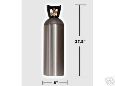

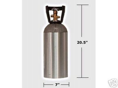

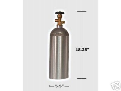

okay well i've had some thoughts on my new pb gun!!! first off i will go through my products... i will have a selection of 4 different types of co2 3 bottles (5lb/10lb/20lb) that might be going on my back and one (smaller one) that might be mounted to the gun...

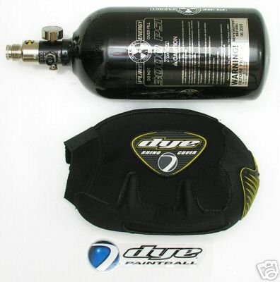

but now i am stuck on what i need for a regulator??? i have found this setup with a small tank and what i think is a regulator???

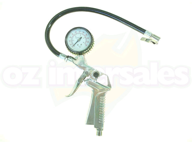

might use this for a blow gun trigger
smaller co2 mountable on gun
20lb bottle
20lb bottle
this is the 10lb bottle
this is the 5lb bottle

Instead of killing yourself due to the fact that you apparently have 0 knowledge of wtf you are doing, dont make the gun. The last picture isnt even a co2 tank, its a 3000 psi hpa tank which if attached to pvc would end your life via being blasted by shrapnel. Also, why the hell would you carry a co2 tank on your back. Also, you can constantly run co2 in a pvc gun without a break inbetween so the portability of it being on your back is useless. If you dont give the pvc time to warm up from the freezing temperatures of the co2, it will eventually become dangerously brittle.

Ok mihlrad you keep saying that your going to blow yourself up with the HPA tank but its actually safer than co2 because the it is not cold. Since the HPA tanks do have 3000-5000 psi in the tank, that is NOT how much it puts out. Most tanks are high output which is regulated at around 800 psi (the room temp co2 puts out) and some can be low pressure which comes out at about 400. But thats a hella lot expensive so I dont think you should use that a primary air source.
Back on topic though I have see some fireman air tanks on ebay for dirt cheap... like I got two 2216 psi air tanks for $10 with a local pickup. Of course I had to get it hydrod, but you can find regulators for them like I think a bulk co2 regulator will work with an adapter but dont hold me responsible if that doesnt work.

pb_gunz that "regulator" in the picture you posted (the one that is just a link) is actually not a regulator at all. Its an asa (threads on the tank) adapter with an npt output port on it. So you would still be getting 800 psi out of that. What you need is a paintball reguator for the HPA tank or a bulk CO2 regulator which both can be found on ebay with a simple search.
