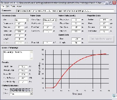

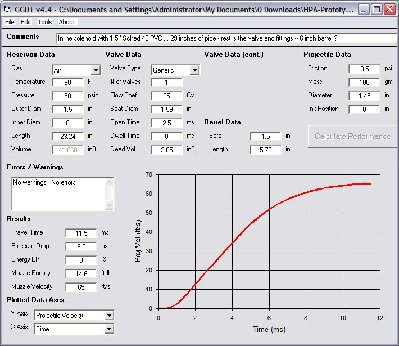

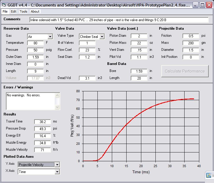

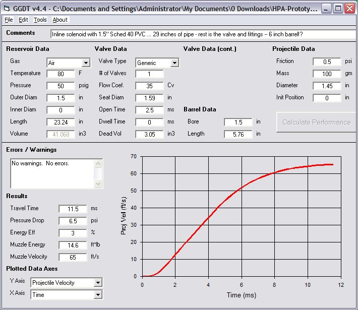

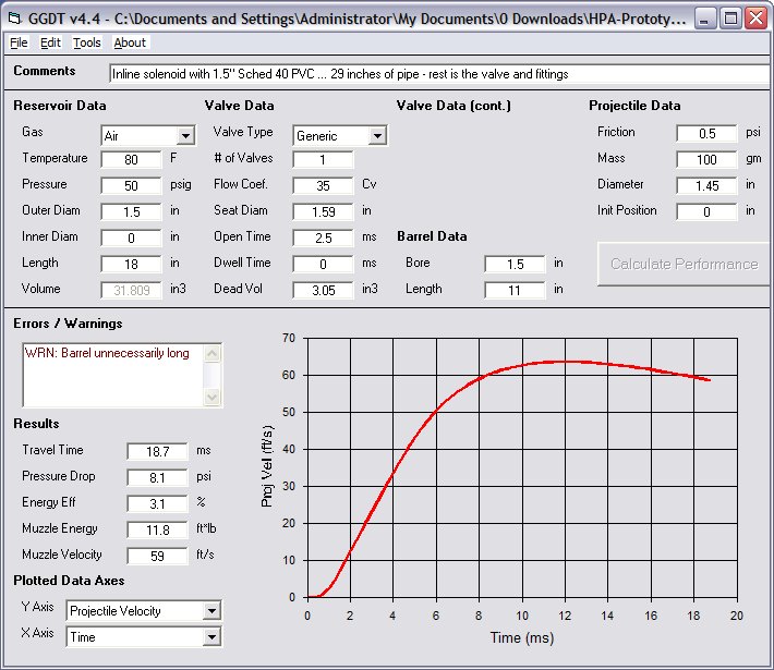

Been using GGDT to model a 3" (about 1 meter actually, 39") long inline pneumatic. The sprinkler valve plus fittings take up almost 10" so that leaves me 29 inches to work with. To make it simple on materials I'm using the same 1.5" sched40 for both barrel and chamber. So I start with the usual 1.5:1 (but less than 6:1) rule of thumb. Pressure will be 50psi (60psi - 10%) because of pop-in schrader valve.
When I ran optimize to overall length it was telling me to use a 23" chamber with a 6" barrel. As far as barrels go, can it become too short to launch waterballoons/nerf/paintballs?
Is there some sort of ratio between bore and barrel length that you follow?
The instinctual ratio I made gave a 20' apogee with 100ft max range while the optimized one had 301' apogge with 120ft max range according to ballistic calculator.
Bore to Barell Ratio: Can a barrel be too short?

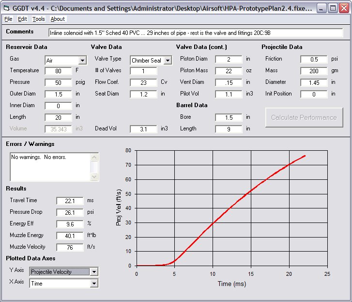

If you have 29 inches, then make your barrel like 20" and your chamber 9". I made a little 1.5" gun a while ago which used a 5" long chamber, 14" long barrel, and a pop-in schrader valve which was safe at 120 psi. 50 psi isn't very strong.

Of course it's giving you garbage answears; take a good look at the values you'r feeding it.
(The valve stays open for 0 ms)
Garbage in, garbage out, ya know...
Acctualy use a valid model for a sprinkler valve (such available from the GGDT website), instead of a "generic" model.

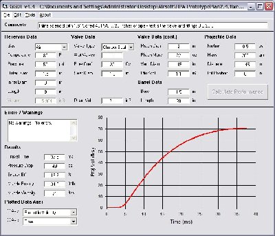

try 10ms opening time, dwell time 1000ms, Cv 6, seat diam, 1"

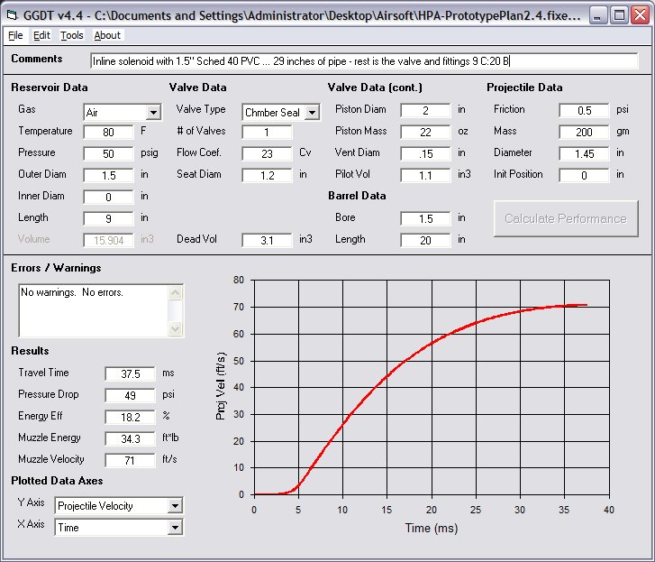

Cool! I knew I was modelling it wrong but was just too new at this to know my mistakes. Found the page where the Orbit Watermaster 1" was modelled and plugged the values in.
http://www.thehalls-in-bfe.com/GGDT/lib ... rbit1.html
I hope my values are more or less correct now. Incidentally, I've found that exchanging the barrel for the chamber at the same pressure has a marginal difference in fps. That is interesting.

Your flow values for the valve are in CVs, and the page calls for 23 PERCENT.
Go to options and change the flow values to efficiency.
(and for the record, 1.5" sch 40 pipe is 1.59" ID)

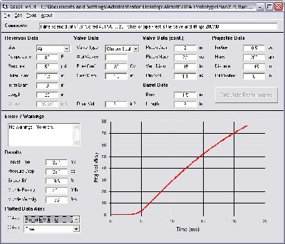

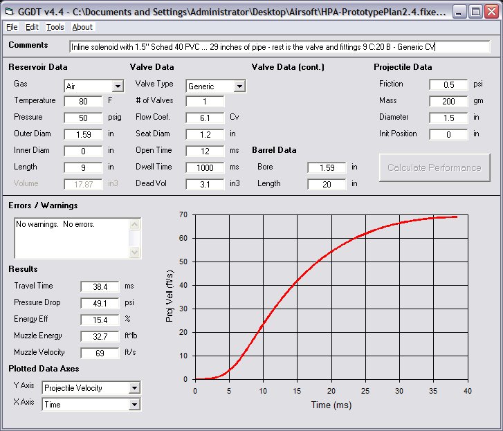

Click where the valve info is and change it to "generic"
Then put in 6.1Cv, 1000ms dwell time, 12ms opening time.
You ammo cant be 200g!

@boilingleadbath

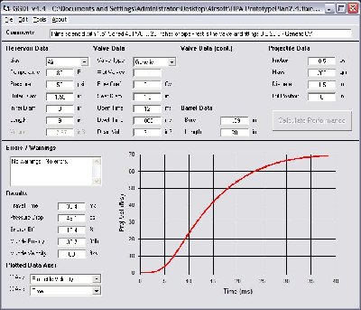

Thanks, trying it with your parameters now. Sorry, I don't really understand what CV is and how all these computations apply. Someday I hope to.
@LucyInTheSky
Also tried it your way with "Generic". The outcome seems less optimistic with this one but maybe its more accurate? I used 200 grams because I'll be firing flour, confetti, and maybe .12gram BBs out of it.
What and where should I read up to understand these parameters? My knowledge of physics and fluid dynamics has degenerated to barely understanding newton's law.
No plans of firing anything heavy and hard with my first design. For all I know the solvent welds are wrong and the endcap might pops out at 10psi ... hahaha. Thanks for putting up with me guys! Hopefully my mistakes will give someone else a clue later on.
@LucyInTheSky

Not sure what else I'm doing wrong now. The GGDT data suggested that a 9x1.5" chamber should be able to shoot out through a 20x1.5" barrel at about 70fps @ 50psi. The ballistics calculator estimated a 60+ foot apogee. Maybe I am losing pressure during removal of the bike pump from the schrader (hiss)? The watermaster + chamber didn't leak anymore. They passed a water and air test. I used tissue paper and a small empty shampoo bottle as a projectile but it only travelled 10 feet firing horizontally @ 60-70psi (before removal of pump connector). Maybe I should spray Pam unto the barrel? Then again I'm using the manual bleed screw to trigger. Maybe the above parameters are for a modded sprinkler?
If you have any enlightening comments on the questions above I'd like to hear it. Meanwhile I shall endeavor a brute force approach by making new pipes using the reverse ratio.
