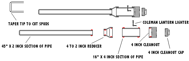

I made probably the most basic spud gun there is . It is a combustion cannon. This is what I made, instead of the Lanter lighter we used a barbeque
sparker.
The problem with it is that it did work for about half an hour, and the sparker is making a definate spark, but the right guard body spray will not ignite inside of the combustion chamber. We have tested out all different amounts of fuel, and none will ignite. Can anyone tell me what the problem is. Is it that we used a barbecue sparker?

The problem is probably not with the bbq sparker but rather with your fuel. Maybe try different amounts or a different fuel all together. My choice is propane. Allways works and even better after its been metered.

You said that it worked for 30 min right? If so then the inside of your chamber has to be dried out and aired before shooting again.

Yeah, it prob is a venting problem. A Chamber Fan would help vent/mix the fuel with air.

And the fact right guard is not flamable....

I would use equate body deoderant, exact same thing as right guard 2$ cheaper, same size can too. I use it and it works great.
