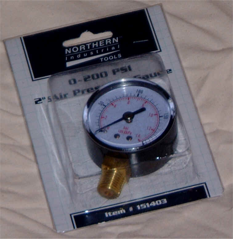

1x 0-200 pressure gauge

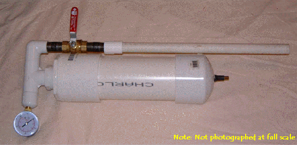

the creation(moohaha) make sure you build it like this.

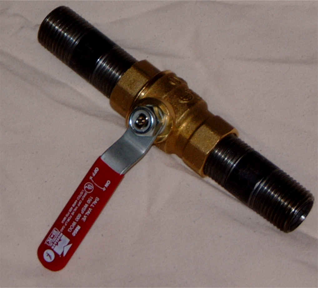

ball valve with 2 niples (hahaha)

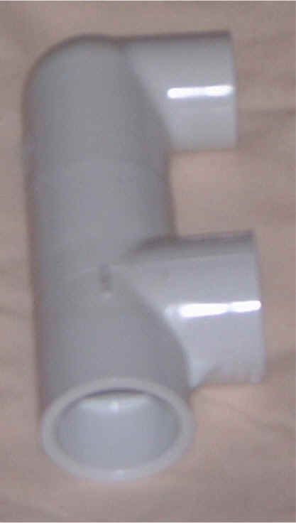

tee and elbow(both 3/4, make sure you put together like this)

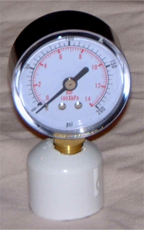

3/4 endcap with gauge

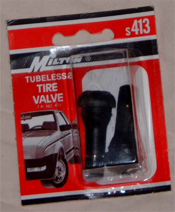

scraders (only need one)
the gauge
the gauge
heres what it should look like all put together. the three inch pipe section is 1ft long

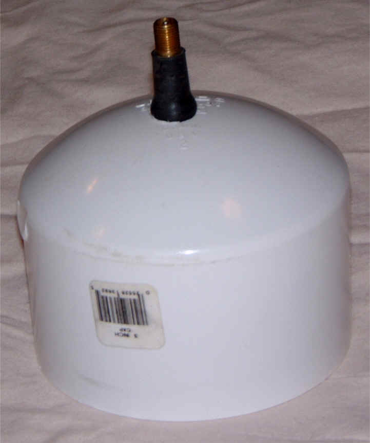

the endcap, with shrader. im sure you can figure it out.

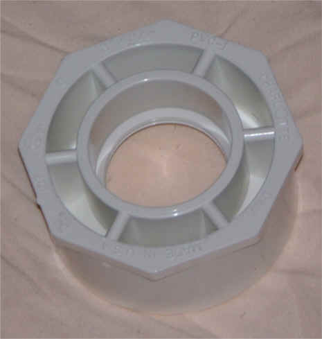

the 3inch to 2inch adapter

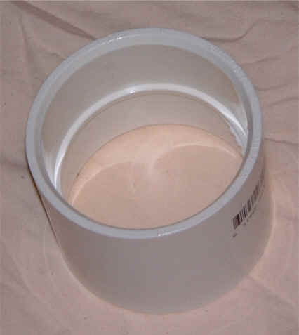

the coupling
the coupling

But I think you should use a Male Spigot to Female NPT fitting, instead of the drilled end cap for the gauge.
Like this one:
I would also recommend using Flickr for your image hosting, it will give you more control over the size and arrangement of your pictures.

Yea as i said, my camera isnt working a.t.m. so these pics are off another website. I too strongly recomend using a Male Spigot to Female NPT fitting. It is much safer and safety is always a requirement when playing with air and PVC.

OH, and wtf is the coupling for? I have no f'ing idea and I don't see it in the completed pic.
rna_duelers
Posts: 1739
Location: G-land Australia
The coupling is to join the reducers to the pipe.Save up a bit of cash and buy the proper piping.
