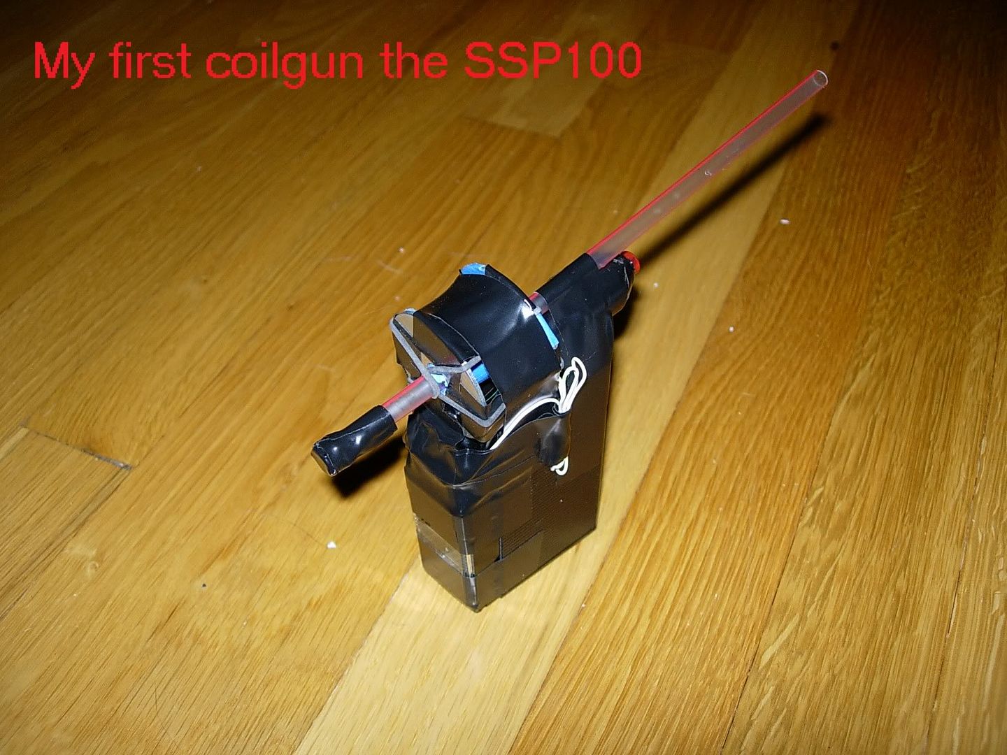

<img src="http://i78.photobucket.com/albums/j85/i ... angle1.jpg">
theres a picture of my first one it shot .177 bbs i used a straw for a barrel. that gun was just a coil taped on the top of an old camera flash with a push button switch trigger.
the multi stage gun im working on now uses optical sensors, there is an ir led and ir phototransitor befor each coil. when the projectile brakes the ir beam the phototransitor activates a scr dumping a 300v 1000uf capacitor into the coil. some people use microcontrolers but that is way more complicated.
