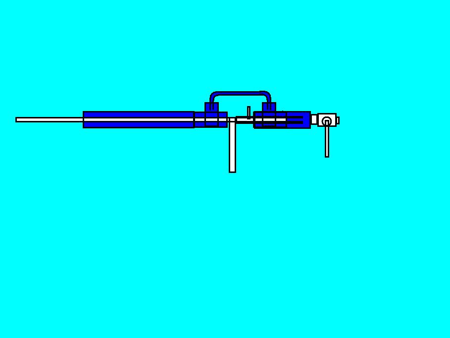

This will be tha basic layout for the gun.

i would do a diaphram or piston coaxial and one of those trigger type blowguns as the pilot
Netherlands
Posts: 3497
You could connect the coaxial forearm to the back like in the picture and connect a spring return ballvalve ( because of the high pressure) to the trigger.
Place the whole thing in a nice wooden mock-up frame and you have your M16.
