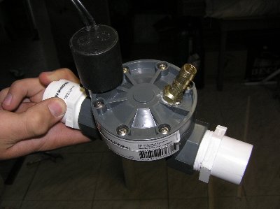

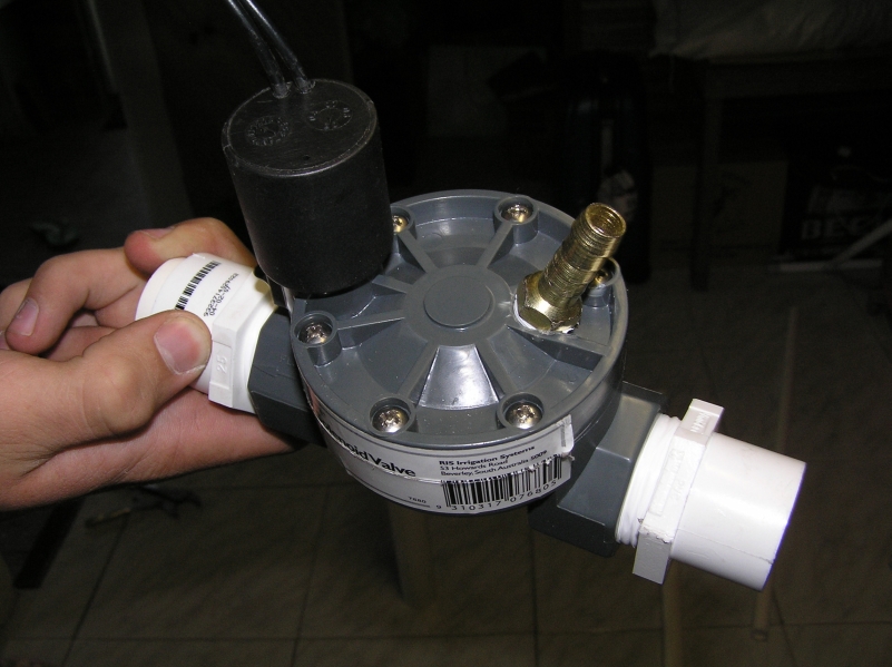

Now your done. here's my finished product.
http://s7.photobucket.com/albums/y298/d ... GP1014.jpg
I hope it comes in handy.

just completed modding identical valve
