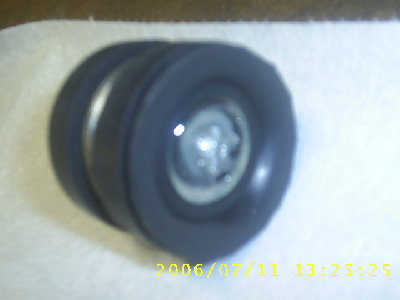

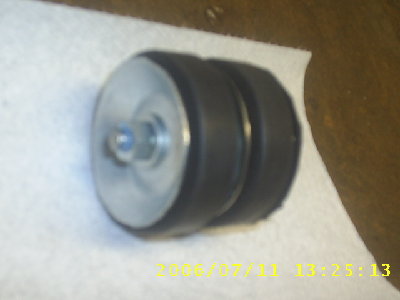

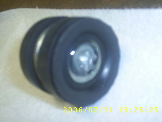

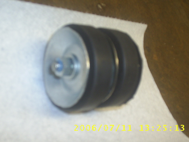

Here is an idea for everyone that I implemented in my latest cannon. You know those test plugs that they sell to compression seal one end of pvc pipe? (theyre made of metal and have an adjuster wing nut). Well I took two of them and trimmed the larger metal ring that keeps it from entering the pvc off on both units. Then I removed one of the carriage bolts and threaded it through the both of them with some washers in between as a spacer. I glued a nice thick gasket on to the end for my barrel seal and adjusted the tension on the bolt to expand it to correct fit. Works great and no lathing/sanding etc to fit. If anyone has done this before I apologize for being un-original
If not hope this helps. I know a picture is worth a thousand words but I'm tired and up too late already. Maybe tomorrow if anyone wants to see.

Ok hope that helps. Let me know what you think. To adjust the fit you just tighten the nut on the end. That expands the two rubber rings. Works for me and there is no trimming/ sanding or other irritating crap.

Markfh11q: They call them "test plugs" at the hardware store. They're pretty common. I have personally seen 2" to 4" and there could be more but thats all that I can attest to having seen on the shelf myself. Yes, they say what size pipe they are for on the top of the plug. You may have to adjust back and forth a little to get the best seal/movement. Mine seal pretty well and still slide easily, but I think that some kind of lube would be a good idea. The only reason that I haven't is bc I'm not sure what kinds of lube eat which kinds of rubber or plastics. I'm not sure what they are made of but it seems like the rubber parts are the same type as most black gaskets for drains and such. Maybe buna-n?. I'm sorry I don't know too much about this area of things. And don't worry about the questions thats what this place should be about right? Oh and the metal parts are some kind of low grade steel I think(they cut pretty easily with a hacksaw/dremel).
