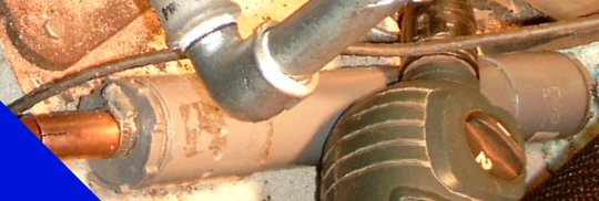

My first spud gun. It is a pneumatic piston gun, with easy changeble barrel (within 10 sec's). The mounted barrel is breech loaded. It uses reloadable shells. It has a chamber of 1" to 50 cm. The pilote valve is triggered by a ball valve. A pistol grip is welded to the lower side, so the ball valve can be pulled open easily. The barrel has a fortification above the breech, looking like the handle of a M16.
Due to the fact I have a compressor with a max of 7 bar (100 psi), I just shot the gun several times of a thin wooden plate. The marbles went trough. That was a nice feeling :wink: (youi know what I am talking about.)

Changeble barrel pic :
[albumimg]225[/albumimg]

I guess, not that I have been shoting it, that the space between the piston valve and the place where the ammo sits in the barrel is to big. I guess the ammo should be right next to the valve. Now a lot of pressure is getting lost in the "unused part" of the barrel, behind the breech. :cry:
The gun shoort nicely, but not very powerfull. In a straight shot, holdting the gun at 1.5 m from the ground horizontly, is "only" covers 50 yards without hitting the ground. I think that is very poor. It should at lease cover 100 yards horizontly.
Now, I just have a pressure of 7 bar max (100 psi). A gavla chamber with copper parts should at least hold 200 psi, isn't it ? Guess I have to buy me a high pressure foot pump or something.
Oh, and something else I found out. There is no or little point to use a silencer, if you don't silence the exhaust of the pilote valve as well, that gives a pretty loud bang to.

You should maybe try compacting the elbow assembly to reduce dead volume.
