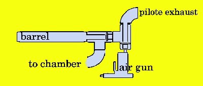

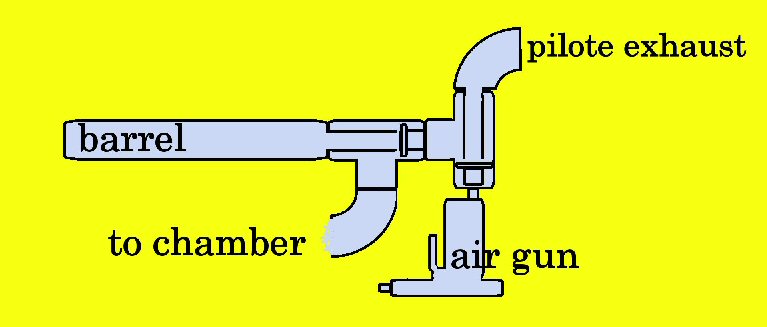

since I dotn have acces to sprinker valves, what is the best way and of course, the quickest way, to depressurise the pilote chamber of a piston valve ?
I was thinking using a second piston volve to do so.
Like so :
Quickest way to depressurise a pilote chamber

Not good enough. Blowguns make horrible pilot valves for your average barrel sealing piston.
Your idea would work, you would just need to make a small enough piston valve to where the blowgun would pilot it.

Ball valve with a spring,crude and works well.Nearly impossible to break aswell.
I used just a blowgun, but that wouldn't work. It depressurises the chamber as well. Then , the piston wasn't good enough to, but the blowgun has a small hole. Maybe that's why it didn't work.
Ballvalve works good, but it isn't handy. I want something estetic to, and a ballvalve is everything, but estetic

Hmmm so true,maybe get a QEV and use that to pilot it but that is if you are willing to buy a QEV just for that job.But usually i would rather go peformace over looks because simply i like my guns to work..lol..

Did you try taking the nozzle off the blowgun? I heard that helps. You could also use a diaphragm valve to empty the pilot chamber, I heard they open faster than piston valves and are easier to make.

@ rna_duelers : yas, working is more important than looks, but I dont think a ball valve is very good. I dont have much experience with blowguns, but it seems so, that the gun loses (to) much pressure due to the ball valve. To slow in opening the pilot chamber.
Well, maybe with a spring, guess I'll try that one out.
Edit : ok, ik found out what a diaphragma valve is. Seems easy to make, just have to find the right material of melt some rubber and make one thick enough. I think I am gonne try the last one tomorrow

Well if there is to much air comming out from the exhaust port then maybe you should look at your piston design so it doesnt let so much air past and out the exhaust from the actual chamber.

I changed the piston now. When I shoot the gun, the piston closes the pilot chamber. No more airlossrna_duelers wrote:Well if there is to much air comming out from the exhaust port then maybe you should look at your piston design so it doesnt let so much air past and out the exhaust from the actual chamber.
