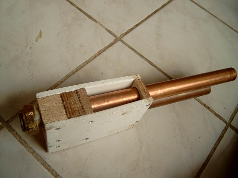

I always wanted to make a reloading system with the magtube under the barrel like pump-action shotguns have, or winchesters.
I based this design on a "falling block"pistol replica I once had.
That design was the predesessor to the "Vulcan" pistol that inspired the winchester rifle.
Instead of just the usual falling block that just opens the breech I gave the block an opening to pick up ammo from the mag tube under the barrel.
It's simply an elevator that drops down, ammo rols in from the mag tube, the elevator moves back up and lines up the ammo with the barrel.
Well the pics should explain.
I put the parts in the vice to squeeze them tightly onto each other to get an airtight seal.
It's airtight when I blow on it, but the block can still move.
It's possible to use this system to load spuds using the block as the mag as well.Just make a longer block with more holes containing the spuds and move it in by hand.
How-to Winchester-lever action reloader.
- Brian the brain
- Posts: 3497
- Location: Holland
- Been thanked: 7 times

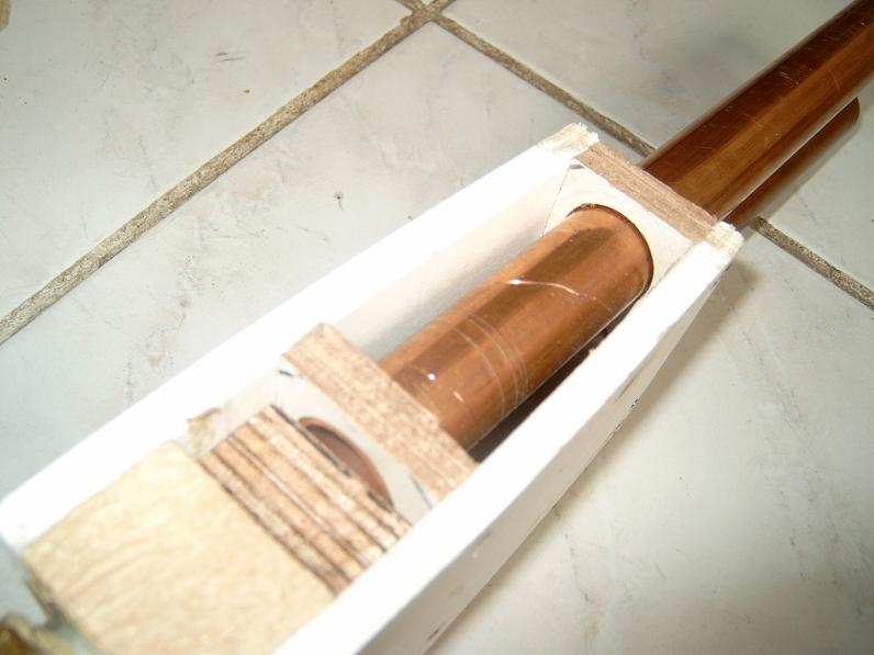

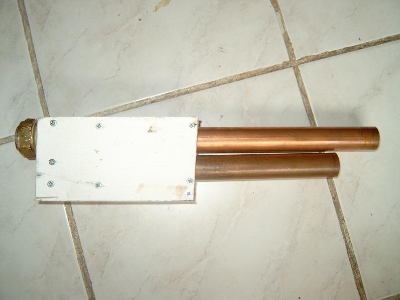

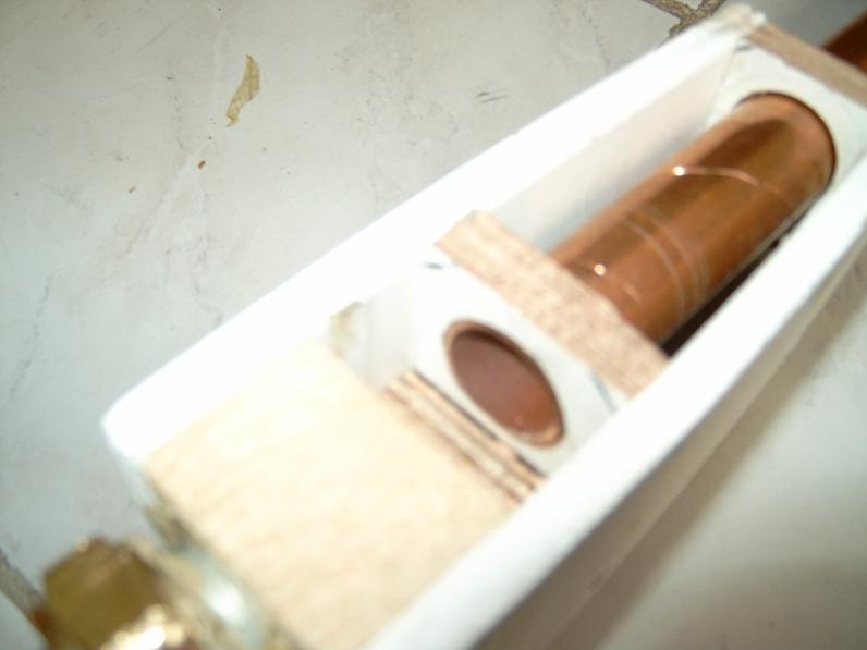

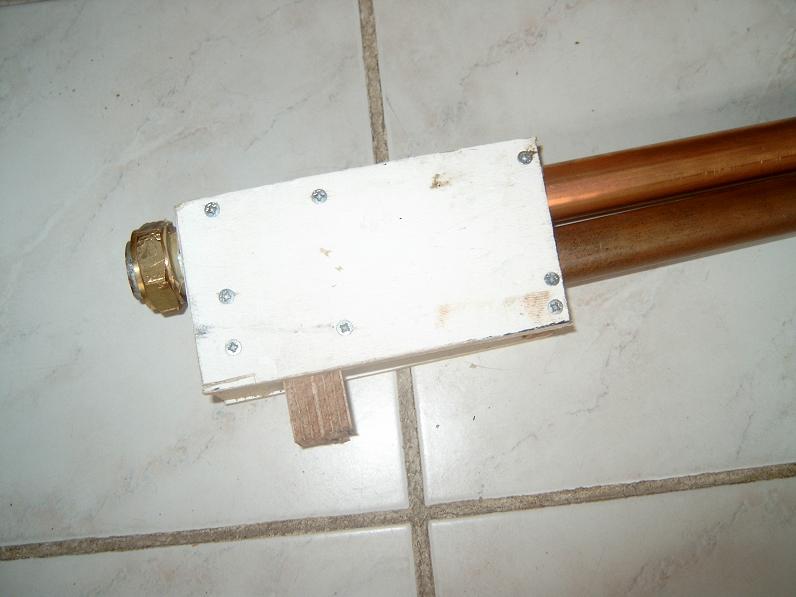

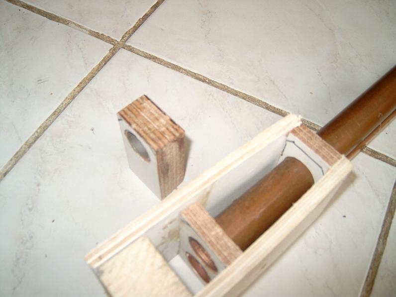

- Here you see the components.
Both barrel and mag tube have acces to the falling block.
Tools needed were a hole cutter, a saw, a vice and a screw driver.
The falling block has just one hole.
No lever is attached, nore will I, since this assembly is too crude.Just a test.
Mag should be fitted with a spring and loading port.
