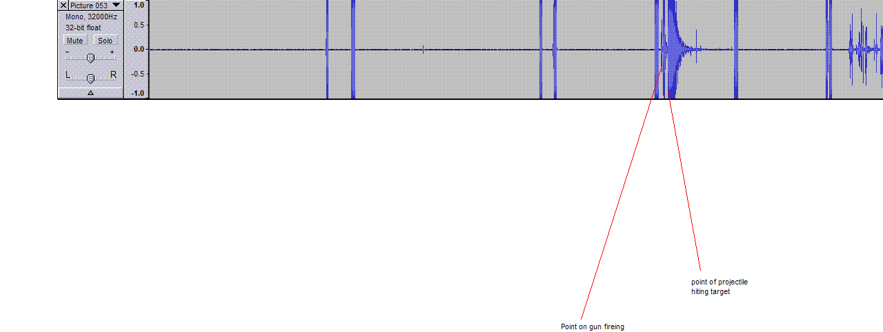

I recently went to a site that showed how you could figure fps with 2 peices of paper and 2 microphones well i didnt have a microphone so i can up with this im not 100% sure how acurate it is but i should give you a rough number.
Ok if you dont have a microphone recored you shooting something like a peice of wood from a number of feet back like 10' should be good now put the video on your computer and download Audacity just google search for it its free now open the video in Audacity and it should show you the sound pattern.
Now play it and stop at the point you hear your gun fire.
Once you have stopped at the point your gun fired zoom in on it and find how many milliseconds it took for the projectile to hit the target.
You should get something like 33 milliseconds (.033 seconds; devide milliseconds by 1000 to get seconds) but it all depends on your gun.
ok now for the easy math (Feet Divided by seconds Equals Ft/s)
so it would be 10/.033=303.03030... wich rounds to 303 feet per second.
if you shot from five feet you would do 5/.033 and so on.
Sorry i couldnt get to many pictures but its pretty easy to understand if you need any help post here or pm me.
P.S. If Audacity opens the video file but the sound is a fcked up youl have to find a way to rip the sound from the video, but my cameras videos came out as MPEG's and it opened them fine.

well at 10 feet it takes only milliseconds to hit a target...your friend better have some damn good reflexes lol but anyway this does work very well my bb gun shoots around 700 fps i knew that already i tyried using my method and got exactly 689.3 fps =p

Anyway, something the OP didn't point out: you have to adjust for the time it takes the sound of the projectile impact to travel back to you.
This will either involve trig', a tape-measure, or merely placing the recording device 1/2 way between the target and the muzzle.
