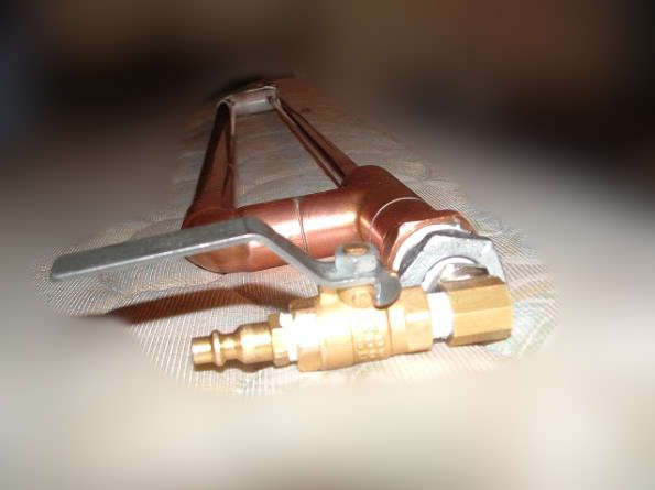

The money shot...

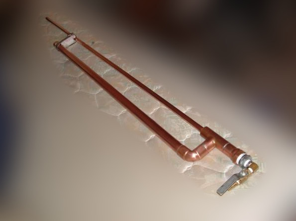

An overview of the launcher

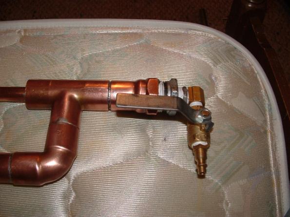

A view of the pilot and fill assembly

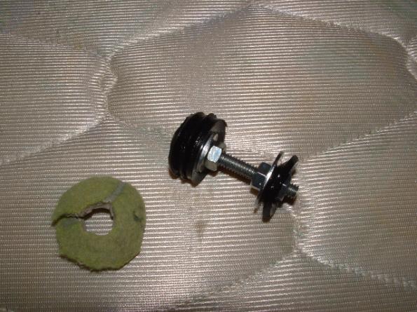

A view of the piston and the bumper

What sort of pressure are you operating it at? I dont see a schrader valve anywhere. I take it you're charging it via the ball valve?

I usually charge er to around 120 PSIG through the male quick-disconnect on the ball valve, yes.

Hi i want to know if you could tell me what that pison is made of (the rubber?)

Im guessing that it is some type of neopreme. You can use stuff that you find like i do. I took some rubber of a toy and used that as a sealing face.
